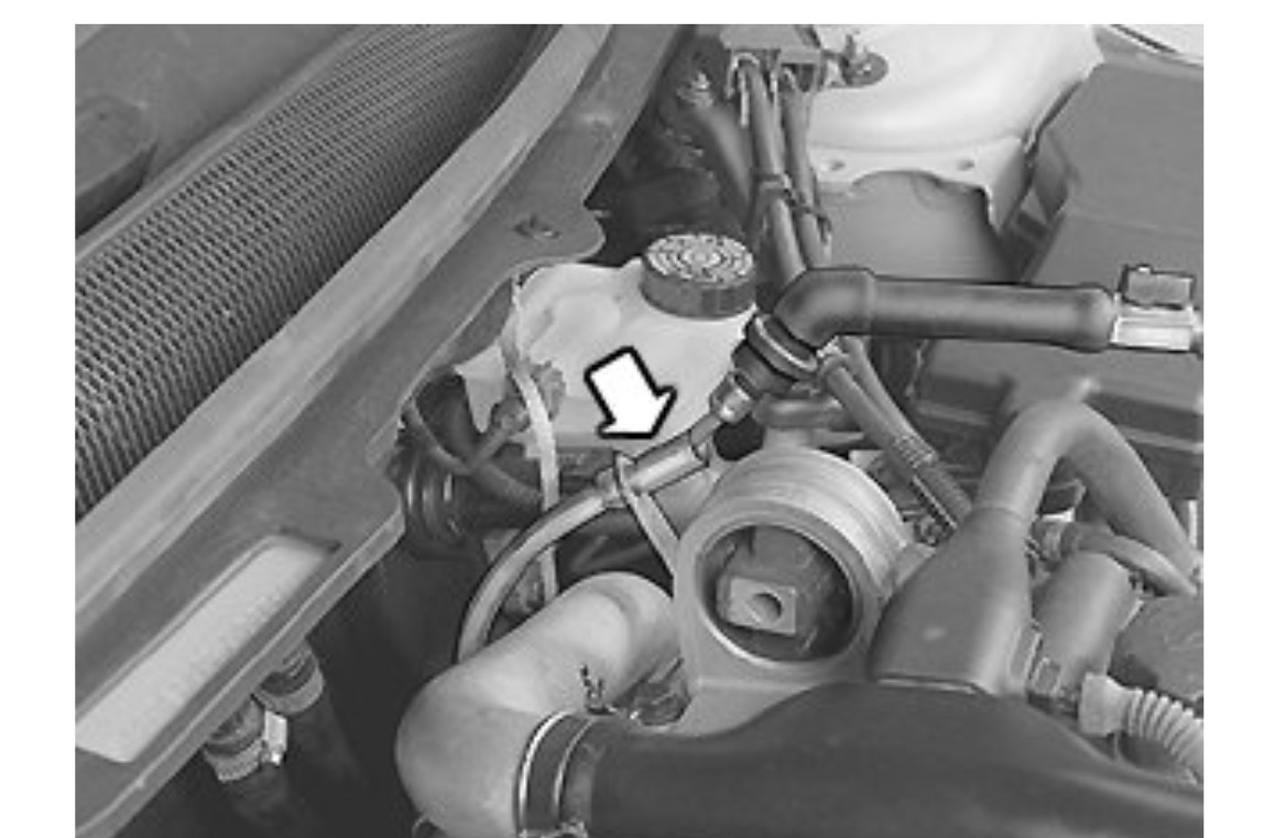

Good morning,
The first thing I would do is check the fluid level to be sure it is not low not allowing the transmission to work.
Run the engine until it is warm, then check the fluid. If the level is okay, I would change the fluid and filter to see if the filter is clogged.
If that does not work, then it is internal in the transmission.
