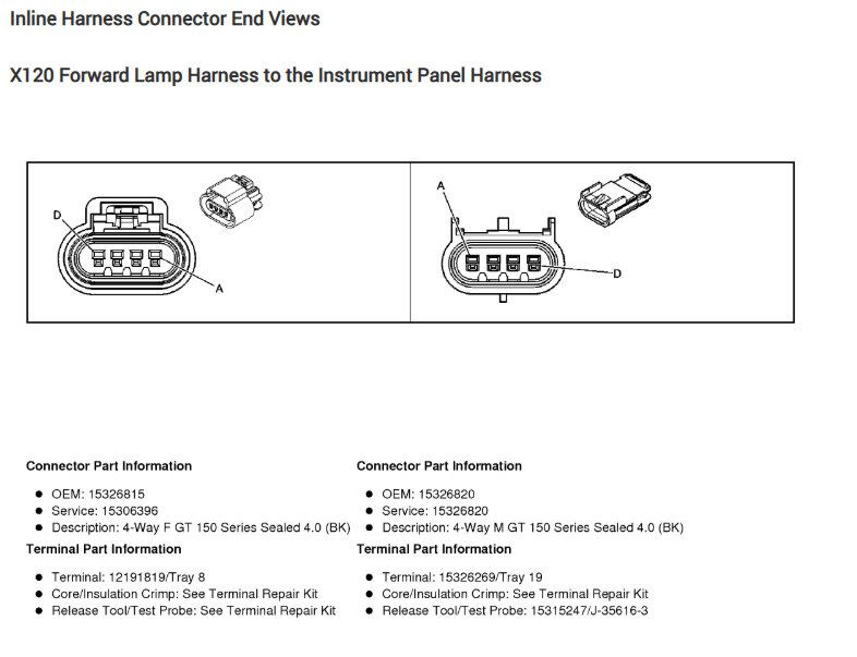

X120 Forward Lamp Harness to the Instrument Panel Harness.
I recently replaced the power steering pump. Back together. However, the X120 connector is not connected; it is under the engine fuse box.
Where is its mating connector?
I can't seem to find it.
It should have the same 4 wire colors: green, green with black, tan and yellow, right?

They don't give us the location of the connectors but it's got to be there near the other end. Use a flashlight to see if you can find it, it may have gotten pinched under a backet when you were putting the van back together. Check out the images (below).
