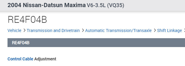

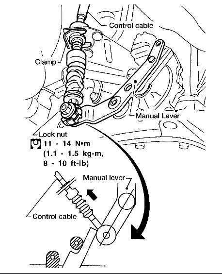

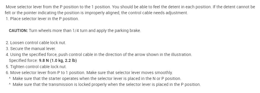

Based on your description, it sounds like an adjustment issue. Does it do this with all gear selections?
Here is what I would recommend: Check the shift cable adjustment. I would go through the procedure for proper adjustment to see if it takes care of the problem.
If you look below, I attached the directions for adjustment. Take a look through them and let me know if you are comfortable performing them or if you have other questions.
