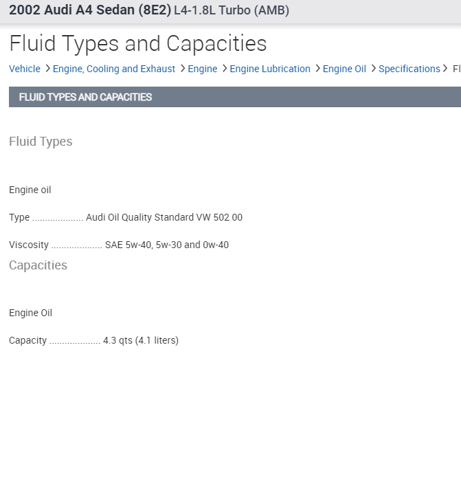

Hi, the previous mechanic did the oil change with 10w40 in the engine where it was supposed to be 5w30LL. After 13,000km I changed the oils again back to 5w30. Was any damage caused because of the 10w40? Was it a good idea to go back to 5w30?

As long as the 10W-40 was a good quality oil, it is unlikely to cause any damage to the engine.
Audi actually recommends 5w-40, 5w-30 and 0w-40. So 10w-40 is not a huge change.
Many people like to use the thicker viscosity oil when the vehicle goes over certain mileage.
So just the oil viscosity shouldn't be any reason for concern.
