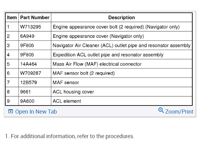

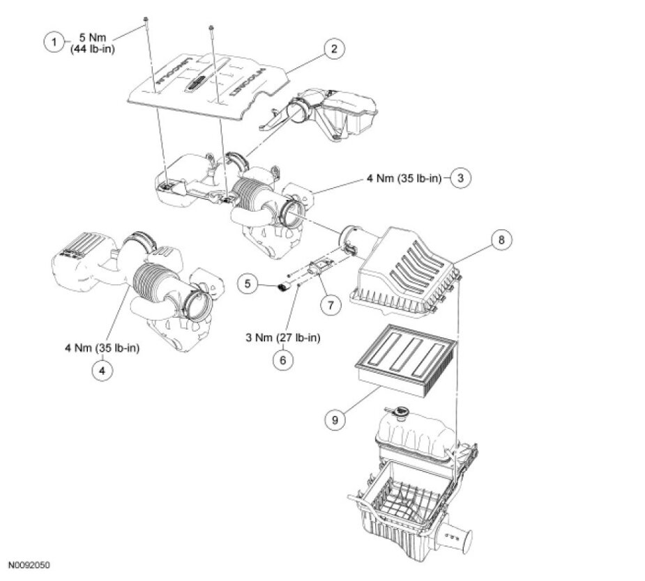

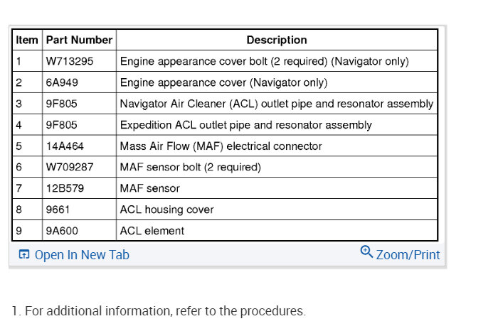

I went through some water and now my truck is idling, and it shut off, but it started back up. I’m trying rule out the damage.
Mar 25, 2023 at 5:49 AM
  • 55,819 POSTS
it sounds like you have gotten the air filter wet so I would check that first, here is the location in the images below. Next, I would run the codes to see what comes up.
Here is a guide to help you with that:
