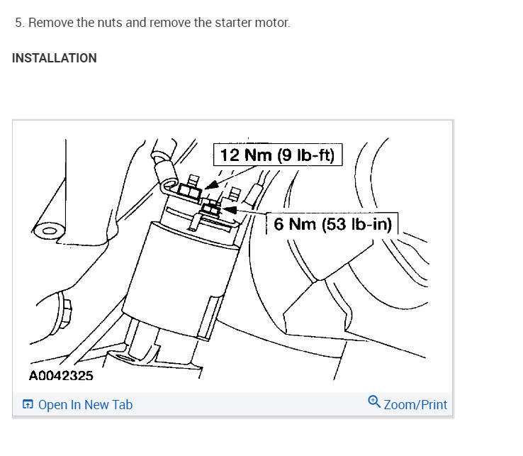

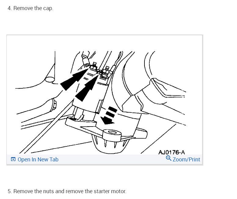

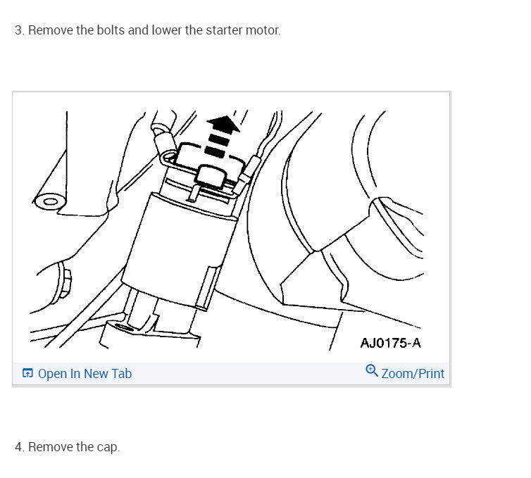

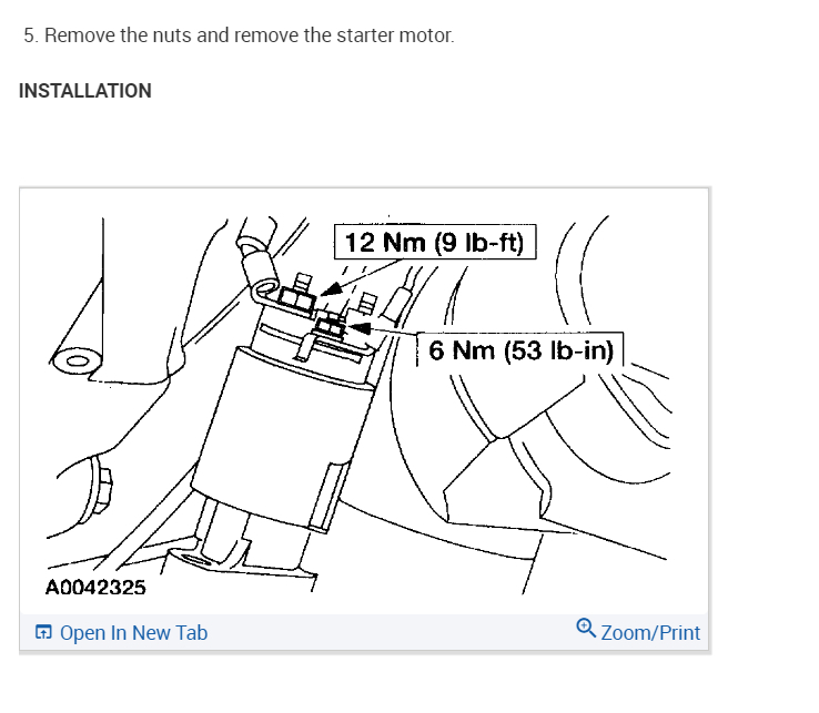

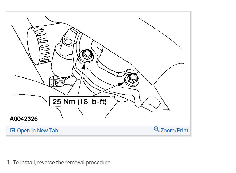

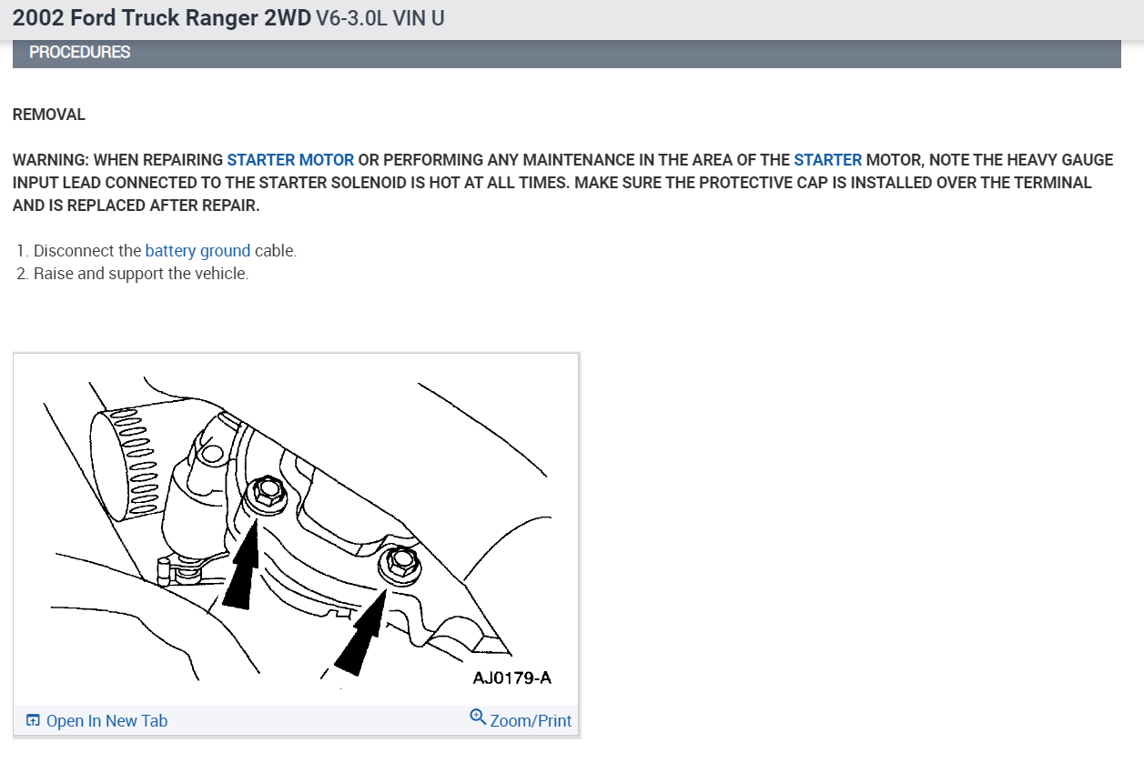

What wrenches do I need to change the starter on my truck listed above 2-wheel drive XLT 3.0 flex fuel?
Sep 30, 2022 at 6:06 PM
  • 55,433 POSTS
Nice doggy :) I would use a 13mm socket and 5/8 socket and an 8mm socket for the starter solenoid. Here are the instructions in the diagrams below. Check out the images (below). Please let us know if you need anything else to get the problem fixed.
