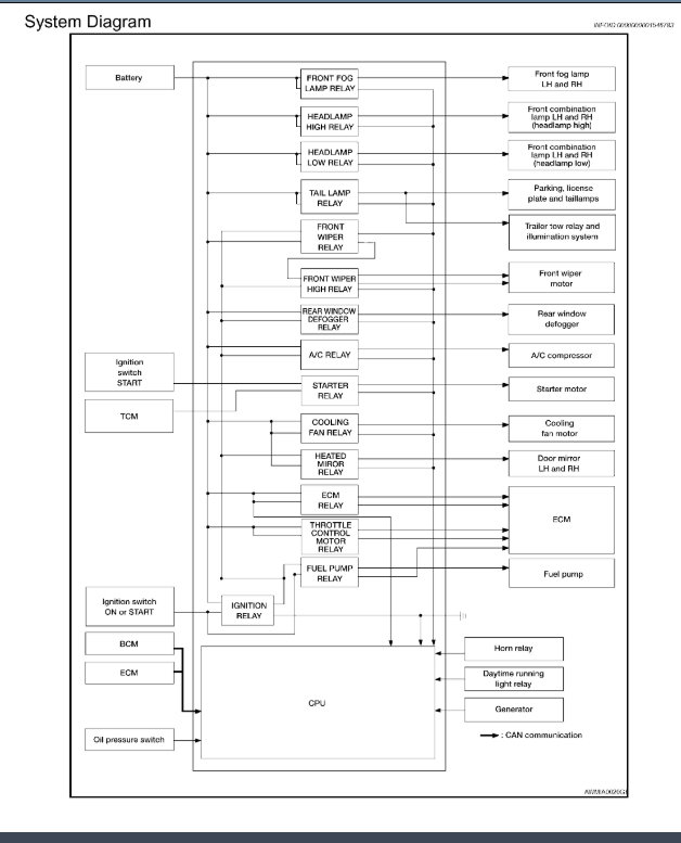

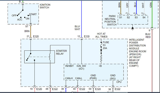

Anyway, the starter shouldn't turn itself off like it's doing. That's the bad new. The worse news is I feel there is a problem with a component called the integrated power distribution module (IPDM). The IPDM contains both a starter relay as well as a starter inhibitor. The purpose of the inhibitor is to prevent the starter from running after the engine starts. Now, without extensive testing, I can't tell you if the relay or the inhibitor is bad. However, neither one is serviceable on this vehicle.

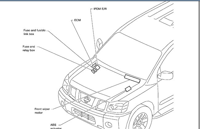

If you take a look at the wiring schematic below, it shows specifically what I am referring to. If you look at pic 2, it shows all the different things the IPDM controls. Pic 3 shows the location.
The part isn't cheap and I wouldn't want to recommend you replace it without being 100% sure. If you could let me know how confident you are with diagnosing electronics, I will try my best from here to guide you. Also, and as just a simple test, see if it does the same thing if the transmission is in neutral. Believe it or not, the relay is initially actuated via the transmission control module (TCM). It's really a long shot, but won't hurt to try.

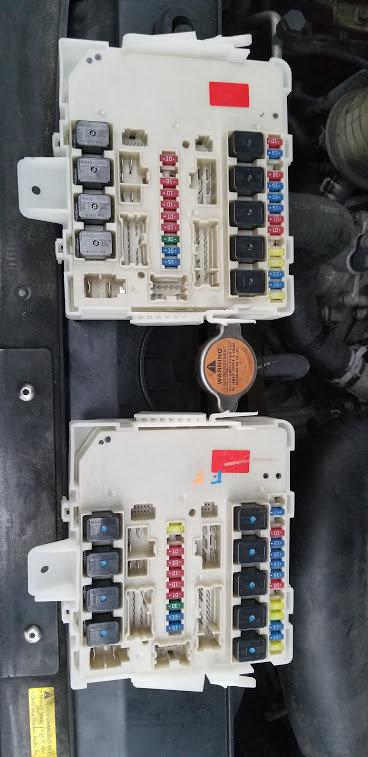

CHRIS RABKIN
  • 8 POSTS
Okay, so I did the following today- 1 with the original IPDM installed. I put the Armada in neutral and attempted to start. Still get the short start.
Removed the original IPDM and swapped with the refurbished one - no crank at all. Put in Neutral, same - no crank at all.
So were back to where we started with the original IPDM module installed I included pics of the pulled original IPDM and the second hand one.
Here is another video from today with the truck in neutral and original IPDM installed:
https://photos.app.goo.gl/gk7JZV6UXEWzEPd4A
In the photo - the IPDM with the Blue Dots on the Modules is the "refurbished" one. The fuses don't exactly match up,but they are on the positive side (meaning some 10amp fuses are replaced with 15 or 20 amp ones) I don't think going up on the amps would cause it to not function at all. The plan was to install, get to crank and replace all the fuses with correct volt new ones.
