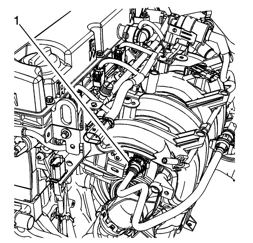

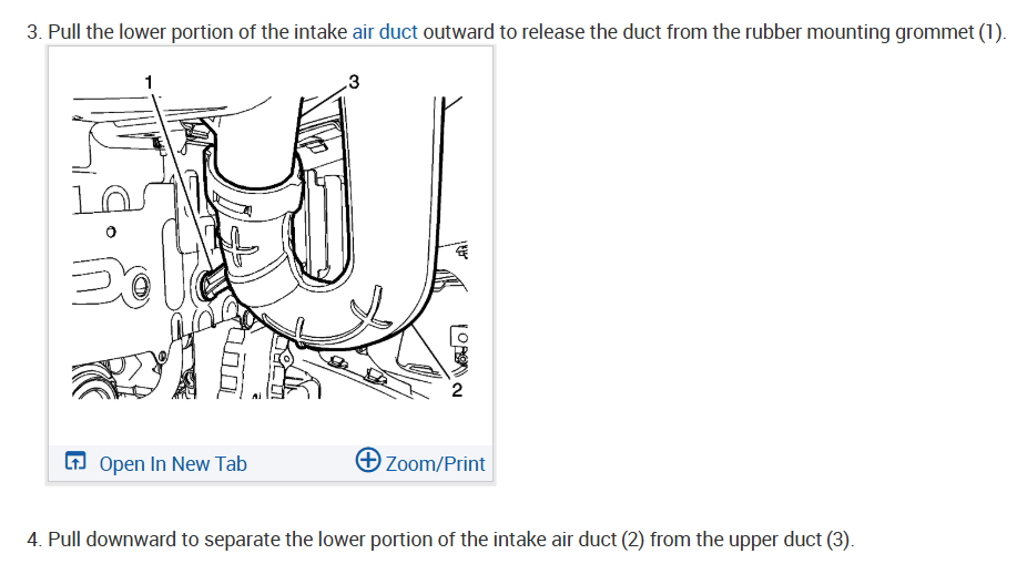

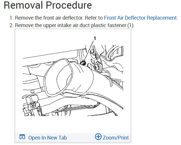

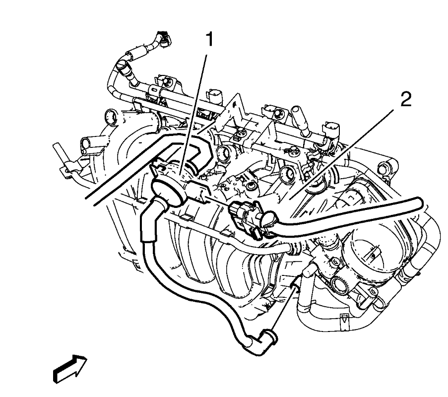

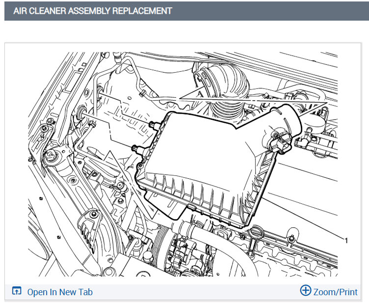

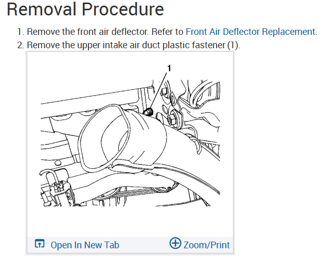

Would it be possible to get some diagrams of the air systems hoses and intake? also, coolant system and hopefully the front steering set up / sway bar, CV joint etc.

These need to be separate, we only handle one request at a time. Here are the diagrams for the air intake hoses and tubes. Check out the images (below). Let us know if you need anything else.
