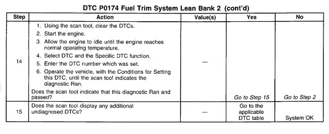

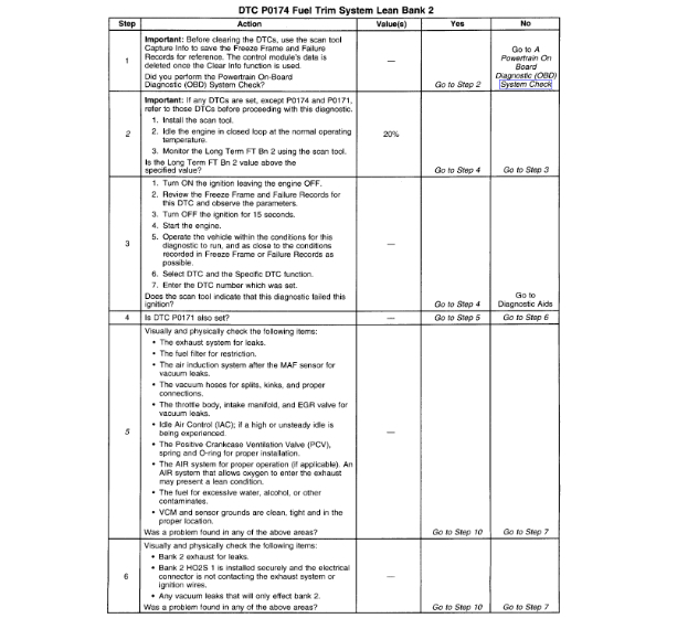

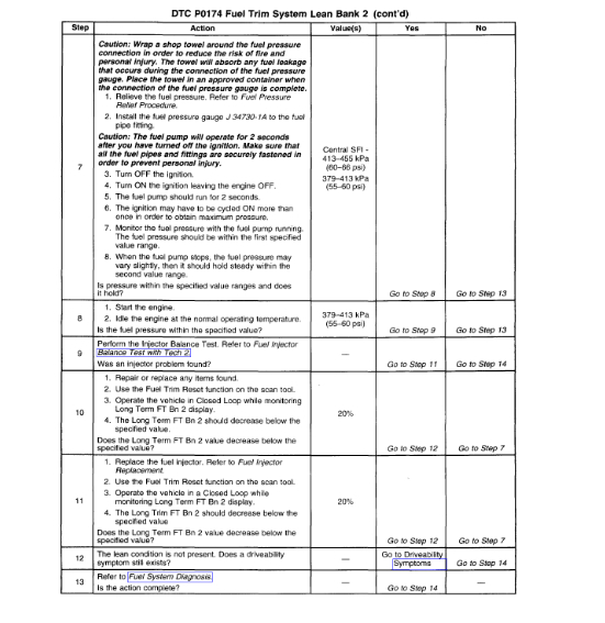

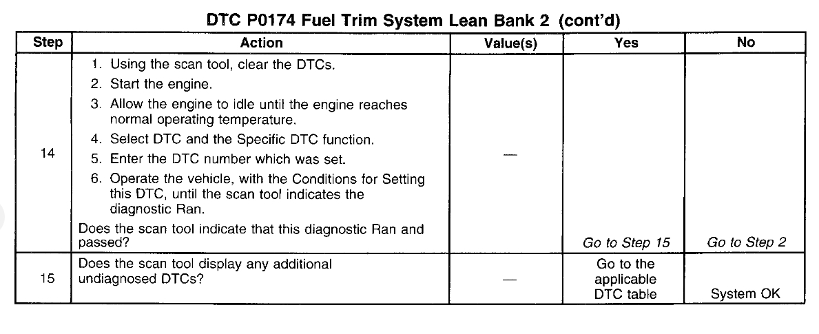

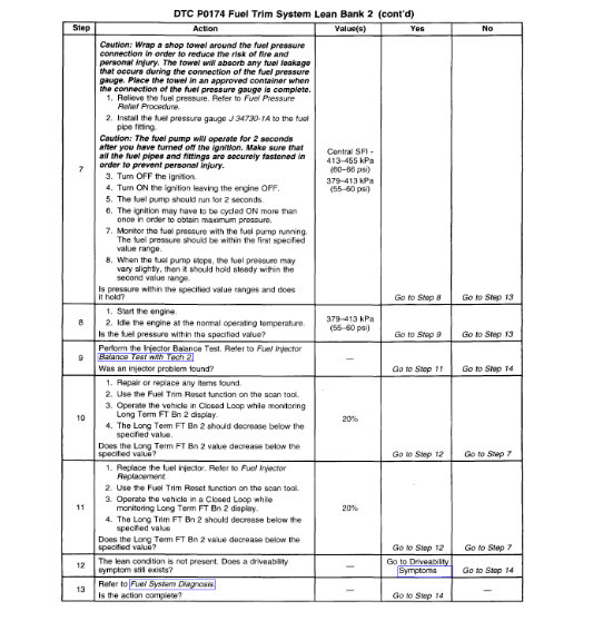

Hello Roy,
Same 1999 Tahoe problems. We put a temperature sensor and a new thermostat in then drove it for awhile and a new code came up and it is running rough again. Code P0174 Any suggestions for that one?
Monday, December 10th, 2018 AT 12:54 PM
  • 52,797 POSTS
174 is a lean code for bank 2. That is the passenger side of the motor.
I would look for any vacuum leaks, possible bad injector or low fuel pressure.
You will need this resolves as well as the catalytic converter.

If using the diagnostic tables does not isolate the problem, try monitoring the LT fuel trim and fuel trim cell while operating the vehicle under various loads. This may isolate the condition which caused the setting of the current DTC.
A condition that causes the DTC P0300 Engine Misfire Detected may also set the current DTC; conversely an extremely lean condition which sets the current DTC can cause a misfire at idle and the DTC P0300 to set. If the cause of the current DTC cannot be determined and the DTC P0300 is also set, refer to DTC P0300 Engine Misfire Detected. See: A L L Diagnostic Trouble Codes ( DTC ) > P Code Charts > P0300
Typical Fuel Trim Values
The Fuel Trim Values table indicates the typical fuel adjustment values as displayed on a scan tool. Negative values (Rich condition) indicate that the injector pulse width is being decreased in order to lean out the fuel mixture. Positive values (Lean condition) indicate that the injector pulse width is being increased in order to richen the fuel mixture.
Test Description
The numbers below refer to step numbers on the diagnostic table.
2. A more negative value indicates the VCM is leaning the fuel mixture (Rich condition), and a more positive value indicates the VCM is richening the fuel mixture (Lean condition).
5. Visually and physically check the items that can cause a lean condition in order to determine the cause of the DTC being set.
