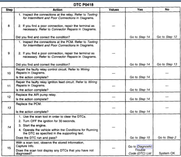

Code P0418
2001 CHEVROLET TAHOE
78,000 MILES • 5.8L • V6 • 4WD
898ROSE

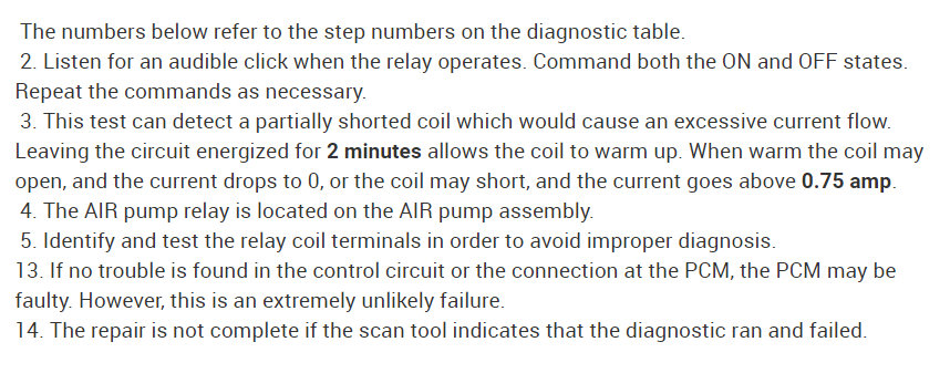

How to find out what it is i am needing to repair?
May 25, 2017 at 10:18 PM
DANNY L
  • 5,648 POSTS
Hello, I'm Danny.

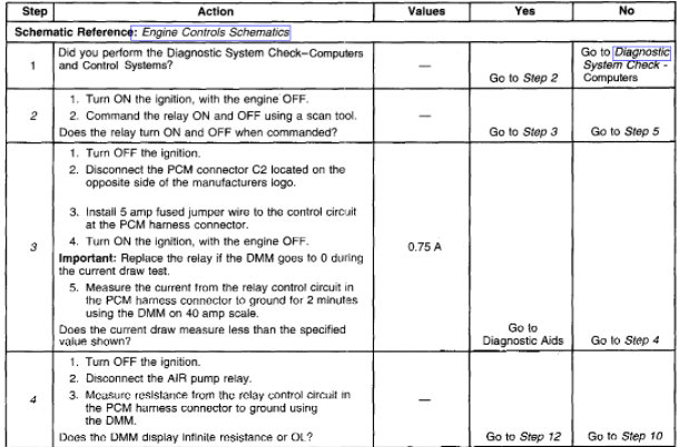

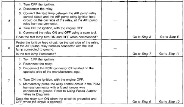

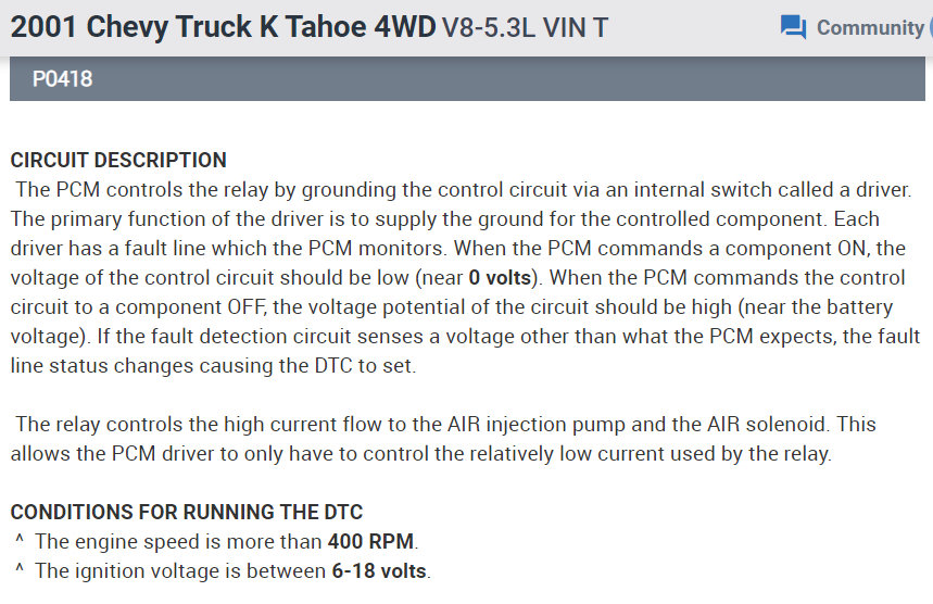

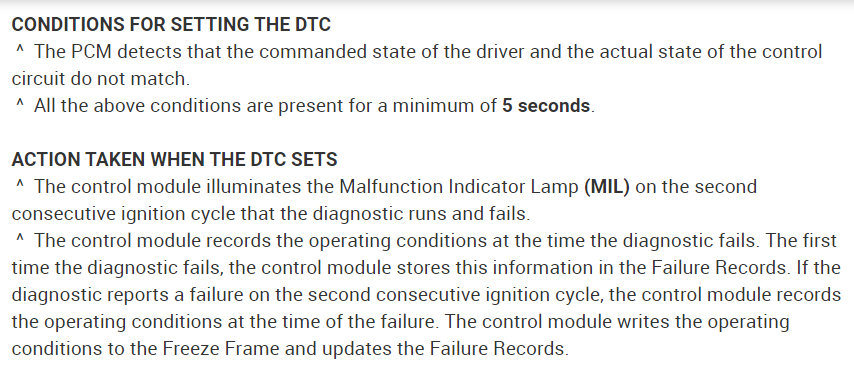

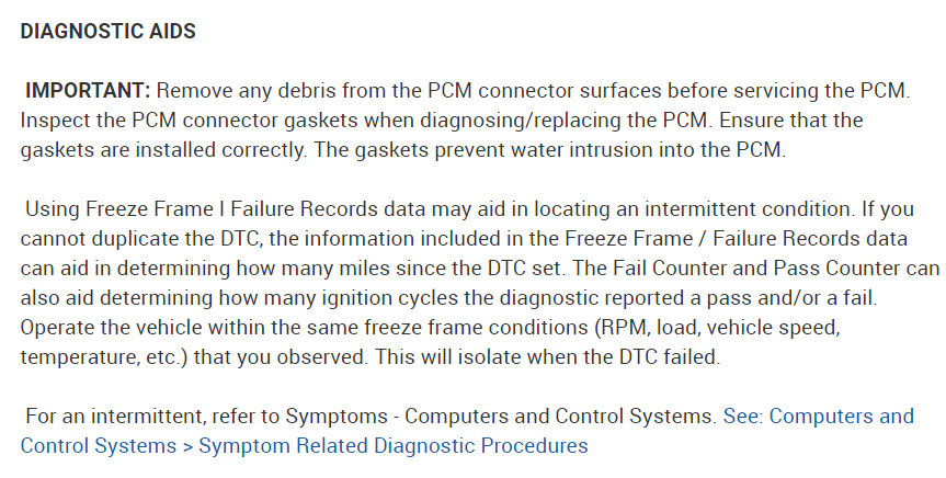

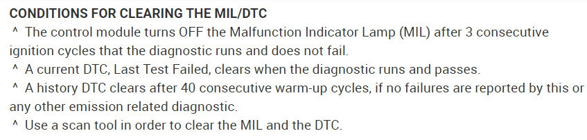

Here are two tutorials showing how to test electrical circuits relating to this code:
I've attached picture diagnostics steps below relating to code P0418 on your vehicle. Hope this helps and thanks for using 2CarPros.
