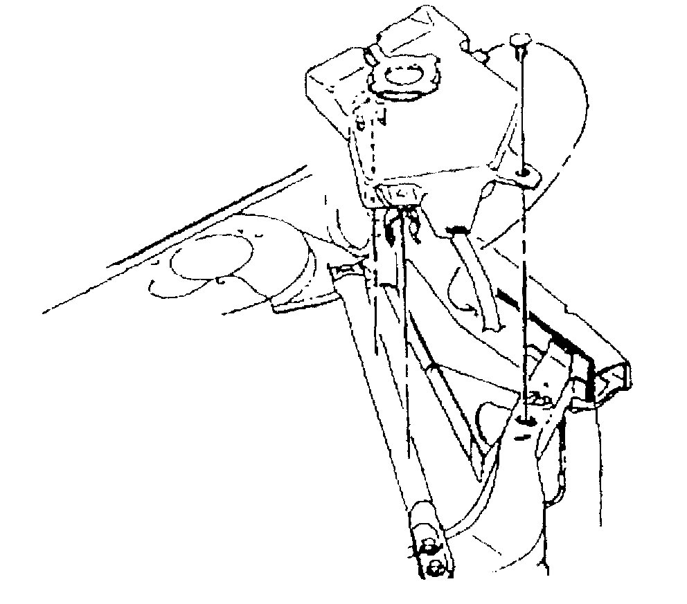

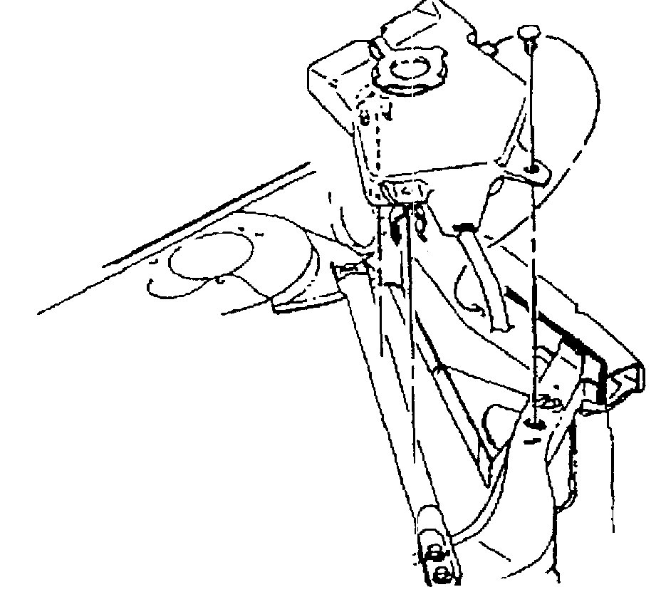

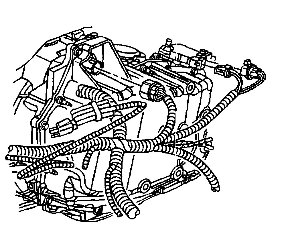

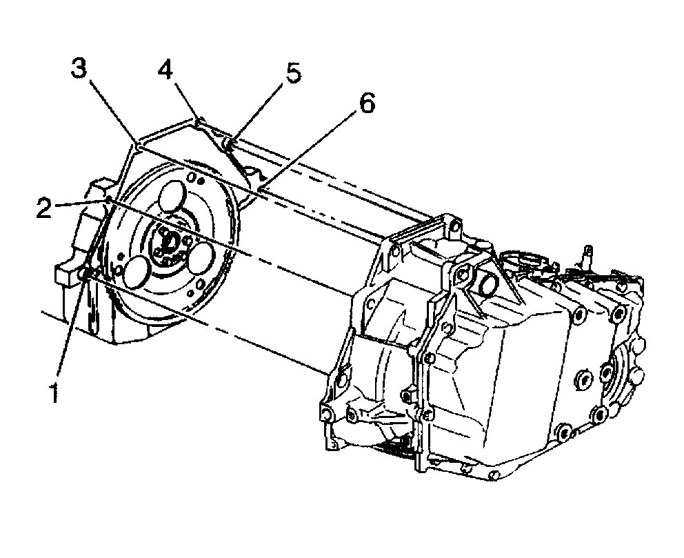

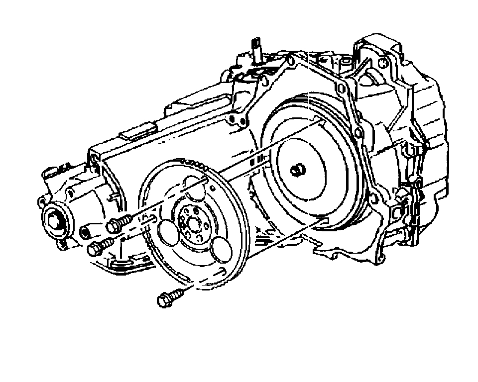

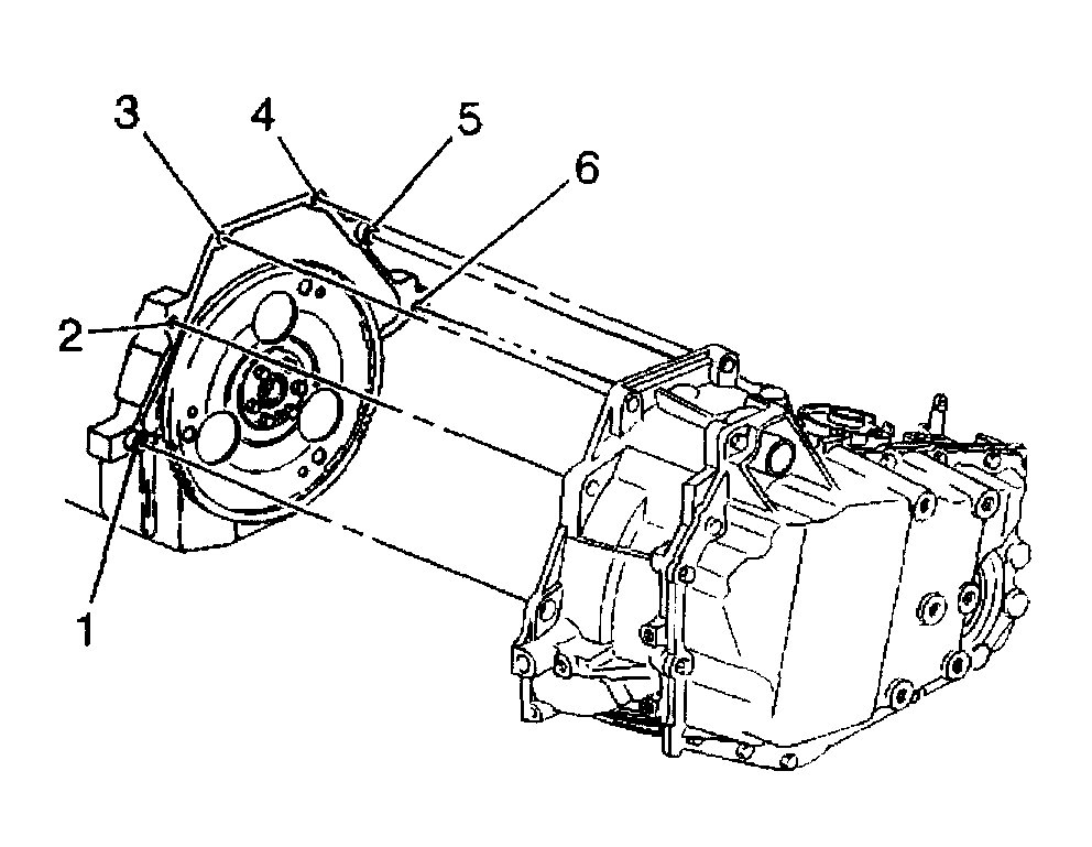

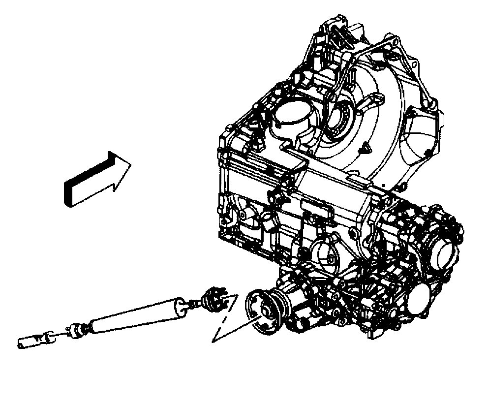

Here are the directions for removal and replacement. The attached pics correlate with these directions.
____________________________________________
2003 Buick Truck Rendezvous V6-3.4L VIN E
Transmission Replacement
Vehicle Transmission and Drivetrain Automatic Transmission/Transaxle Service and Repair Removal and Replacement 4T60-E/4T65-E Automatic Transaxle Transmission Replacement
TRANSMISSION REPLACEMENT
Tools Required
^ J35944-A Transmission Oil Cooler Flusher
Removal Procedure
Important: Transmission oil circulates between the transmission assembly and the transfer case. In situations where transmission related failures circulate debris into the transfer case. the transfer case must be disassembled, cleaned, and inspected for damage.
pic 1
1. Remove the push pins from the coolant recovery bottle.
2. Position aside the coolant recovery bottle.
3. Remove the air cleaner.
4. Remove the automatic transmission range selector cable from the automatic transmission range selector cable lever.
5. Remove the automatic transmission range selector cable bracket.

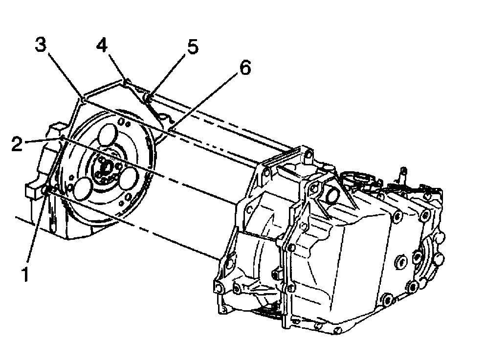

pic 2
6. Disconnect the wiring harness connectors from the transaxle.
7. Remove the wiring harness from the transaxle.
8. Remove the right side engine strut.
9. Install the engine support fixture.
10. Raise the vehicle. Refer to Vehicle Lifting.

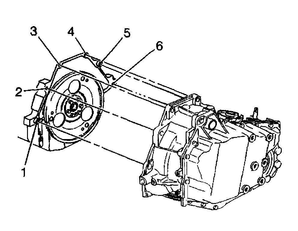

pic 3
11. Remove the top four bell housing bolts (2, 3, 4, 5).

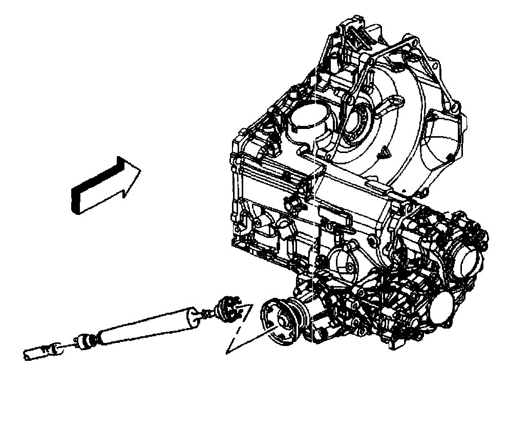

pic 4
12. If the vehicle is equipped with All-Wheel-Drive (AWD), perform the following steps:
12.1. Remove the propeller shaft.
12.2. Remove the transfer case brace.
13. Remove the frame.

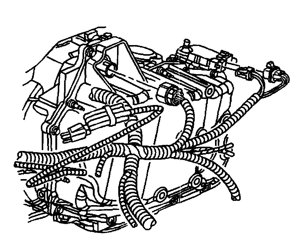

pic 5
14. Remove the filler tube.
15. Remove the torque converter cover.
16. Remove the torque converter bolts.
17. Disconnect the vehicle speed sensor electrical connector.
18. Remove the right and left drive axles from the transaxle.
19. Disconnect the transmission cooler hoses from the transaxle.
20. Position the transmission jack under the transaxle.
21. Remove the transaxle / transfer case brace.

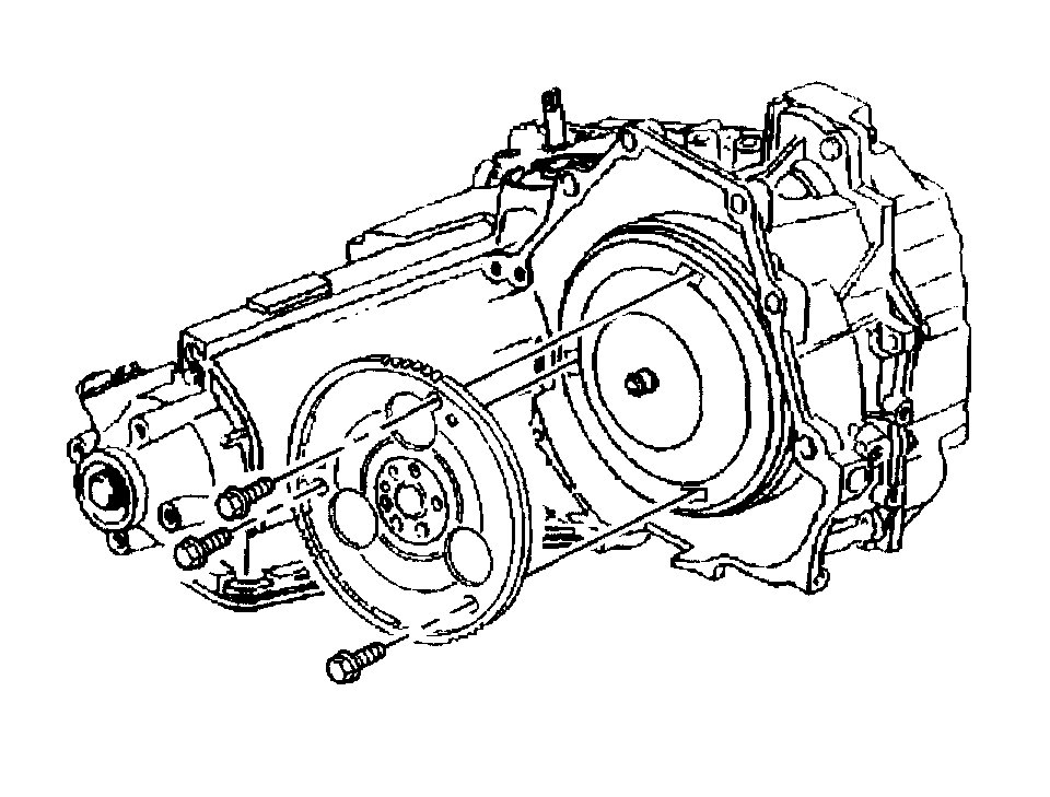

pic 6
22. Remove the lower transaxle bolts (6) and stud (1).
23. Remove the transaxle from the vehicle.
24. Use the of 35944-A or equivalent to flush the transaxle oil cooler and the transaxle of cooler hoses.
25. If the vehicle is equipped with AWD, remove the transfer case.
