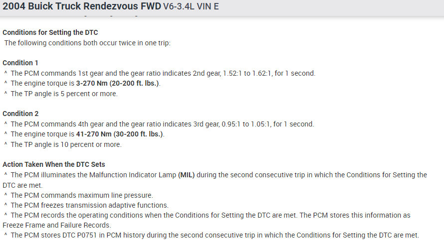

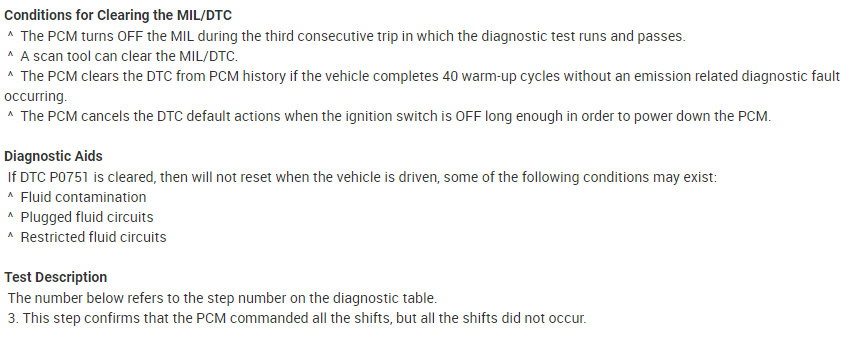

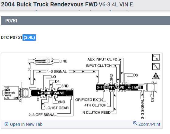

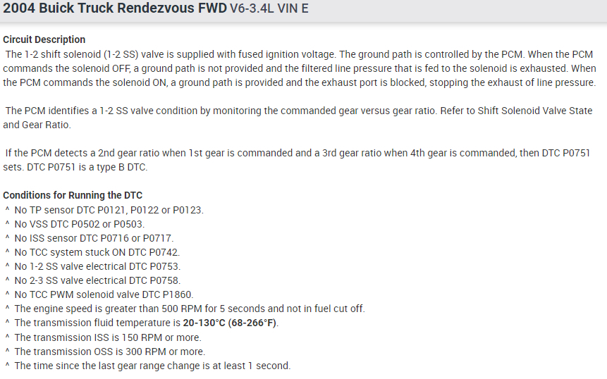

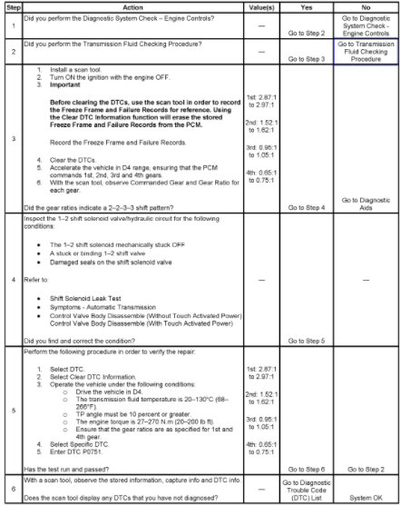

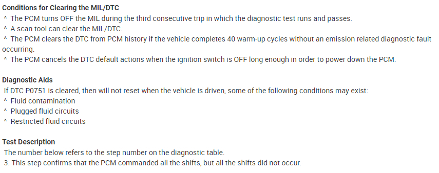

Transmission code po751. anything shy of replacement to fix this is intermittent? How do I test this? Thank you
Apr 8, 2017 at 6:12 PM
SQM
Experienced Mechanic
6,383 POSTS
I have attached the complete diagnostics for that transmission code P0751.
