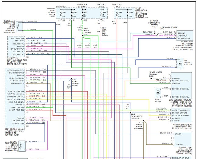

Would like diagrams Auto Temp Control?
1999 CHRYSLER LHS
200,000 MILES • 3.5L • V6 • 2WD • AUTOMATIC

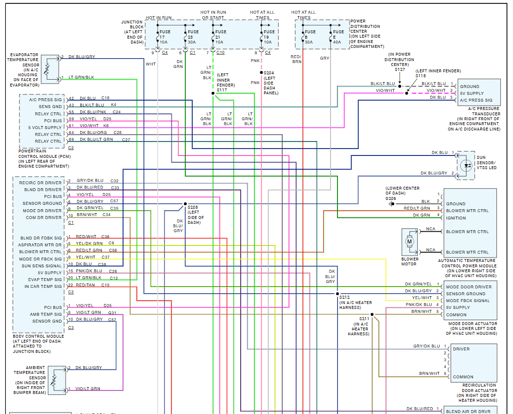

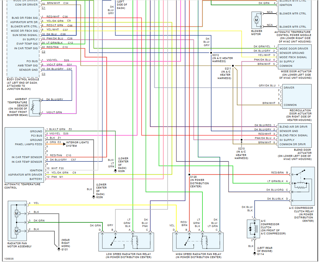

Hello Kevin, here is the HVAC wiring diagrams and a guide to help with the testing:
Check out the images (below). Let us know if you need anything else.

Hi Ken L, The wire diagrams are very helpful, thanks! Looking for info specific to the pcb components, aspirator motor and the rest. Need to troubleshoot what fails. Don't believe its a BCM issue. ATC has no relay. Rabbit hole...I know. If you can help, great, if not, that if fine, also.
Dec 3, 2025 at 12:41 AM
  • 55,433 POSTS
Sure, I will help you, the first thing I would do is a CAN scan to see what codes are stored, please go over this video which should help us retrieve the codes.
CAN SCAN - https://youtu.be/u-4syLc-ifQ
Let us know how it goes.
