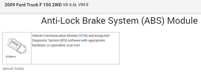

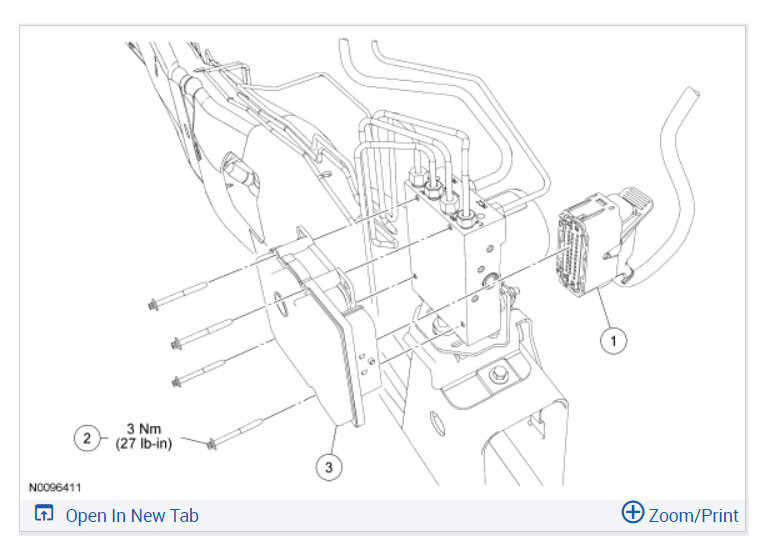

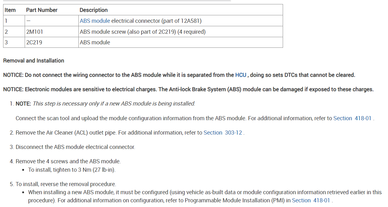

That is up to you, look a the truck and what it would mean to you if you didn't have it, here is how to change the ABS module out so you can see what needs to be done. Check out the images (below). Let us know if you need anything else.
