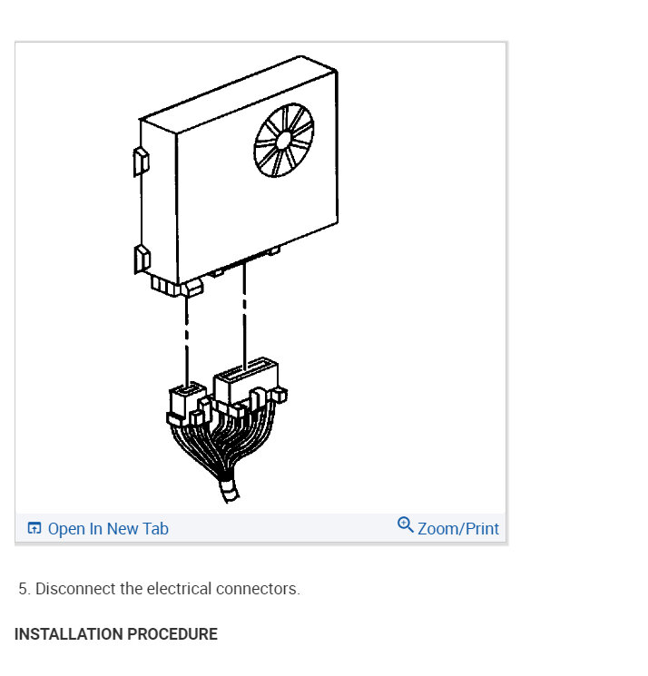

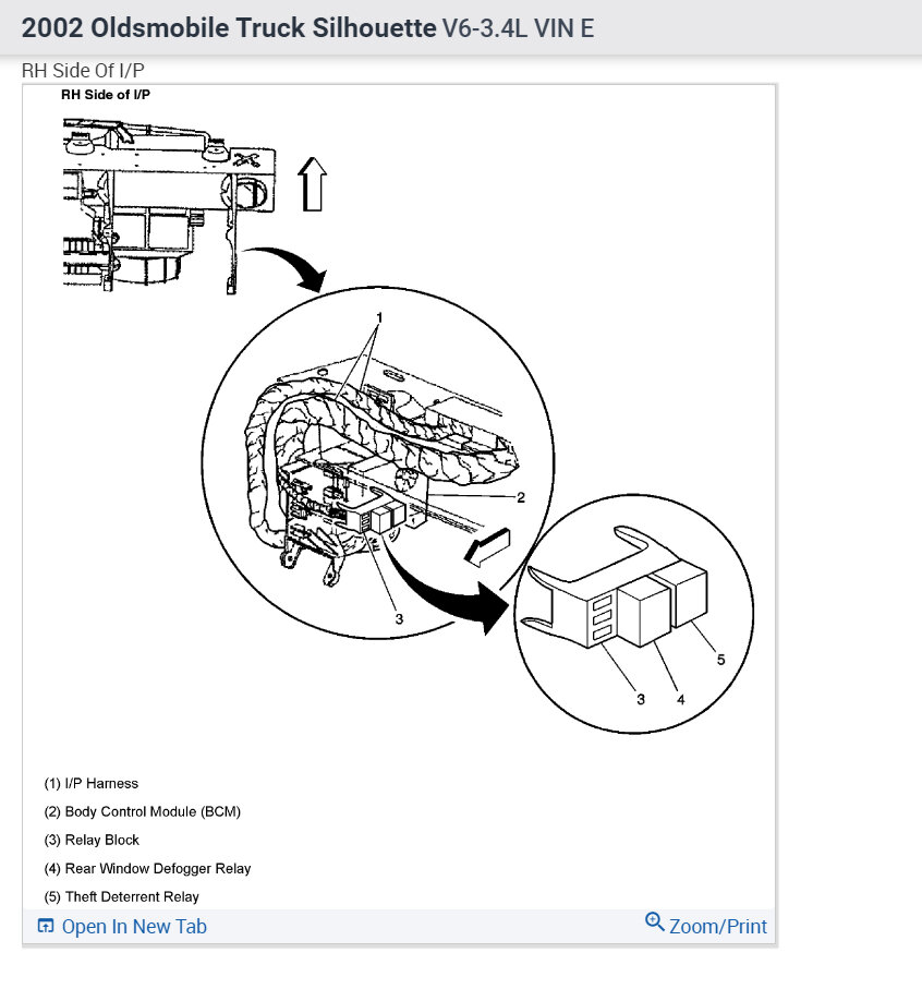

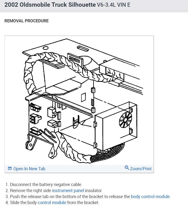

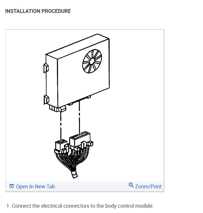

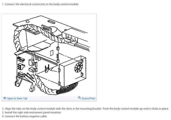

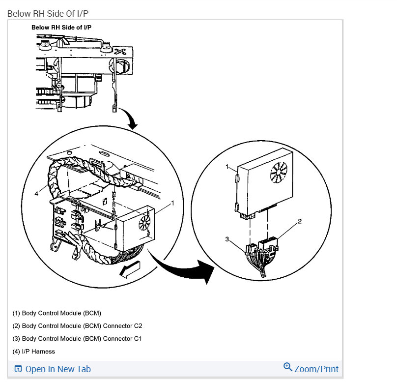

It does sound like the BCM is out but to be sure let's run a CAN scan, you can get a CAN scanner (Controller Area Network) which will work on most cars from Amazon.
here is a video to show you how:
https://youtu.be/u-4syLc-ifQ
Here is the BCM location you if a code comes up for it you can swap it out, you can get a preprogrammed unit by searching Google or Ebay. Check out the images (below). Please let us know how it goes.
