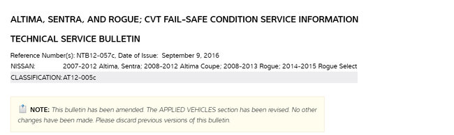

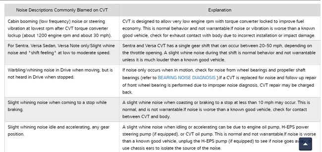

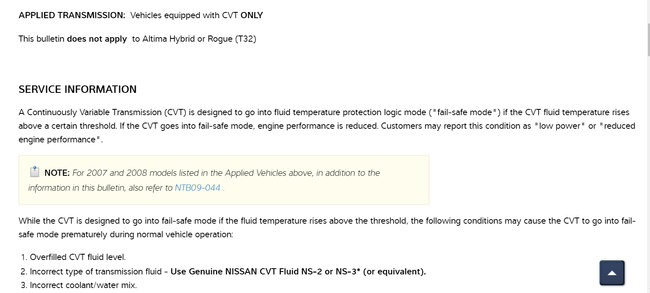

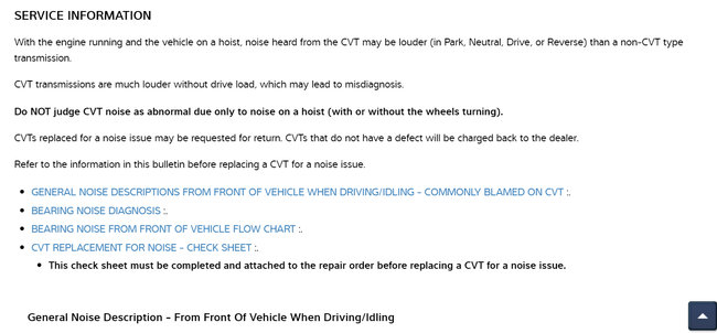

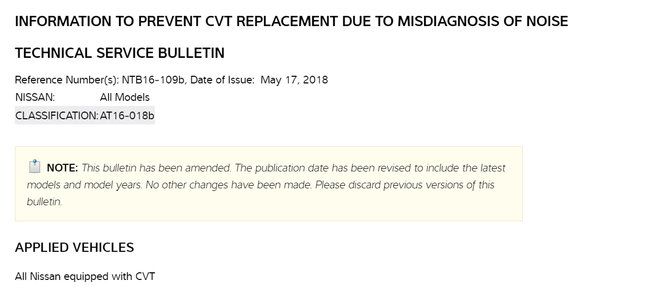

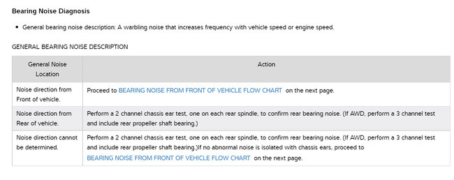

Hello, sorry to hear about this issue. Honestly, I have never heard of a compression test done on a transmission. They can do a pressure test on the system. But a compression test is usually done on Cylinders for misfiring concerns. Here is a TSB (Technical Service Bulletin) on the CVT, this is not the only one, there are quite a few. These are TSBs that a dealership would have to do. Because if it's a fault in the design it's their responsibility to repair that fault. The fact that they couldn't be more specific about what "sensors" they had to replace. And that's the same as the spark plugs and the 02 sensor. It sounds like they are not able to diagnose the car properly and are just throwing parts at it. These are things some shops will do when they won't admit they don't know what's wrong. It shouldn't take more than a day or two to know what's wrong with a vehicle.
I do think you should get a second opinion, because I can't stand it when this happens, and they take advantage of people. There are multiple TSBs about the CVT, you may want to call a dealership and just ask what recalls there might be for this issue or have them look up the TSBs. I count at least 8 TSBs, plus more. Some have to do with reprogramming/software updates. All these add up to having someone else take a look at your car for you. I also with the car not accelerating there are probably diagnostic trouble codes stored in the engine computer and/or transmission computer.
That garage is withholding information from you.
Page 5 and 6 is an example of another TSB.
