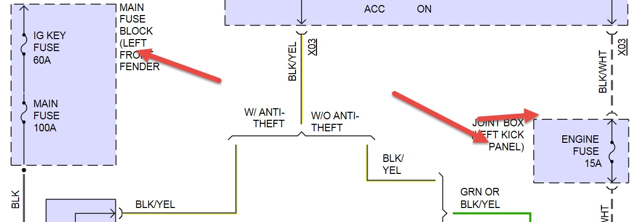

Working on my sisters 94 mazda 626 cronos and it won't turn over. We just put in a new starter and solenoid thinking that was the problem. It was not. We also had the battery recharged. Anything else we can try?

check fuses in pc and check relay in main fuse box.

pic
