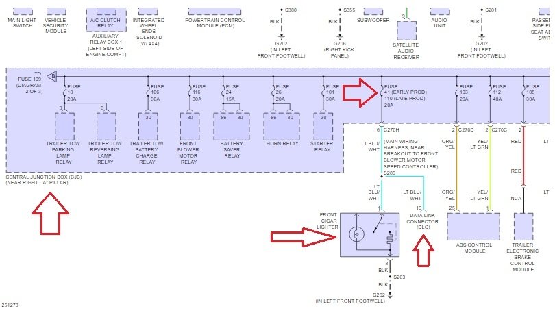

Check fuses 41 or 110.
I grabbed you part of a Prodemand diagram.
Click on it below.

I replaced the 110 fuse and the 41still no OBD port still no cigarette lighter, still no 12 volts on the dash. None of the three are working still. One month ago I had the junction box replaced because the gauges and A/C kept flickering on and off. My friend said sounds like the j Box was bad so replaced had it checked out. It was the alternator. Would this maybe be a cause also? My truck manufacturers date is 11/06 which mean it is a early 2007 I believe.

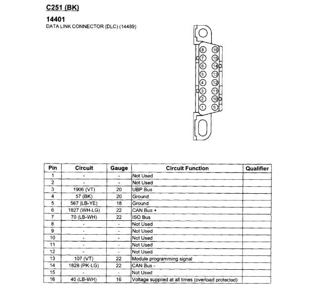

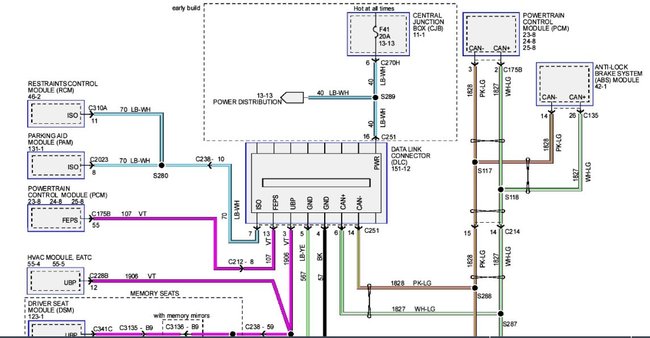

Good afternoon.
I could not read CJ diagram but I attached my own along with the schematic for the connector as well.
Go to the fuse listed and make sure you have power on both sides of the fuse all the time. If you do not, that would account for the issues you have.
Lets start there.

Good afternoon
Lets start there.

Okay, if you have no power to the fuses, that is why you have no power to the plug. You have a wiring issue with the fuse block if there is no power.
Check the fuse box for any damage in the rear where the wires connect.

There is a problem with the fuse box as it is not providing power to the fuses.
The fuse box must be inspected.
