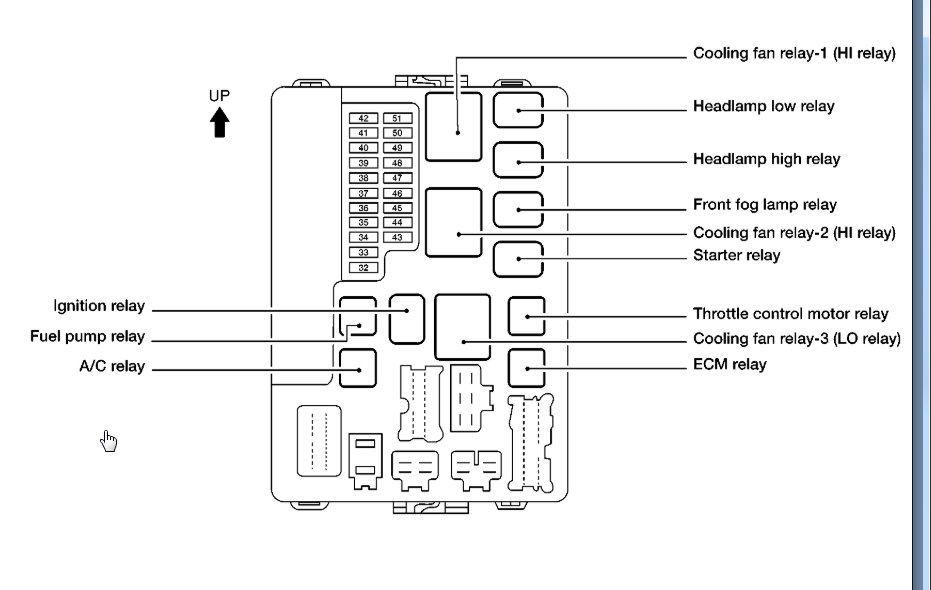

Replaced bad battery less than a week ago. Been driving around since with no problems. Drove around today, no problems. Went to leave and now it won't start. Turn the key and everything seems fine (all lights, radio, A/C, etc., working fine) but when I try to start it, nothing. The engine isn't even trying to turn over. No clicking, no whining, no sounds at all coming from under the hood. What could cause this? And how can I fix it?

We need to check to see if you have power at the starter. If it is not clicking then more than likely it is not getting power. If not, it could be the relay. I attached the location.
If it is getting power then more than likely the starter has failed.
Here is a guide that lays out what happens when a starter goes bad. Let me know what you find and we can go from there. Thanks
