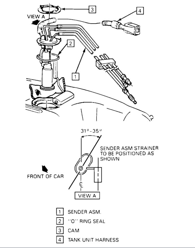

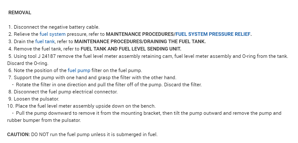

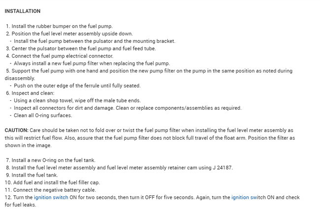

It has always started right up but I let it set for about six months. It was low on fuel and I added fuel to it and charged the battery. Now the fuel light is showing E like I didn't add the gas. It is trying to start, but it's like it's not getting fuel. Any suggestions? I think I read that the fuel pump on it is in the gas tank. Could that be right and if so, how would you change it?
Jul 12, 2019 at 1:30 AM
SCGRANTURISMO
  • 4,897 POSTS

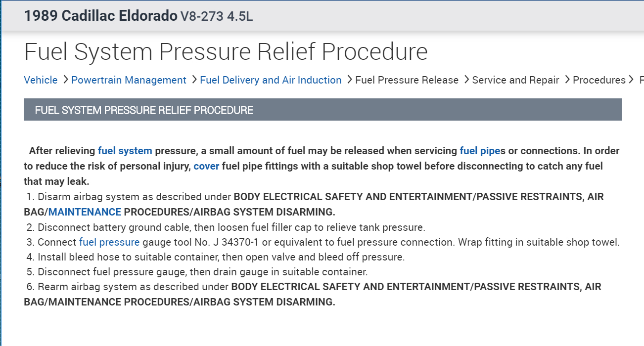

The information that you requested is in the diagrams down below, and yes the fuel pump is located in the fuel tank. Please go through this guide and get back to us with what you are able to find out, or if you have any other questions or concerns.
Thanks,
Alex
