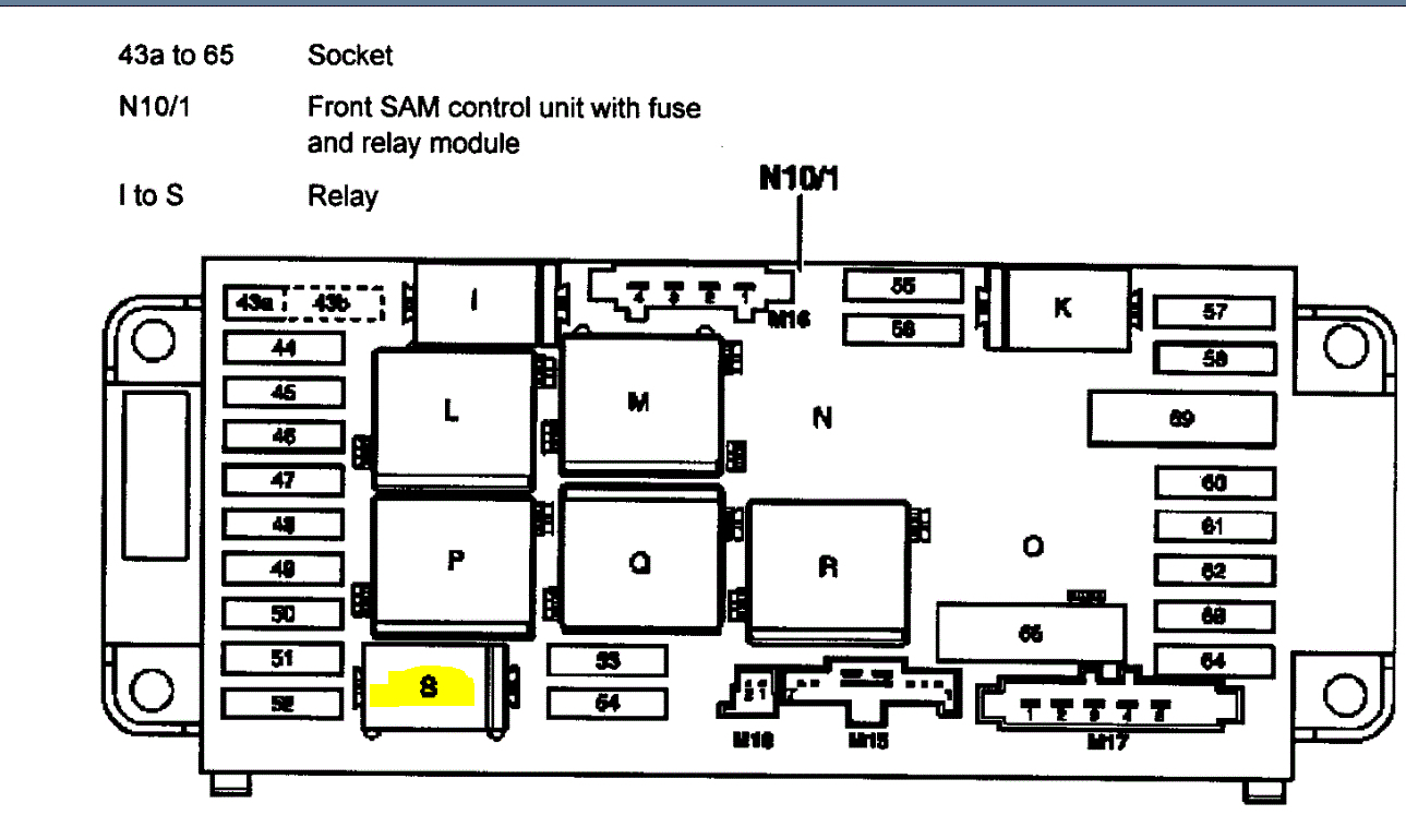

Does the clicking only happen when you try to start the vehicle? There is a starter relay in the fuse / relay box under the hood. Have a helper turn the key so you can hear it. Then, locate the starter relay and place a finger on it to see if you can feel it when it clicks.
I attached a pic below showing the relay location. If that is where it is coming from, switch it with a different relay in the box that has the same part number. If there isn't one, here is a link that explains how to check a relay:
Let me know what you find. Make sure you didn't by accident disconnect any of the grounds to the body which are near the light assembly. Also, I need to confirm that the starter motor isn't engaging at this time.

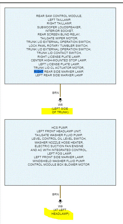

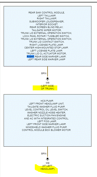

  • 110,241 POSTS
For some reason the video didn't upload. Can you resend it? Also, based on your description, it sounds like a ground issue.
I attached a pic below that shows where the grounds are for lighting. One is near the left front headlamp. The wires are brown in color. Take a look at the pic and let me know what you find.
Let me know which relay is making the noise.
Aug 21, 2020 at 8:02 AM
