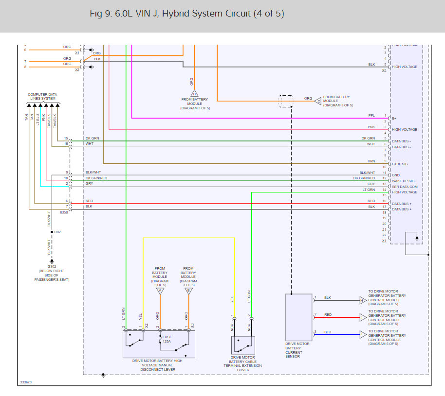

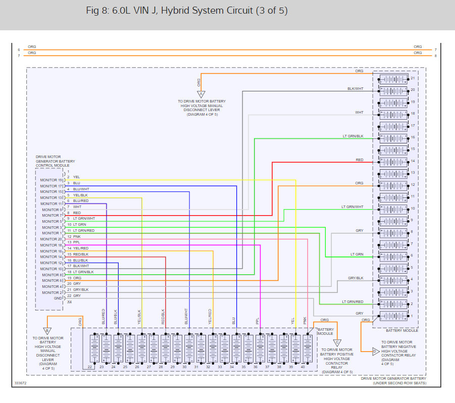

  • 55,694 POSTS

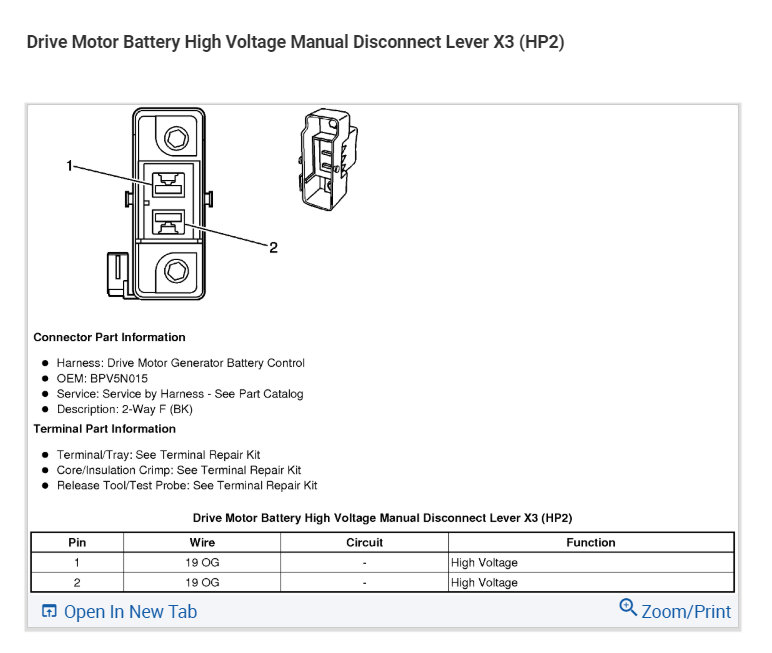

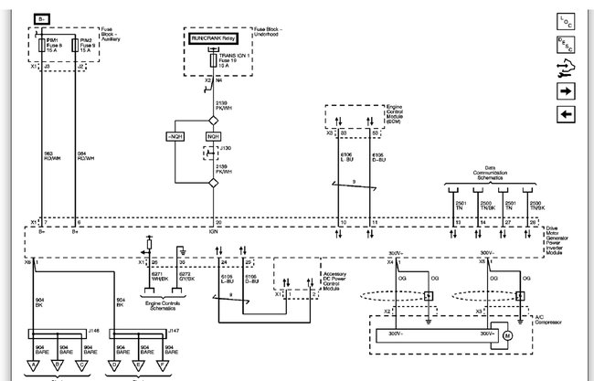

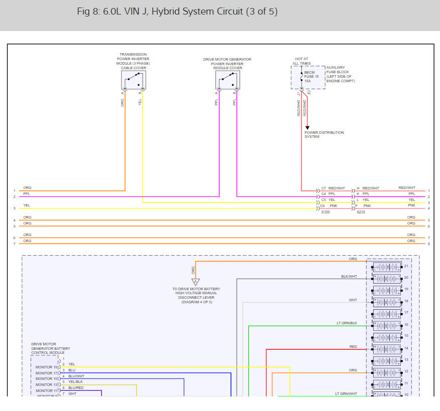

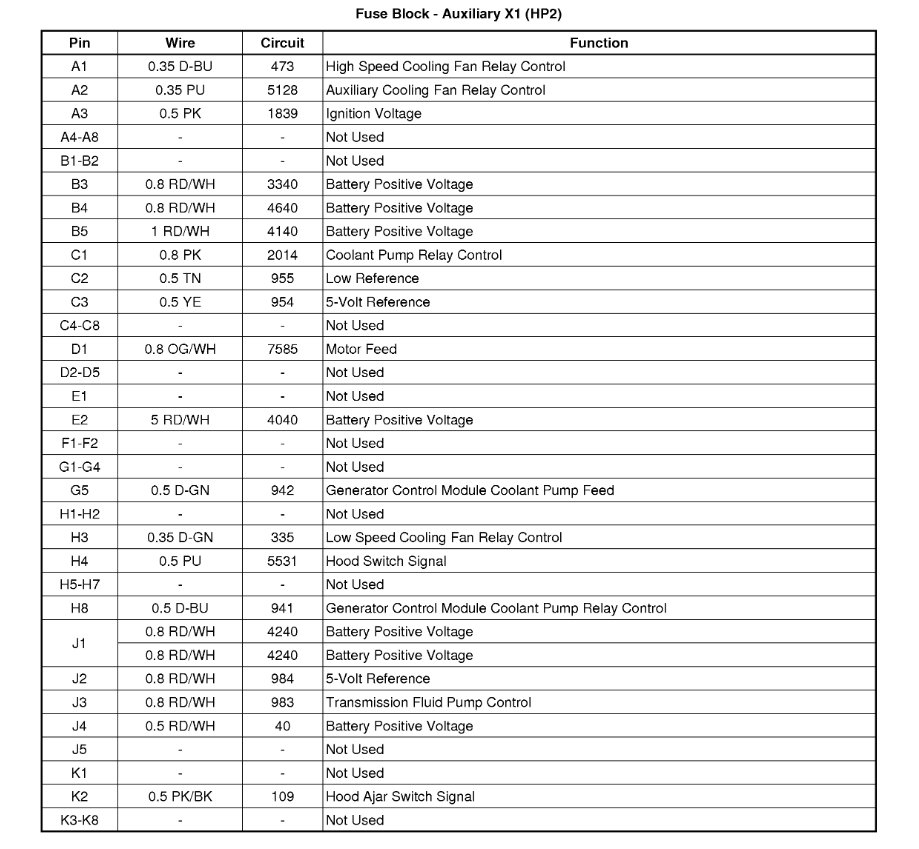

If I can but in here. this is the scanner you need which does the CAN system which is everything and is the new way they are doing things now. You can get one from Amazon for about $30.00.

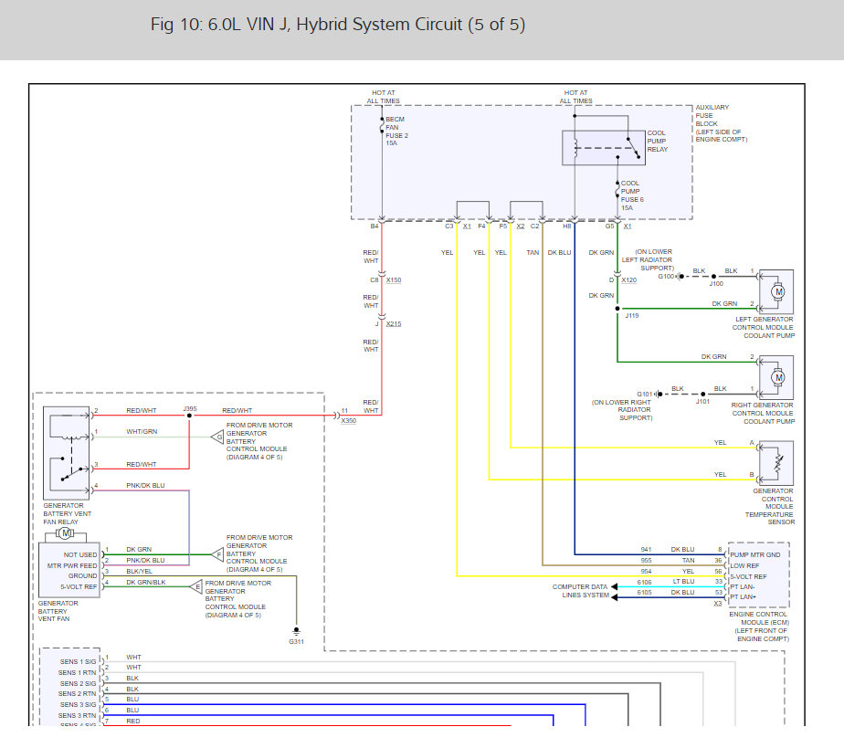

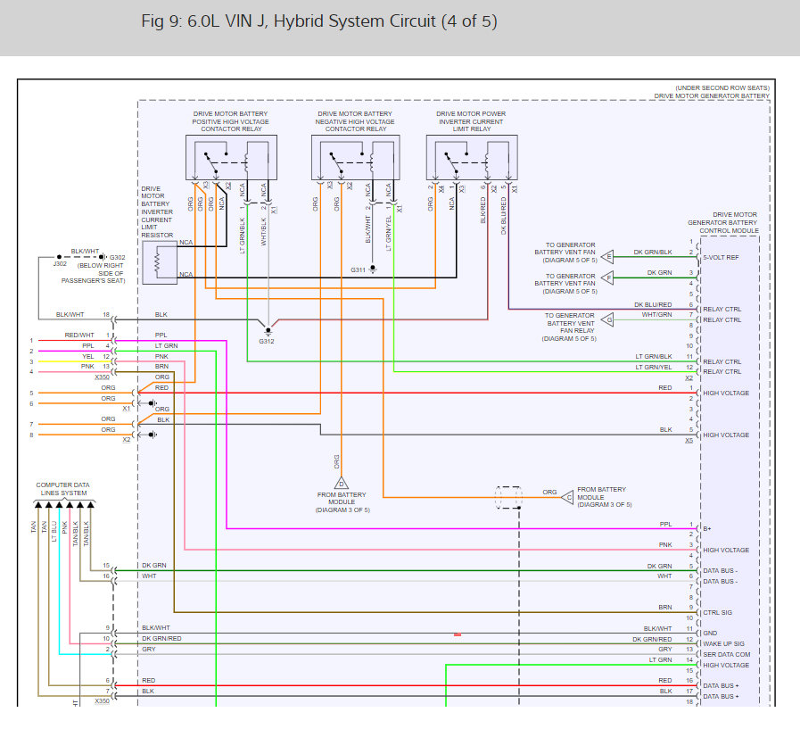

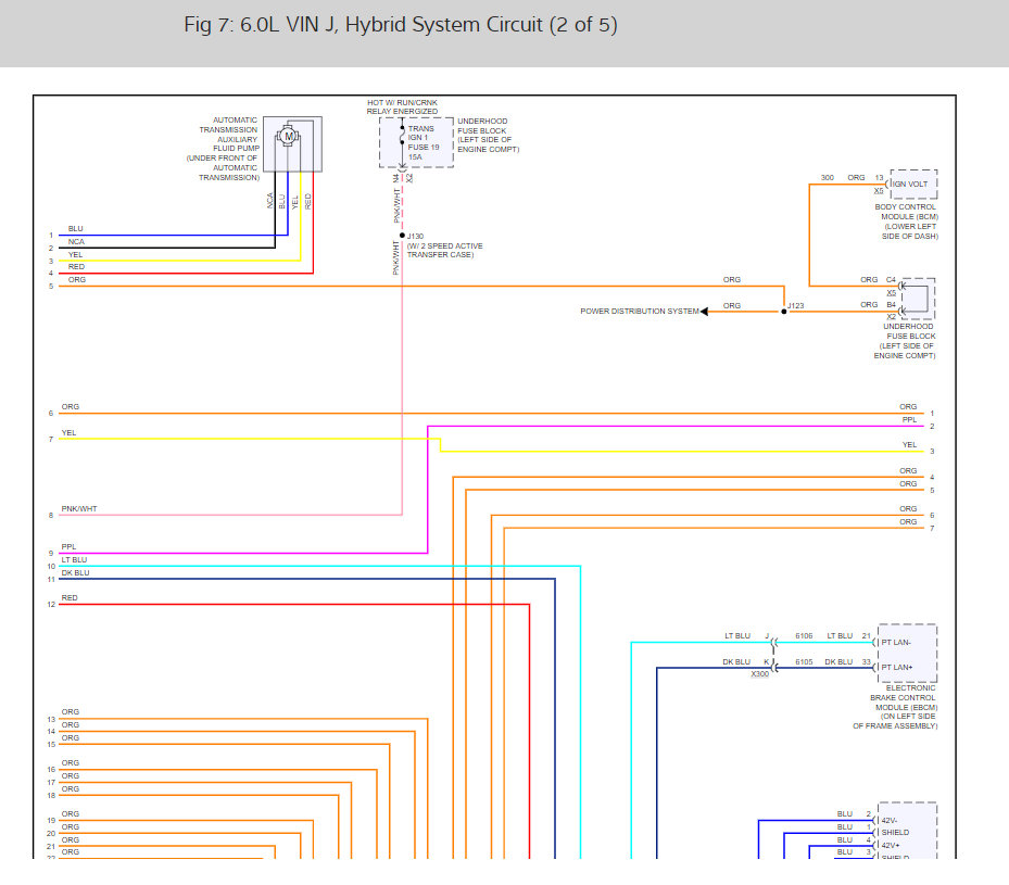

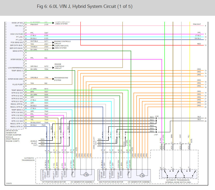

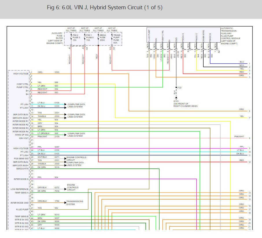

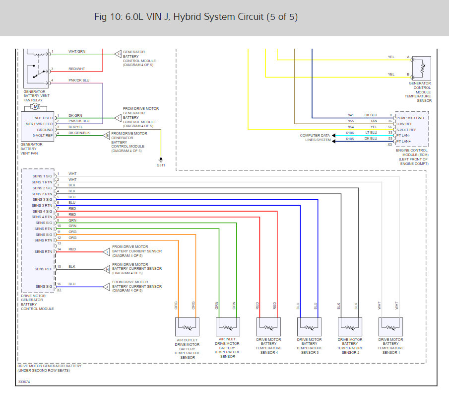

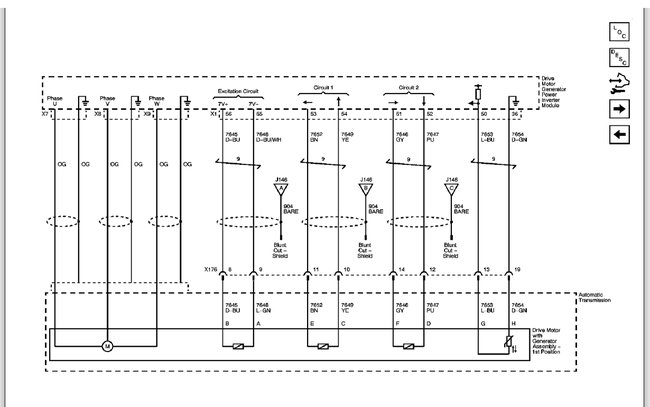

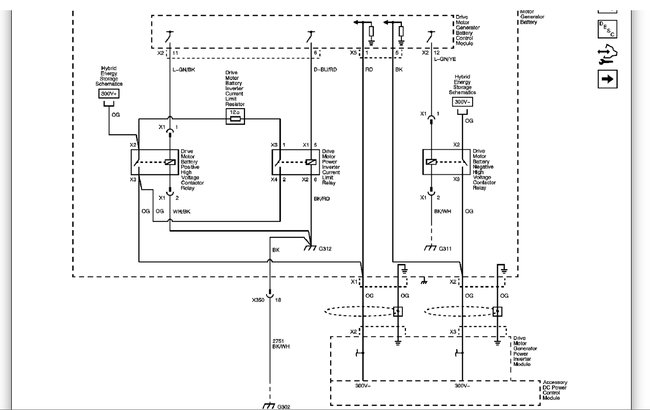

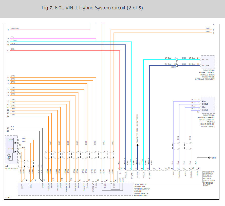

Check out this video and the hybrid battery wiring diagrams below so you can see how the system works.
https://youtu.be/InIlnsjOVFA

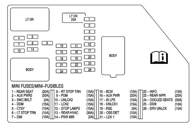

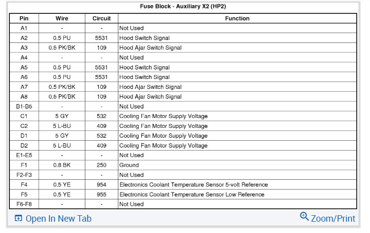

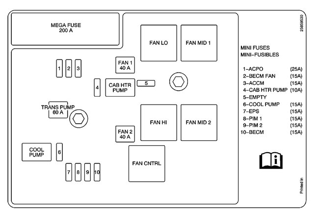

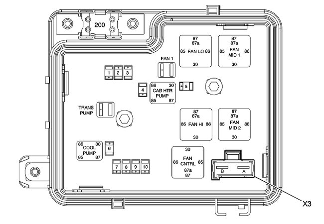

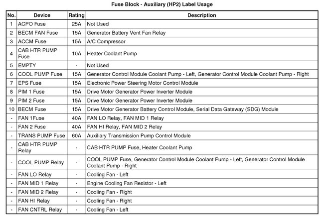

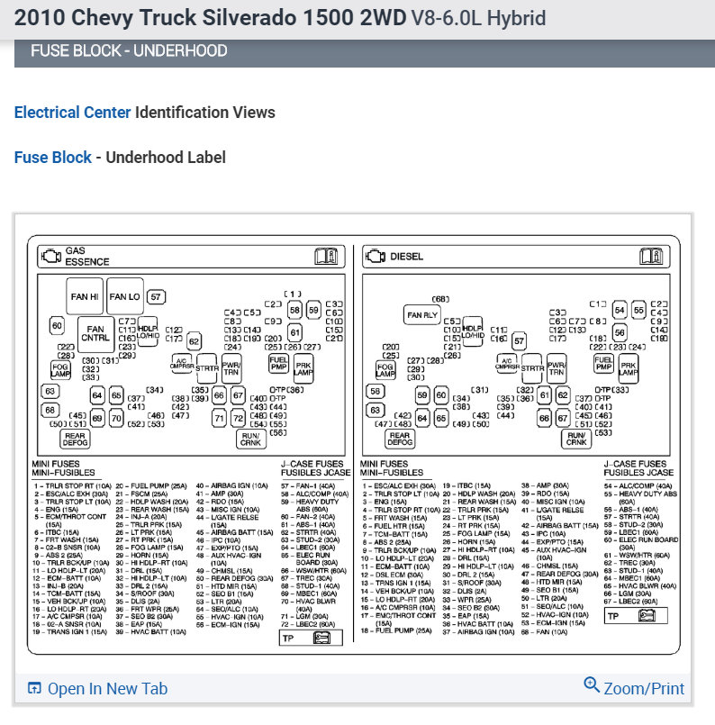

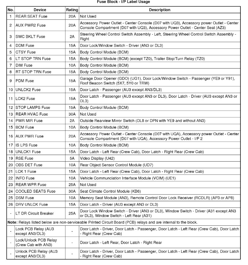

It sounds like the inverter relay is stuck on which will drain the battery and cause a protocol issue with the computer. I would check all system fuses and relays which are located in the diagrams below and you can see which fuses and relays to check by the Hybrid battery system wiring diagrams below.
Check for power at all fuses key on.

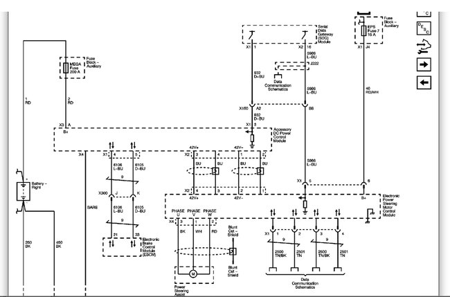

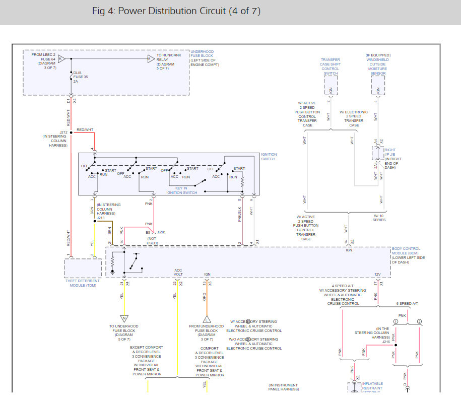

Hmm. You know the BCM has a lot to do with the system as well which they trouble with and would explain your issue. I would check all fuses and mega fuses. See if you can get the engine to turn over by bypassing the starter relay. Here is the starter wiring so you can see how the system works. Scan the CAN we need to see what that brings back, but I am thinking it will be the BCM. You are diligent, I like that.

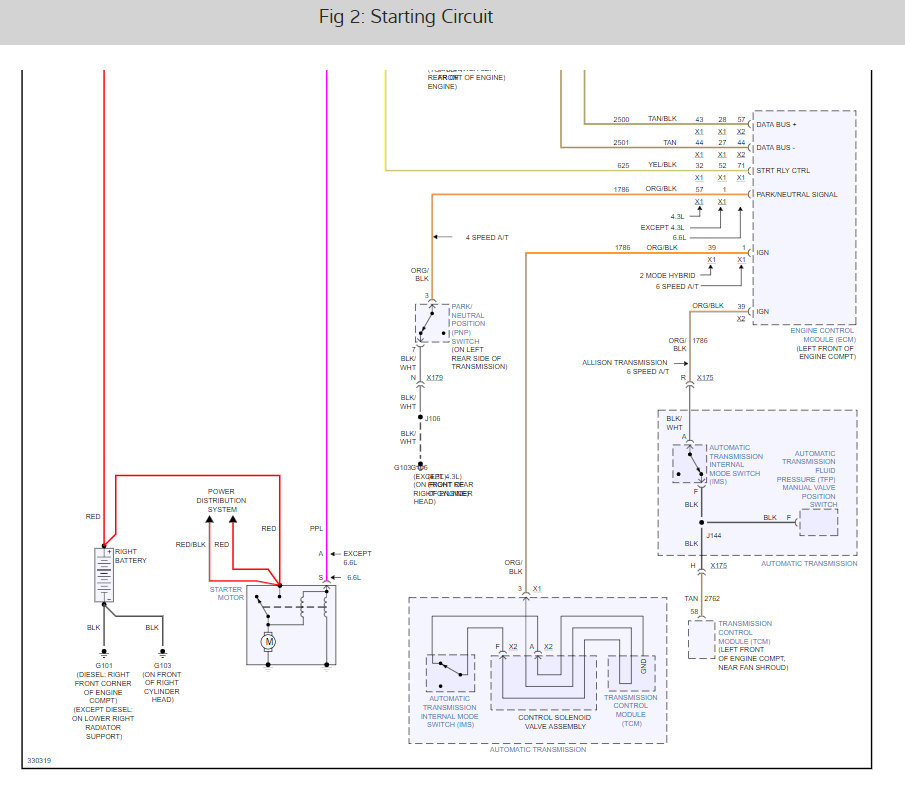

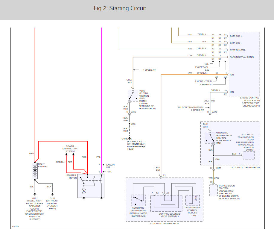

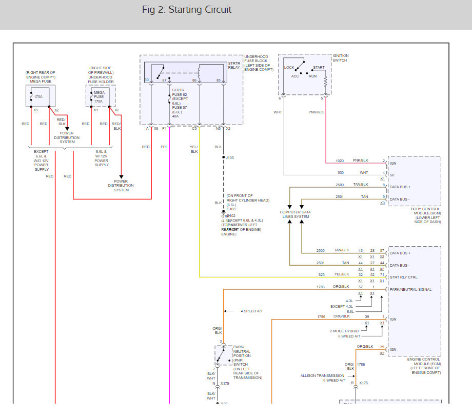

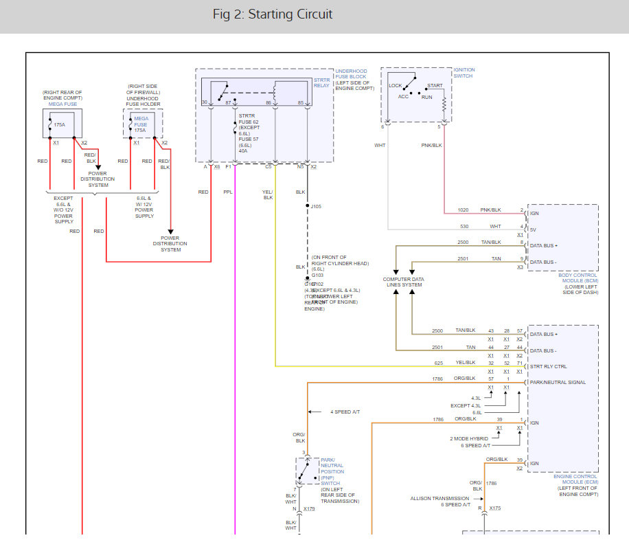

The only problem I see is the programming. I would sure like to get a CAN scanner on there to see what comes up ourselves. Did the engine crank over? did you have security light flashing? did the dash lite up when the key was on and did we check the mega fuses? This can be as simple as the ignition switch gone bad. Here is the wiring diagrams and a guide to help check the continuity:
Red/white should have power, "key on" the brown, pink and white should have power, pink and black should have power when in the crank position. Check out the diagrams (below). Please let us know what you find. We are interested to see what it is.

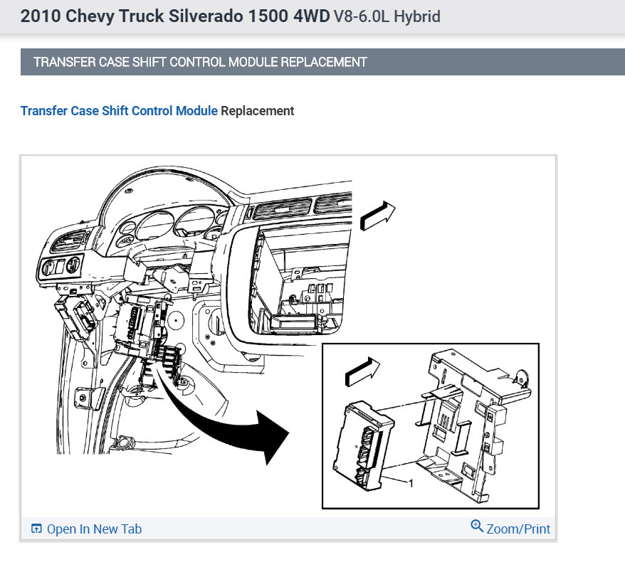

That being said. I put a scan tool on the truck. lots of communication codes, U0102,U0293,U1817,POAID,U1843. Then it has a test labeled; Available Modules; Global OBD2, Module# $7E8 Protocol;CAN Module# $7E9 The scan tool pretty much would not read anything. Their were more communacation dtc s caused by those faults and hybrid battery volts on 20 cells. On the dash. It reads, service theft deterrent system, service airbag system. service tire monitor system. SYS, engine, and airbag lights are on. everything else besides the drive train works. I have no idea. I was going to check the ignition switch as you suggested but after this i was not sure it would be needed. and the super fuses. wondering if they all need reprogramming.Do i start at the power as you suggested?
Feb 16, 2020 at 11:00 AM

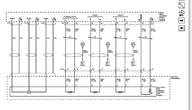

  • 55,694 POSTS

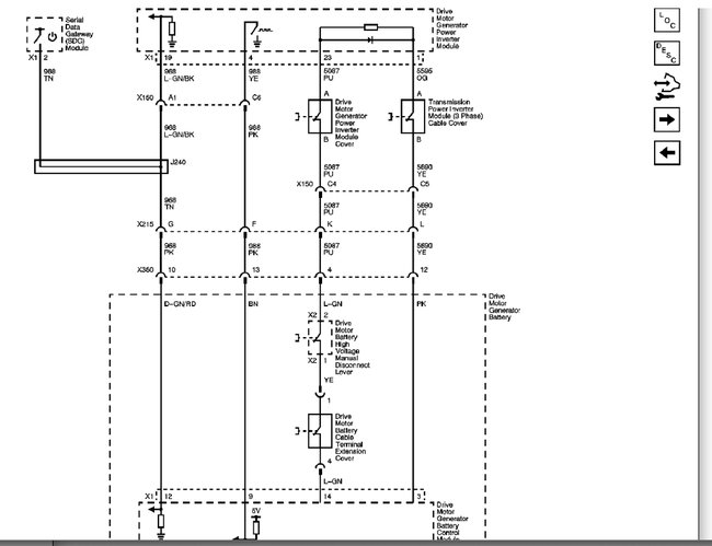

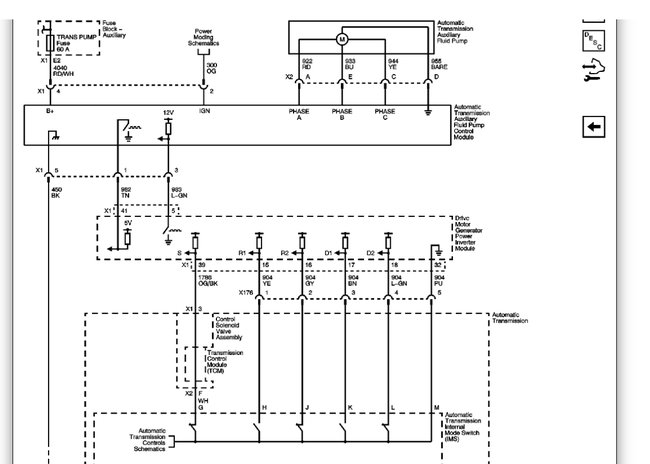

I made a mistake in the above post a can scanner is about $30.00 on Amazon btw. It seems like you are losing power somewhere not powering up one of the modules. Lets check the PIM1 and PIM2 fuses in the auxiliary fuse panel with the key on to check for power. Here are the hybrid wiring diagrams so you can see how the system works. I don't think you can jump assist without the tech2.
U0102 Lost Communication with Transfer Case Control Module
U0293 Lost Communication With Hybrid - Hybrid Powertrain Control Module (HPCM)
U1817 00; Definition: Lost Communication With Hybrid Powertrain Control Module on Bus "B"
We need to check power and ground to these modules. Here is the location. Check out the diagrams (below). Please let us know what you find.

Hi guys.
All the grounds are good on what I tested. At the end I was at the invert er plug in. And I have 12 volts at pin 6 and 7 and I have 12 volts with ignition on and in crank mode on the the pink and white wire. So it looks to me that the internal circuits of the assembly. are not working. The invert er is not closing connectors for the 300 volts at the hybrid Battery to power up the generator motor to spin it over. And the invert er is not talking with the power train control mod. to tell it to start. I think. The scan tool I bought is a Innova 5410. The only reason is because it said it would do a full system scan. When I hook it up. It says it in interfacing with the high speed can. The it starts sending the codes I showed you. But no code for not being able to communicate with the can buss. So is that OK then?
I spent so much time reading tons of tests that I was to do at the Alldata site that I joined. I was so disappointed to find out that all those tests require a tech 2 scan tool. Dealer only. And I was joined into the DIY part of Alldata. I think that stops short of this involved diagnostics. Seemed like every time I would get to where I was going to figure out how to test... Pretty much anything. The info just stops. I think that is because of the do it your selfer version. I was even looking for the Alldata scan tool. But I couldn't find it anywhere.I still don't know anything thank you for helping. I am thinking that the newer components are not matched and able to work with to the old ones. What are you guys thinking?
Also, when the truck is brand new and being built. What is the first component of the Hybrid system that is programmed? I am wondering if everything has to be matched to the program the pin is programmed with or is there something else first? I know I talk too much but I have a lot of questions and really want to understand this a little better. Thank you.
