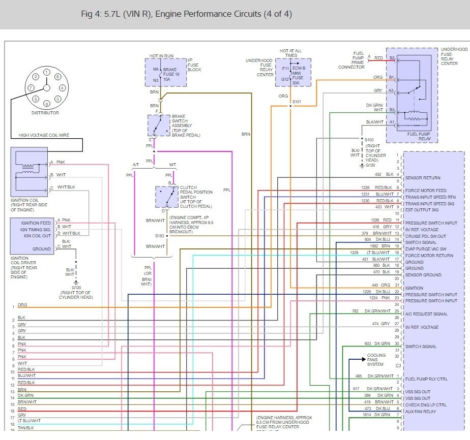

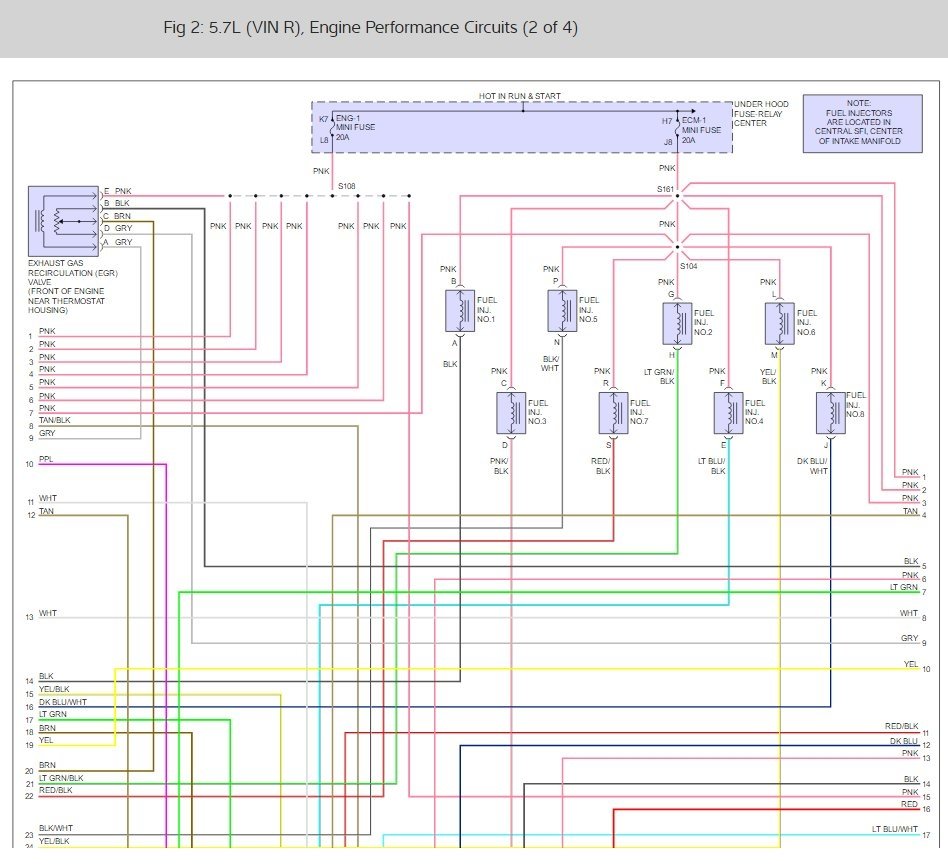

Okay, lets check to see if the system has power there are some fuses that need to be checked first, Here is a guide and some diagrams to help you find the problem.
You are looking for power at the injectors with the key on. This will tell us if the computer is powered up.
Please run some tests and get back to us so we can continue helping you.

Okay, so not sure what I am missing. Hoping you will shed some light. So this is concerning the truck listed above Z71 Stepside, extended cab pickup that has the 5.7 Vortec. I have pretty much rebuilt this thing. I had the spider injection go bad on me and when my mechanic said it was to be over $900.00 for him to repair I had to opt to repair it myself. So have installed a brand new spider injector and after reassembly the truck fired right up after charging the battery only ran poorly. I went ahead and replaced the plugs and wires and after a small move of the distributor I had the truck running again. I just left the truck running that day because I am trying to let the gas that did reach the oil to burn off as suggested by one of your guys. Anyway after running for quite a while the truck shut off and would not restart so I just chalked it up to I had ran it out of gas. 4 or 5 days later I finally got a ride to get more gas, which I just got $10.00 worth and put that in the truck. Well I cranked and cranked it and it would not start. So I pumped the gas pedal to the point it should have been flooded. However I couldn’t even smell gas at all so I noticed it was getting fuel and I couldn’t hear the fuel pump kicking on so I went ahead and replaced the fuel pump, fuel filter (which does not have the arrow and the word flow on the side of it instead it has in on one end and out on the other end) and the fuel relay. Still cranking without starting. I can hear the pump kicking on again, I have disconnected the fuel filter and gas came out of it and when I push in the pin on the relief valve some gas comes out on top of the motor. I also disconnected the ground wire and scraped and sanded the section of the frame so that it is for sure got a good connection. Really frustrated at this point and not thinking straight I guess so hoping you can direct me to what I am over looking.

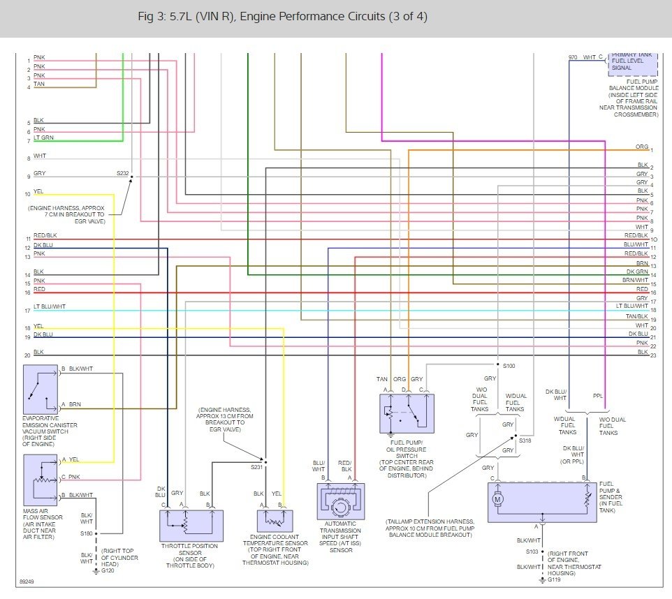

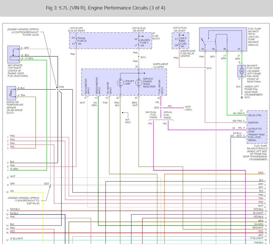

Okay, if it tried to run on starting fluid it has spark. Check the actual fuel pressure. I have seen a lot of bad pumps straight out of the box. Also, did you replace the pump connector with the new pump? Second, check that the fuel pump relay is actually working as well as the oil pressure sender. GM uses the relay to prime the fuel system but once it has oil pressure the power feeds through the oil pressure switch to the pump. That way a loss of pressure shuts the engine off. The normal symptoms in them are, Long crank and then the engine starts, this is usually the relay or it's socket causing a lack of the first prime and the oil pressure switch has to trip on before fuel flows. The next most common is for the engine to start and then die real quick. This is a failure in the OP switch causing the power to the pump to shut off. A quick way to test for both of those is to jump battery power directly to the fuel pump prime wire. This will be a gray wire that is taped up near or in the harness near the fuse box. It feeds power directly to the pump. If you apply power and the truck runs, the oil pressure switch has failed.

That is the ground wire for the tank and filler, it should bolt to a clean spot on the top of the tank usually at the pump to provide a ground.
Yes the grey wire will be near the underhood fuse box.
