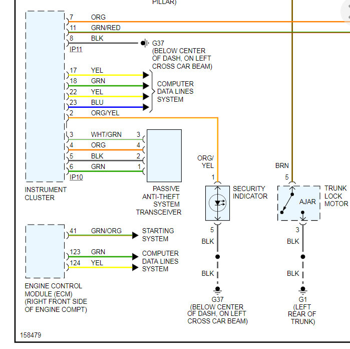

car won't turn over with key. can jump starter but won't start turns over.
Mar 5, 2020 at 6:35 AM
Does the theft light stay on when turning the key? This would explain why the engine is not turning over with the key and does not start by jumping the starter. You need the theft system to deactivate and cannot bypass this.
If this is the case, we need to check for codes and go from there. Thanks
Mar 5, 2020 at 7:58 AM
TIM CHASE2
that's what I thought. I will check for any codes. thanks
Mar 5, 2020 at 11:16 AM
Okay. Keep us posted on what you find. Thanks
