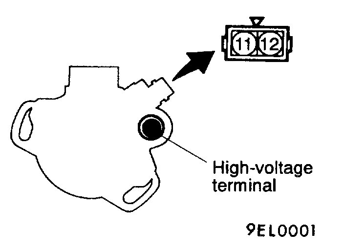

Just bought this car, just quit running while driving. it cranks won't start. I've replace plugs and wires. New distributor cap and rotor. New crankshaft sensor new battery. still no spark. now what

First, remove the distributor cap and have a helper crank the engine. Is the rotor turning?
If so, then I need to have you check the ignition coil. Here are the directions and information on the resistance required. Picture 1 shows the pins involved at the distributor.
1. Measurement of the primary coil resistance Measure the resistance between connector terminals 11 and 12 of the distributor.
Standard value: 0.6 - 0.8 ohms
2. Measurement of the secondary coil resistance Measure the resistance between the high-voltage terminal and connector terminal 11.
Standard value: 12 - 18 ohms

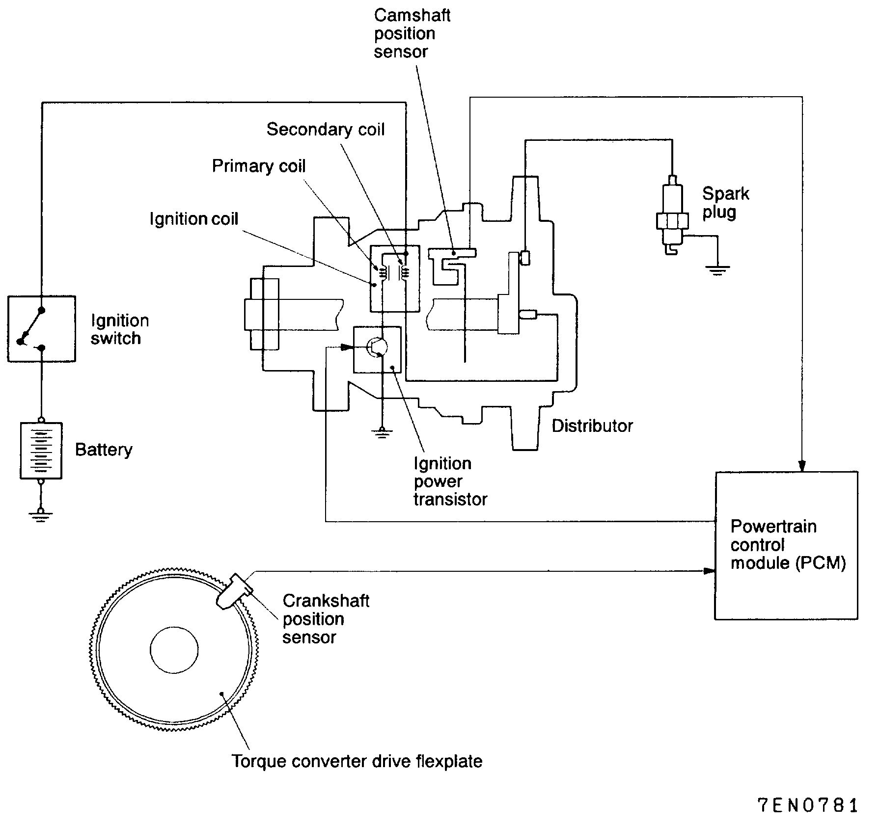

I also attached picture 2. It shows the wiring schematic for the ignition system.
