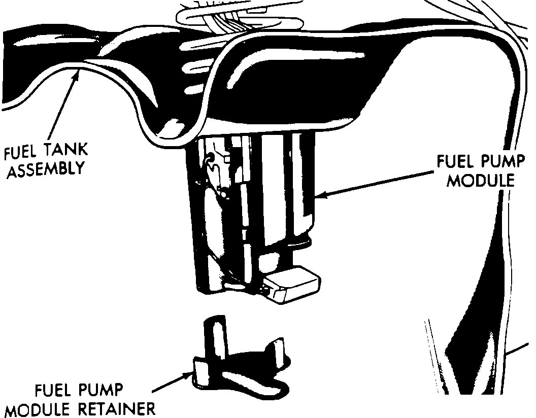

2. Fuel tank must be removed prior to fuel pump service.

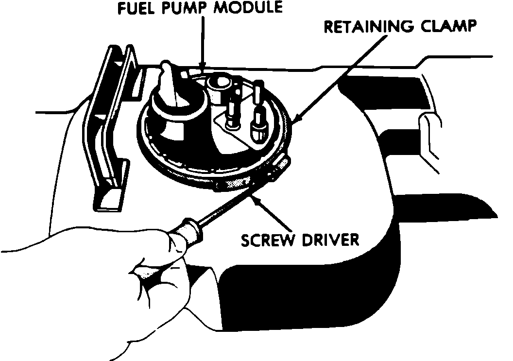

3. While holding the fuel pump module down, remove the retaining clamp. After the clamp is removed release the fuel pump module and it will spring up from the fuel tank.
4. Remove the fuel pump module from the fuel tank.

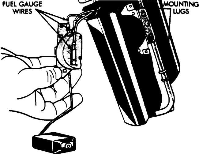

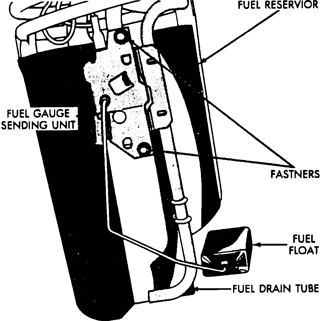

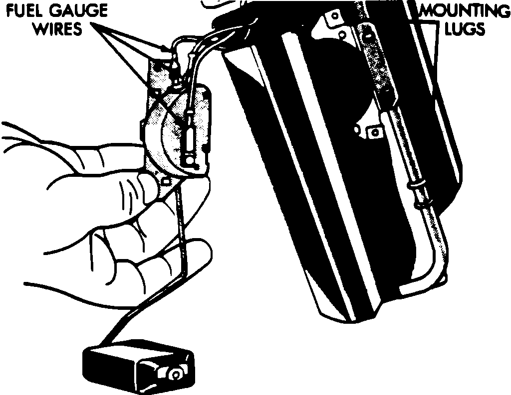

Fuel Gauge Sending Unit Service
1. Remove sending unit attaching screws from mounting bracket located on the side of the fuel pump reservoir.
Fuel Gauge Sending Unit Wiring Terminals
2. Disconnect electrical connections from sending unit, and remove sending unit.

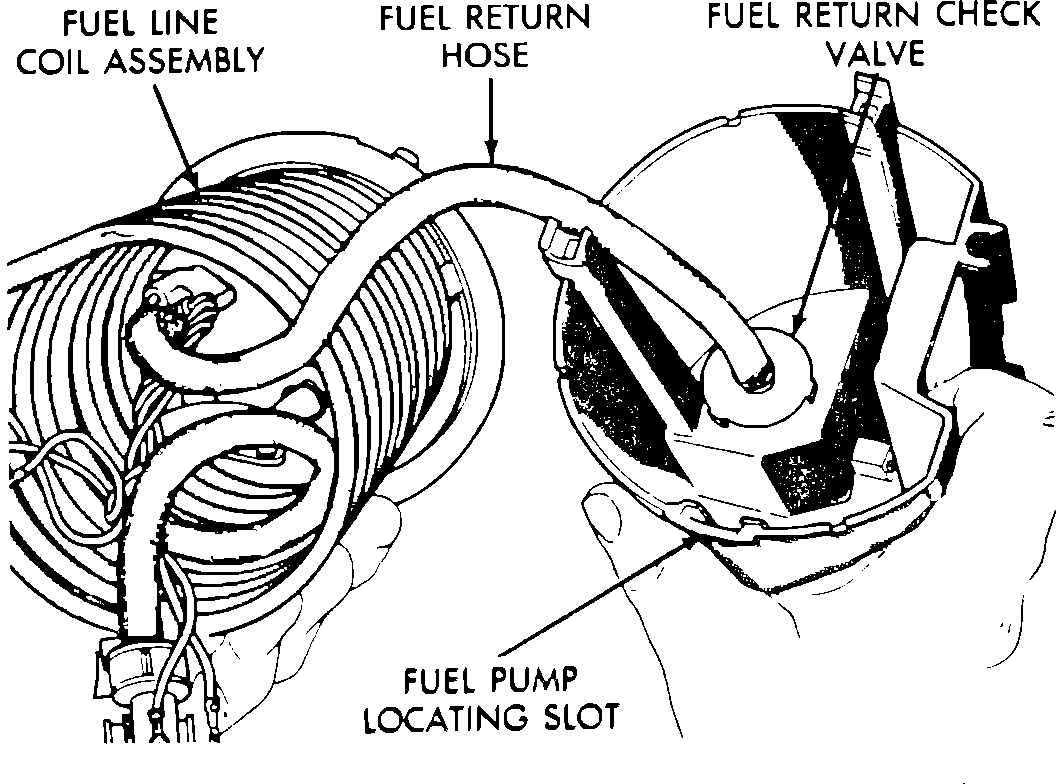

Removing Fuel Line Coil From Reservoir
Fuel Pump And Reservoir Assembly
3. Remove drain tube from the side of the fuel reservoir. Be careful not to let the fuel return line and check valve come detached from the inside of the reservoir.

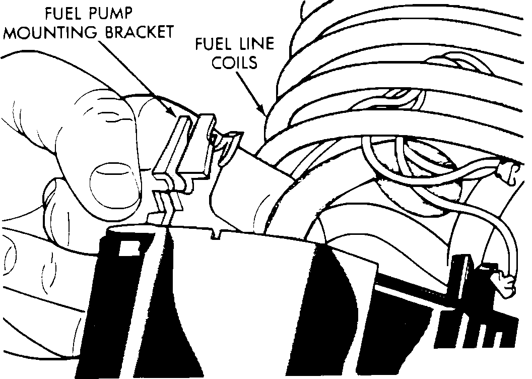

Fuel Pump Mount Bracket
Fuel Pump Removal/Installation

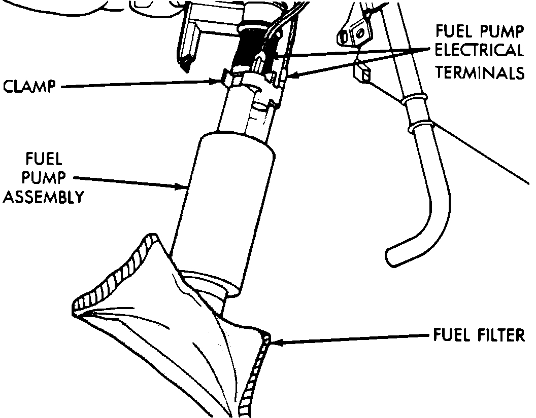

4. Remove the fuel pump assembly by pressing on the mounting bracket with your thumb and forefinger. Press with both thumbs toward the center of the fuel reservoir.
Servicing In-Tank Fuel Filter
5. Remove pump mounting bracket and rubber collar from hose and retain for assembly. Cut the hose clamp from the supply hose and discard. Remove pump/strainer assembly from hose.

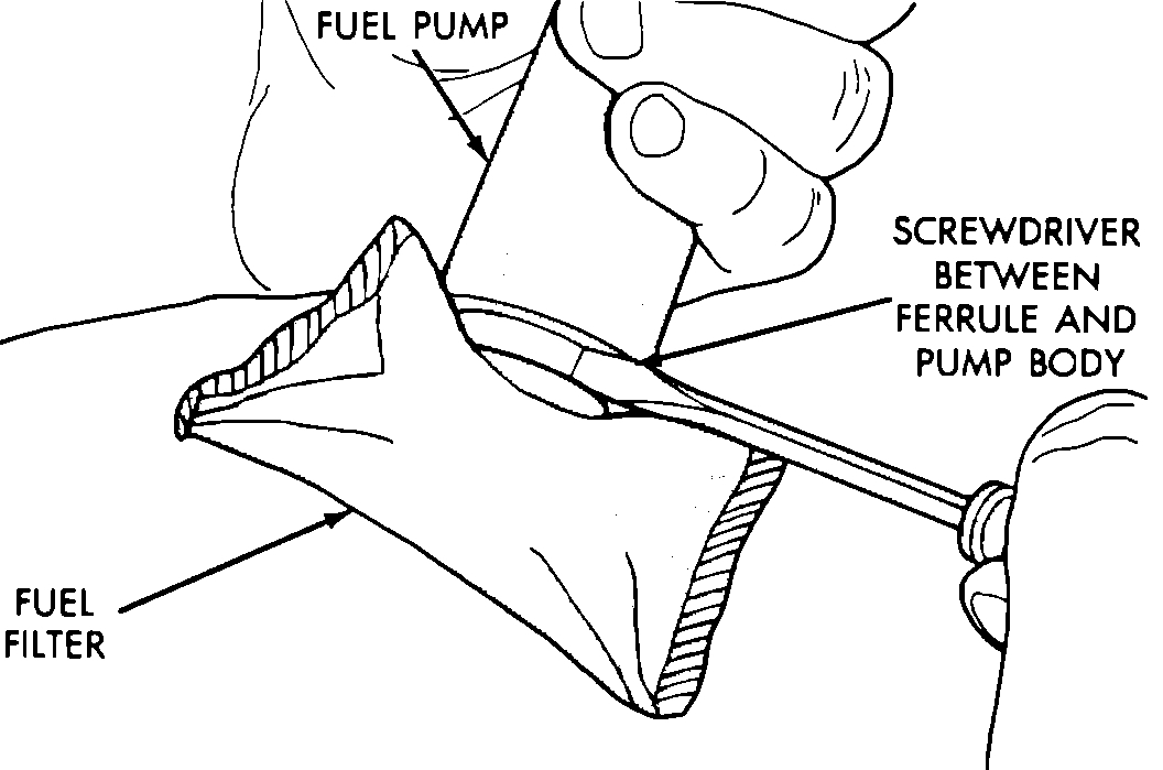

6. If fuel pump is functioning properly but fuel strainer is defective, use a broad blade screwdriver and "walk" around the strainer mounting ferrule to remove it from the fuel pump. Be careful not to damage the fuel pump inlet. If fuel pump is defective, replace both the pump and filter.

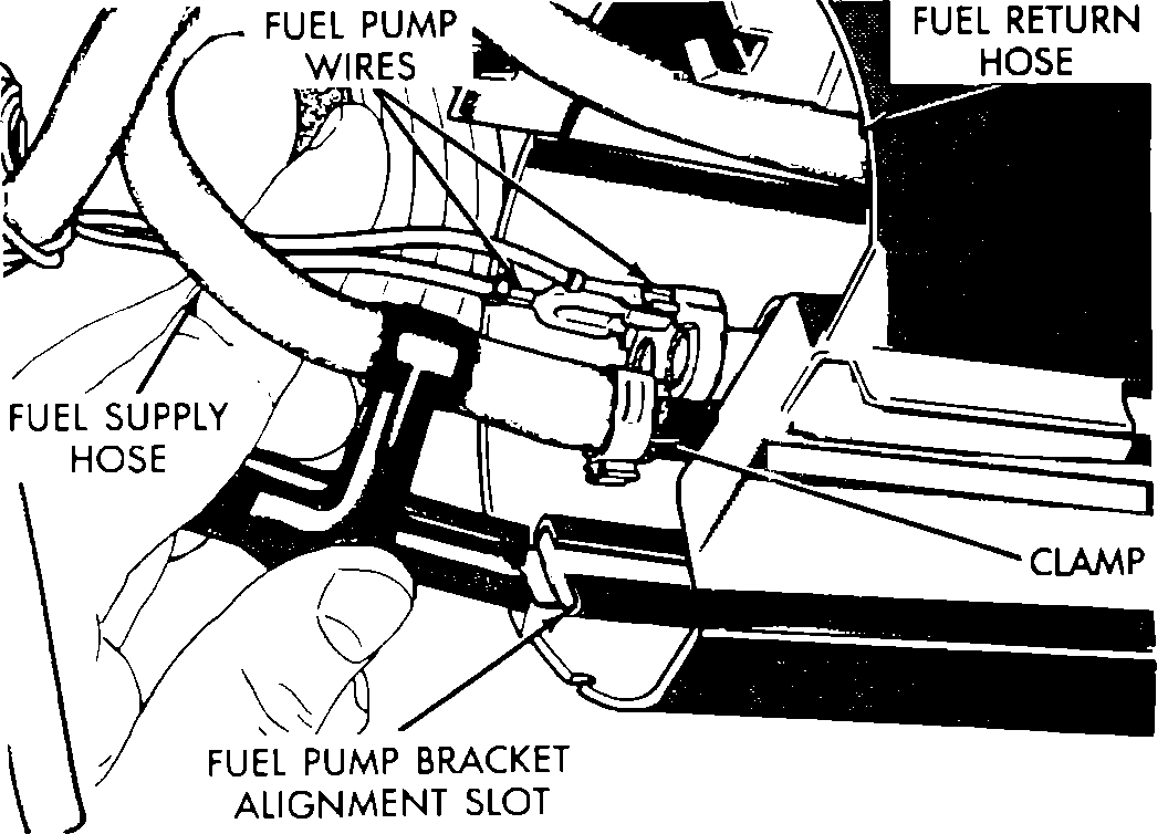

2. Install new clamp to attach the fuel pump to the supply hose. Use tool # C-4124, or equivalent, to crimp clamp.
3. Reposition pump mounting bracket and rubber collar on the fuel supply hose between the bulge in the hose and the fuel pump.

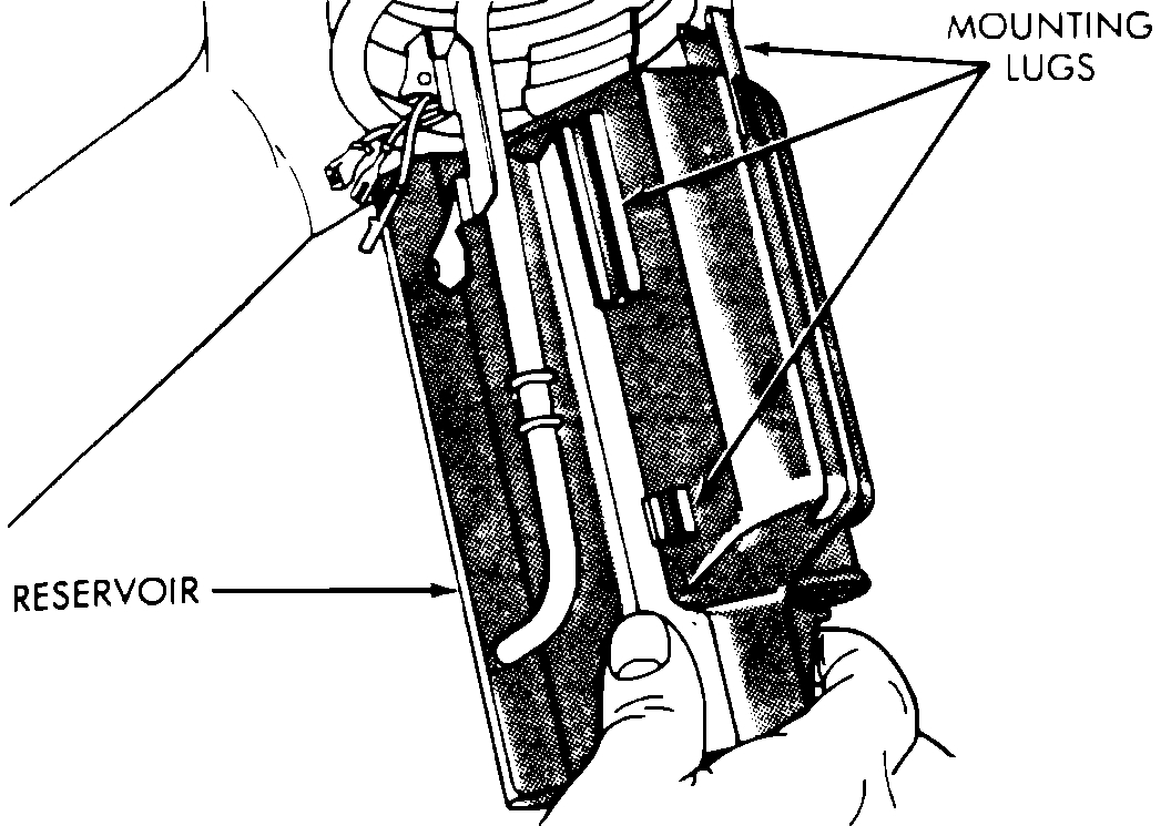

6. Install the reservoir so that the drain tube aligns with the mounting lugs on the reservoir.
7. Snap the lower-most fuel coil into mounting lugs in the top of the reservoir.
8. Snap the drain tube into the lugs on the bottom of the reservoir.
9. Connect the electrical wires to the fuel gauge sending unit.
10. Align the index hole on the reservoir with the index tab of the new sending unit mounting bracket.
11. Attach sending unit to mounting bracket and tighten the mounting screws.

1. Wipe seal area of tank clean, and install a new O-ring seal on pump.
Fuel Pump Module Retaining Bracket
2. Align fuel pump module with fuel pump mounting bracket (in the bottom of the fuel tank).
Fuel Pump Module Removal/Installation
3. Push fuel pump module into the retaining bracket and hold with one hand while tightening the clamp with the other hand. Tighten the clamp to 40 lb-in (4.5 Nm)

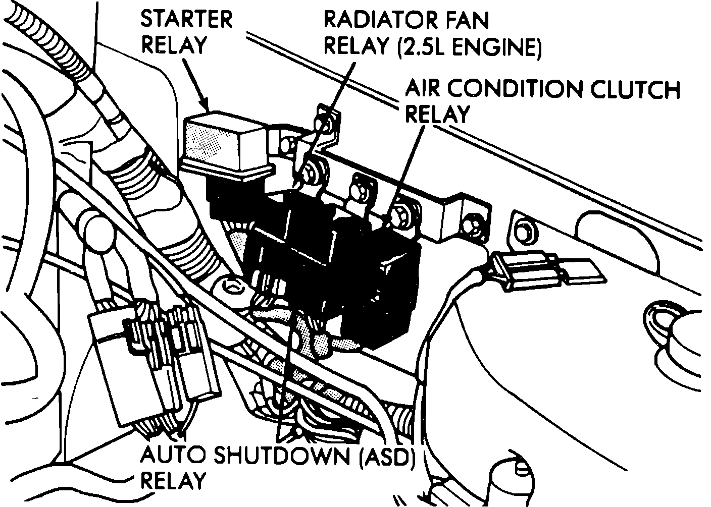

The issue could be related to a few things, a bad ground, no power from the auto shut down relay, or the pump is bad. Here are directions for testing:
1. Connect an ohmmeter and check that the fuel pump ground circuit has continuity. If there is no continuity, follow the flow from the fuel pump back to the chassis and perform necessary repairs. If there is continuity, go to step 2.
2. Turn the ignition switch to the "on" position.
3. Connect a voltmeter to the DG/BK wire of the fuel pump electrical connector, and check that that there is 12 volts for approximately two to three seconds. The Auto Shutdown (ASD) relay will only operate the fuel pump for 2 to 3 seconds under a key "on" engine "off" condition.
4. If there is voltage to the fuel pump, and the fuel pump still does not operate, the fuel pump is defective and needs to be replaced.
5. If there is no or low voltage at the fuel pump connector, connect a voltmeter to the DG/BK wire (terminal no. 87) of the ASD relay, and check for 12 volts. If there is voltage, repair the DG/BK wire between the ASD relay and the electrical connector of the fuel pump. If there is no voltage, test the Auto Shutdown (ASD) relay.
___________________________
The Auto Shutdown (ASD) Relay is mounted on the left-hand inner fender in the engine compartment. I attached a picture for you to see its location.
I hate to say it, but there is a good chance it's the pump. If he follows the directions listed above, he can confirm it.
