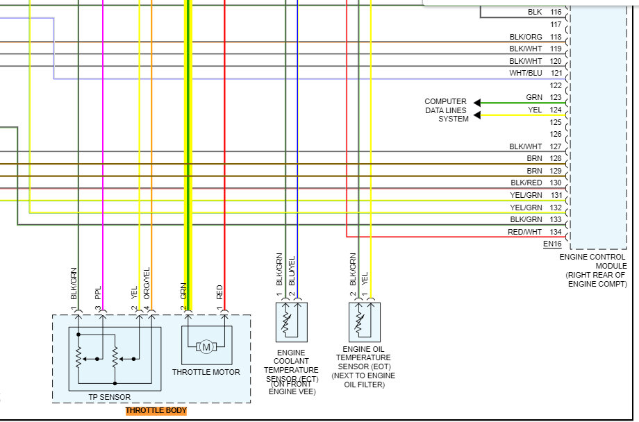

I had the plug on the bottom of the throttle body. It has a red wire and a green wire. The green wire touched the battery and sparked. Now it shows a message system fault and gearbox fault and will not throttle up. I’m wondering if it messed up the ECU.
Aug 19, 2023 at 4:52 AM
  • 110,244 POSTS

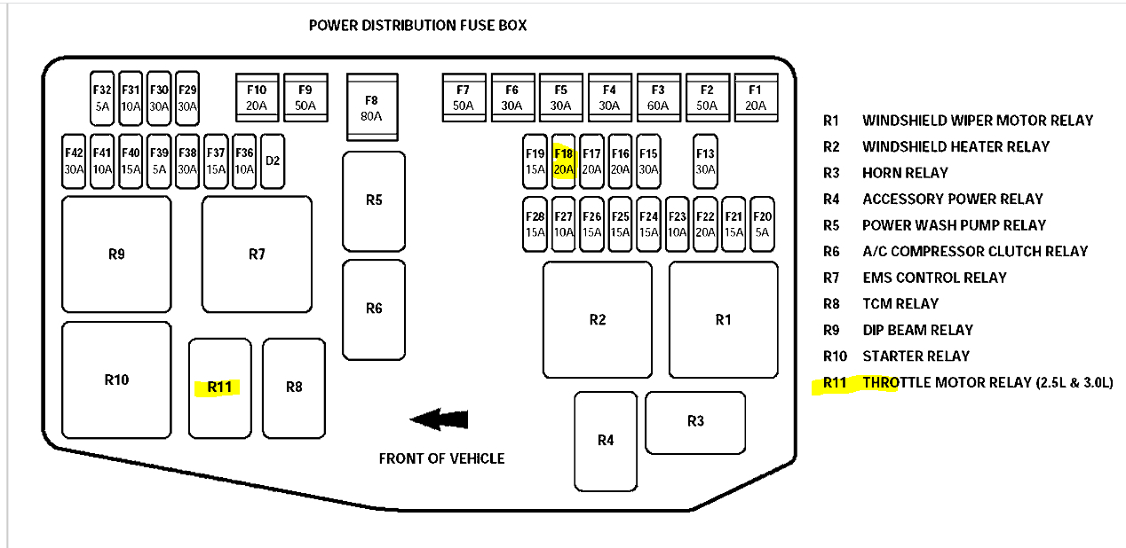

The green and red wires control the throttle motor. If you shorted it, it should have caused fuse 18 in the under-hood fuse box.
I attached two pics below. The first one shows the wires I believe you are referring to. The second shows the throttle motor fuse and relay located in the power distribution box (fuse box) in the engine compartment.
If the fuse appears to be good, confirm there is power to and from it.
Let me know what you find,

I have power to the fuses, and I switched the relay out and still no change before when I turned on the ignition switch, I could hear things clicking and I hear nothing now.

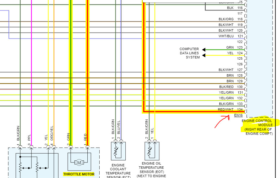

Did you check the red wire as well for power?

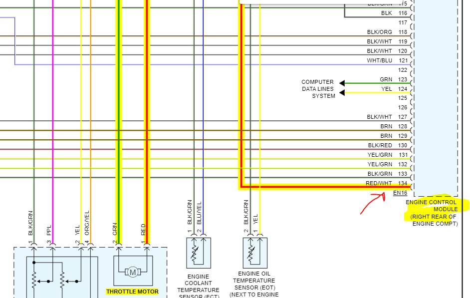

Let me know. The red wire also comes from the ECM. Please check that first and confirm the red wire with a white tracer at the ECM is powered. see pic below.
See pic below.
