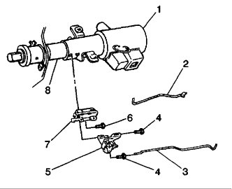

When i turn ignition to off car stays running not all the time but alot of the time. Sometimes will turn off in neutral. Have to disconnect hot cable from battery then turn off. Still drawes power sometimes if it does cut off what's going on?

Based on your description, it sounds like the switch itself is bad. The ignition switch is an electrical component and not the key tumbler/cylinder. Here are directions for replacing the component:
IGNITION SWITCH
Removal Procedure
Caution: Refer to SIR, Caution in Service Precautions.
Disable the SIR system. Refer to Disabling the SIR System in Restraint Systems.
Remove the instrument panel driver knee bolster and deflector. Refer to Knee Bolster Replacement - Left in Instrument Panel, Gauges and Warning Indicators.
Ensure that the following components are in the LOCK (1) position
The steering column lock
The ignition cylinder
Remove the steering column upper support nuts from the steering column support. Refer to Steering Column Replacement.
Remove the steering column dash cover bolts.
Remove the lower column (8).
Remove the brake switches.
Remove the electrical connectors from the dimmer switch (5).
Remove the electrical connectors from the ignition switch (7).
Remove the bolts/screws (4).
Remove the dimmer switch (5).
Remove the Bolt/Screw (6).
Disconnect the ignition switch actuator rod (2).
Remove the ignition switch (7).
Remove the automatic transmission park lock cable, if equipped.

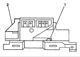

Installation Procedure
Install the automatic park lock cable, if equipped.
Complete the following steps in order to ensure that the ignition switch (2) is in the LOCK (1) position:
2.1. Move the switch slider to the extreme right position.
2.2. Move the slider one detent to the left.
Ensure that the following components are in the LOCK position:
Install the ignition switch (7) to the jacket (1).
Install the ignition switch actuator rod (3) to the ignition switch.
