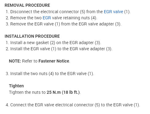

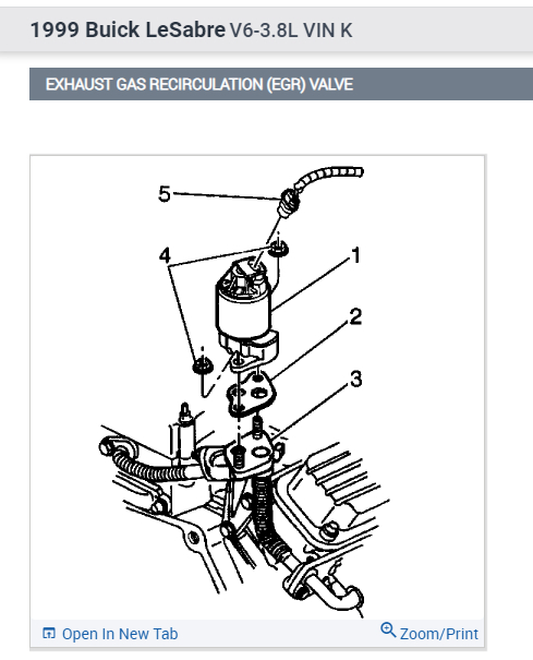

Thanks for the update. I'm glad to know you found the issue. I don't know if you need them or not, but I attached the directions for replacing the EGR on your vehicle. I hope they help.
See pic below.
