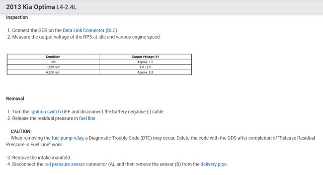

Car starts then shuts right off, Check Engine Light on and throwing the P0088 code. Engine was completely replaced few months ago after seizing up.
Dec 22, 2022 at 2:56 AM
  • 55,743 POSTS

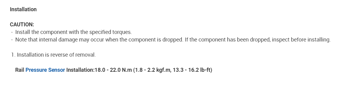

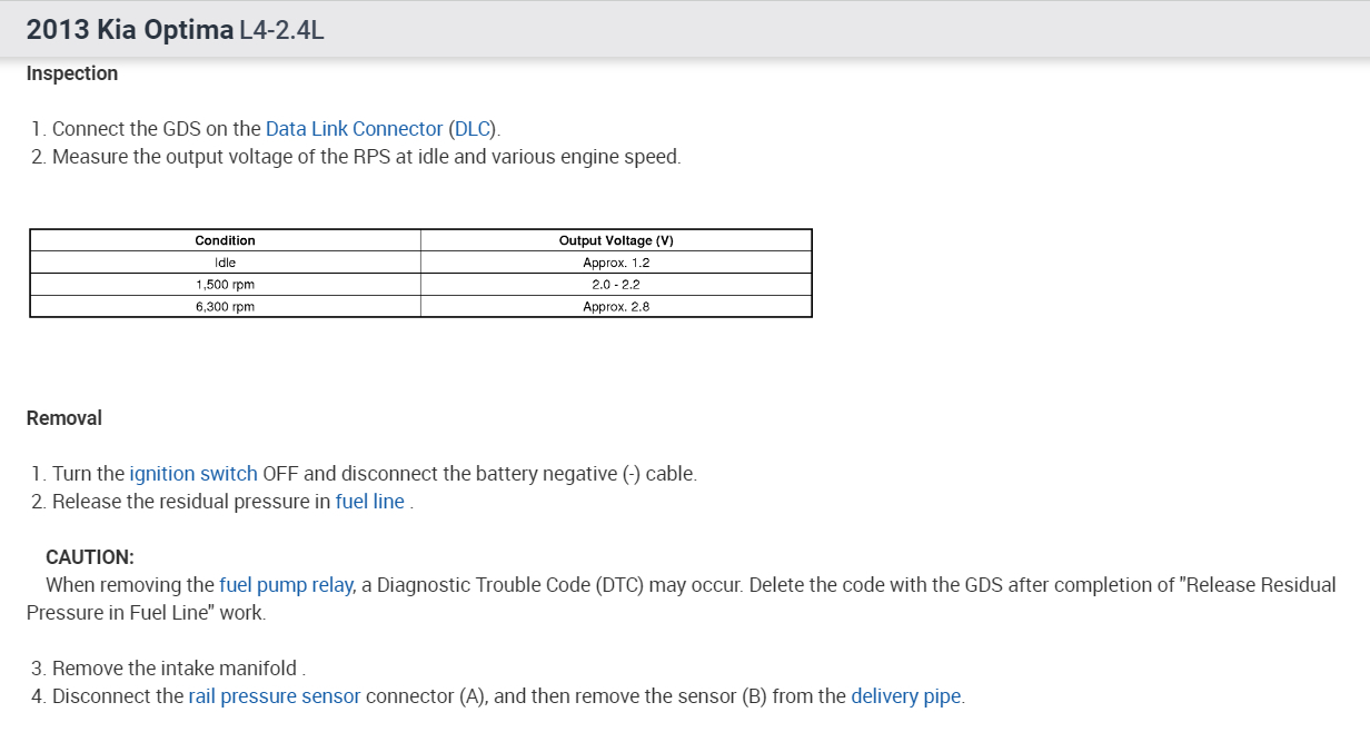

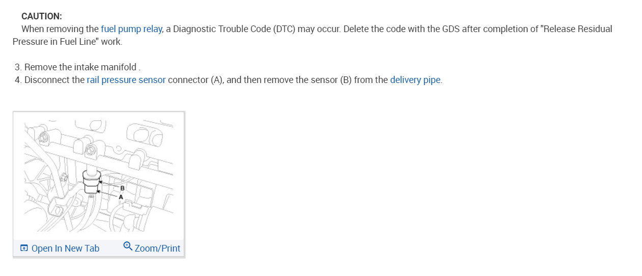

P0088 Fuel Rail System Pressure is Too High. This usually is the pressure sensor on the rail or the high-pressure fuel pump that has gone out. I would do the sensor first which is under the intake manifold. Here are the instructions for the repair. Check out the images (below). Please let us know what you find.
