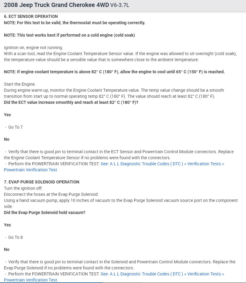

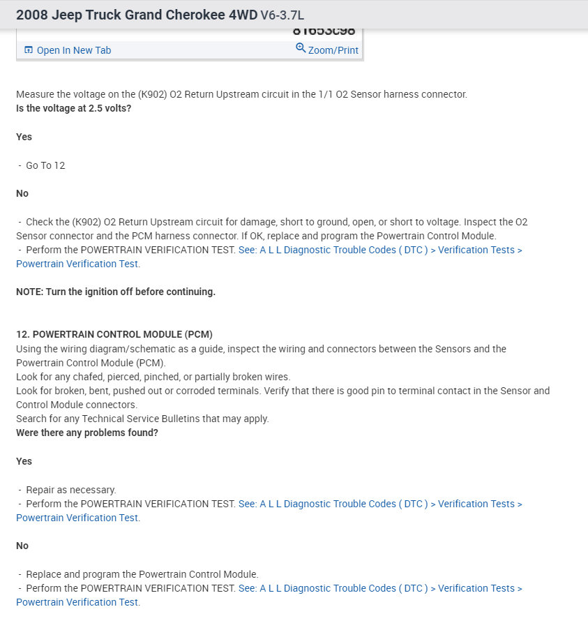

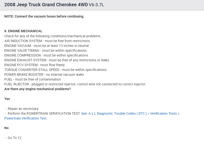

Vehicle won't run, idle keeps shutting off and throwing code Po174 and Po172 codes. Can someone steer me in the right direction to get this truck running again.
Mar 14, 2022 at 4:30 PM
SQM
  • 6,383 POSTS

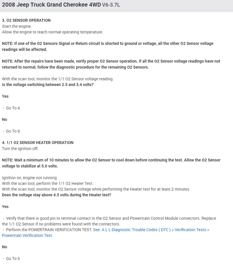

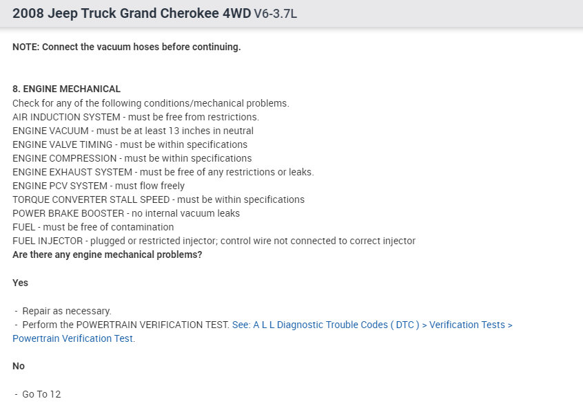

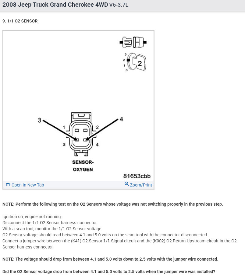

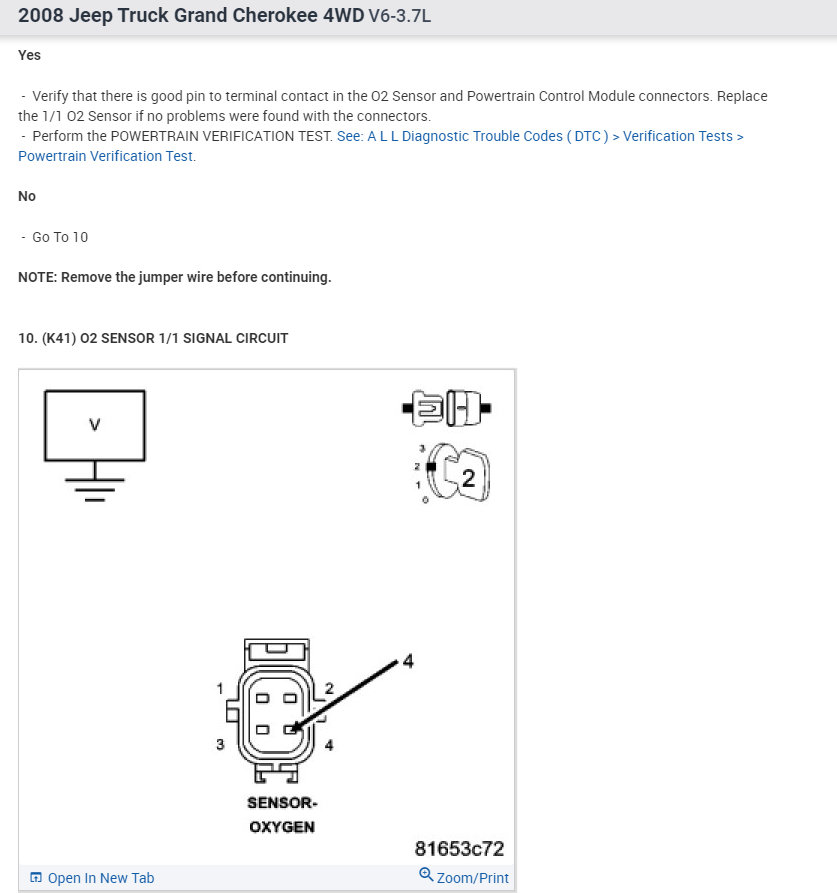

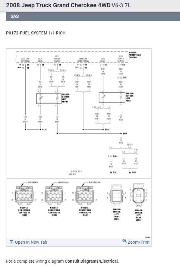

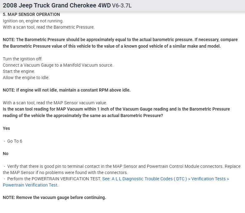

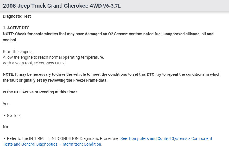

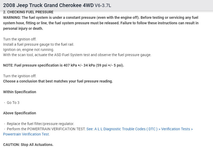

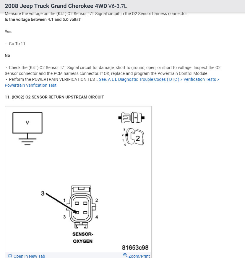

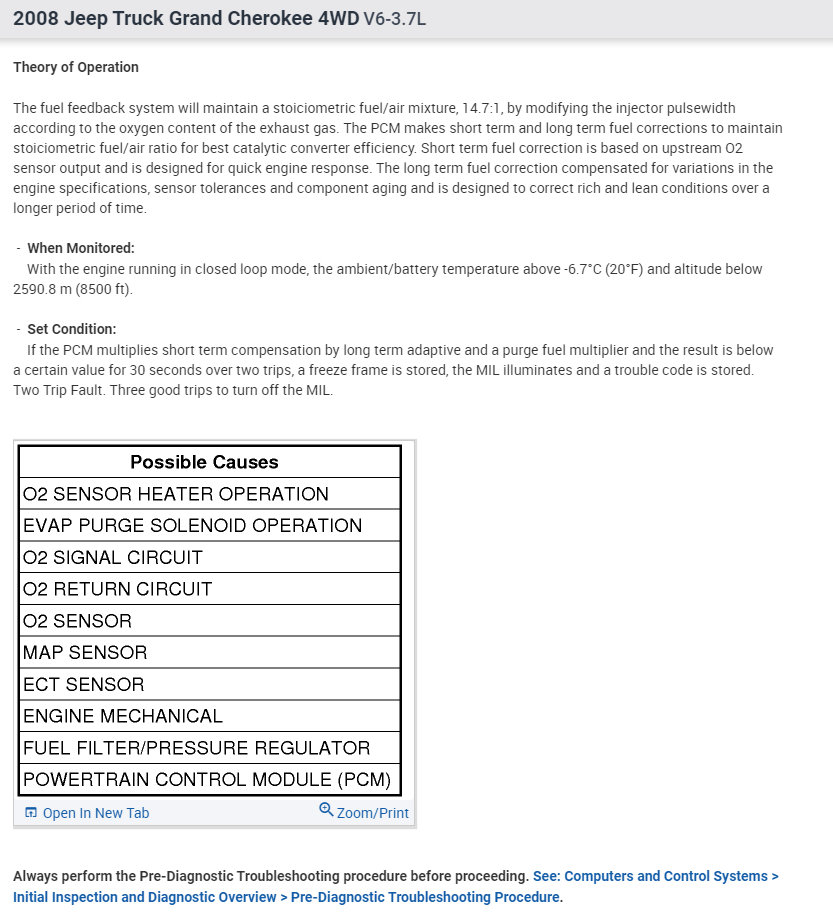

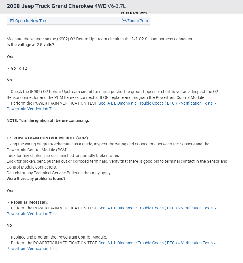

These codes are both fuel related, both rich and lean code.
It could be caused by faulty oxygen sensor, bad MAP sensor, issue with fuel pressure regulator, EVAP purge solenoid operation, engine coolant temperature issue. It can also be due to an issue with the PCM.
I have attached the trouble shooting steps for these codes below. Follow the guide and it can help you determine what is the issue.
