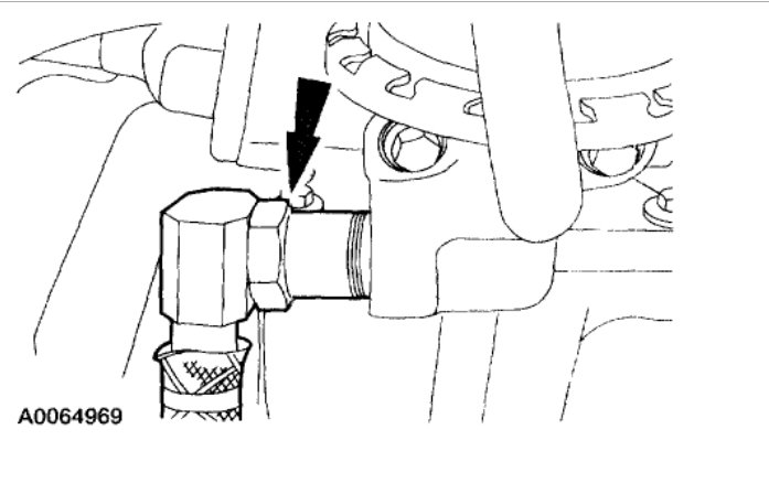

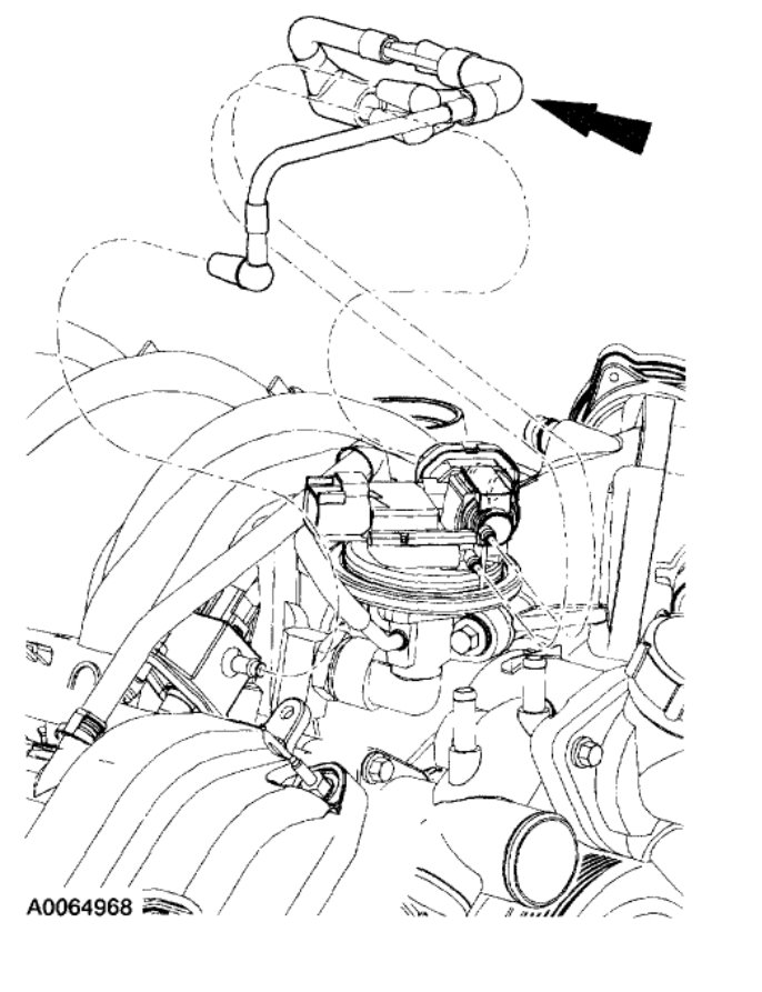

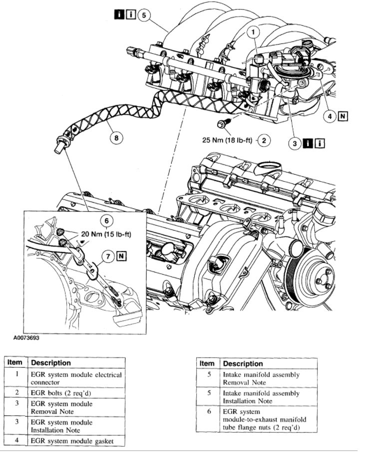

Next would be a stuck EGR valve which will allow the intake of the engine to be mixed with exhaust causing the engine to stall at idle as well.
https://youtu.be/DqUCbbKdWf4
This guide can help also.
Below are some diagrams of how to remove the EGR valve on your car.
Please run this test and get back to us.
