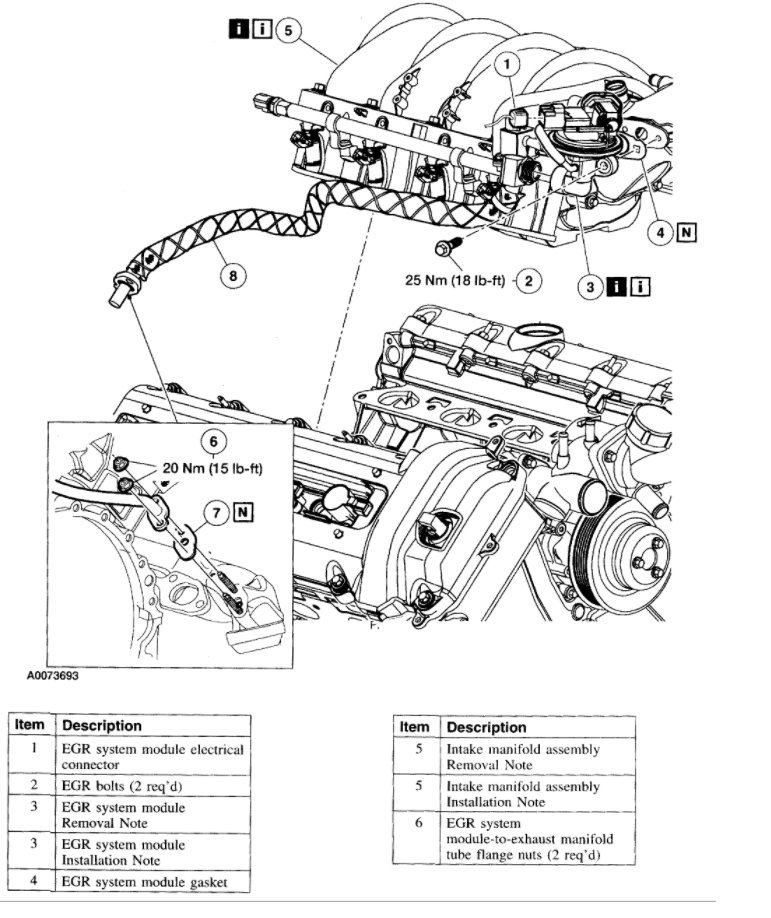

It will start but will not stay running. We have replaced the fuel pump and filter. Ignition coils, throttle body and spark plugs. It is not reading any codes.
Nov 5, 2017 at 1:42 AM
  • 55,433 POSTS
Two things come to mind that will cause this problem. The first would be a vacuum leak which will cause the engine to stall at idle.
Here is a guide to help you confirm the problem:

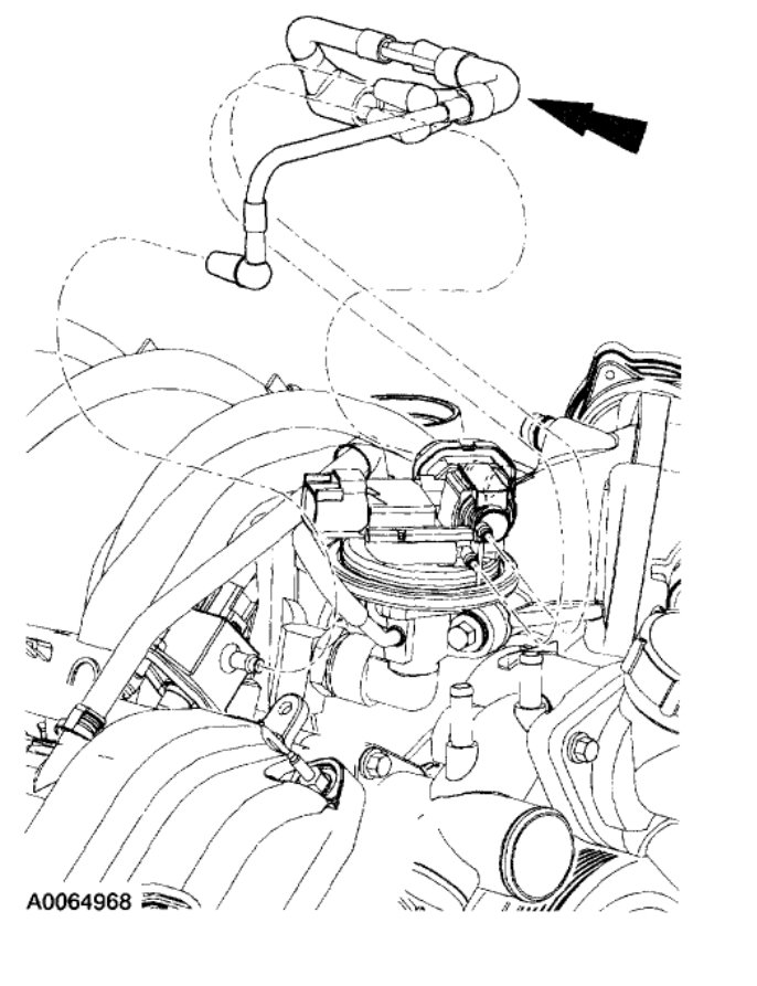

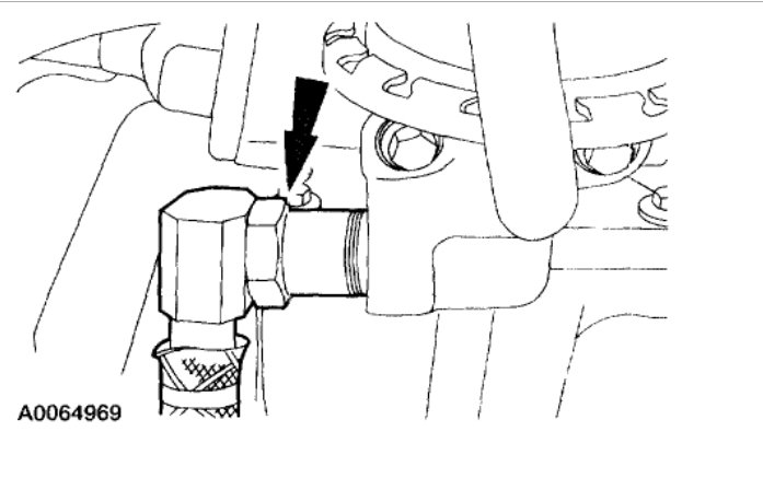

Next would be a stuck EGR valve which will allow the intake of the engine to be mixed with exhaust causing the engine to stall at idle as well.
https://youtu.be/DqUCbbKdWf4
This guide can help also.
Below are some diagrams of how to remove the EGR valve on your car.
Please run this test and get back to us.
