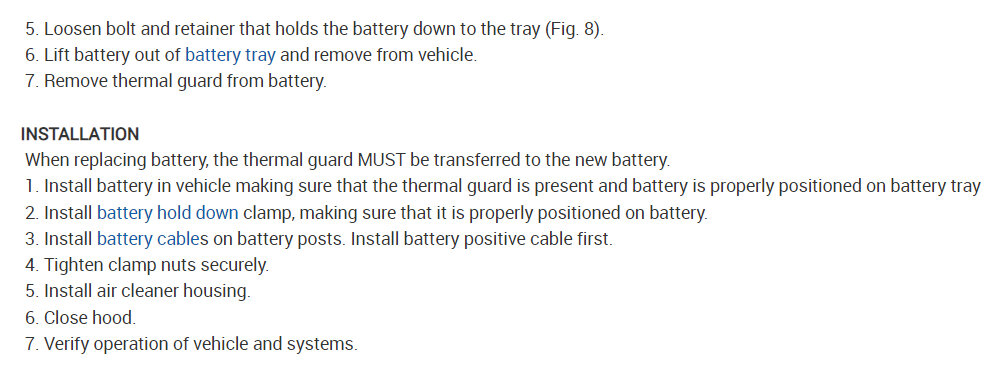

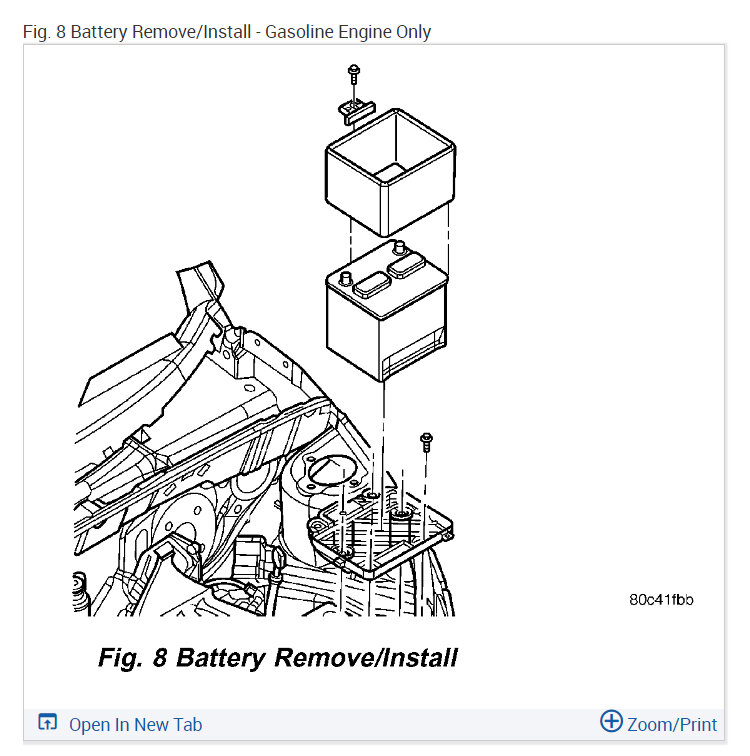

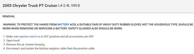

It sounds like the battery is no good, I would remove it to have it tested at the auto parts store.
Here is a guide to help with instructions below to show you how on your car:
https://www.2carpros.com/articles/how-to-replace-a-car-battery
Check out the images (below). Please upload videos in your response to the problem so we can see what's going on.
