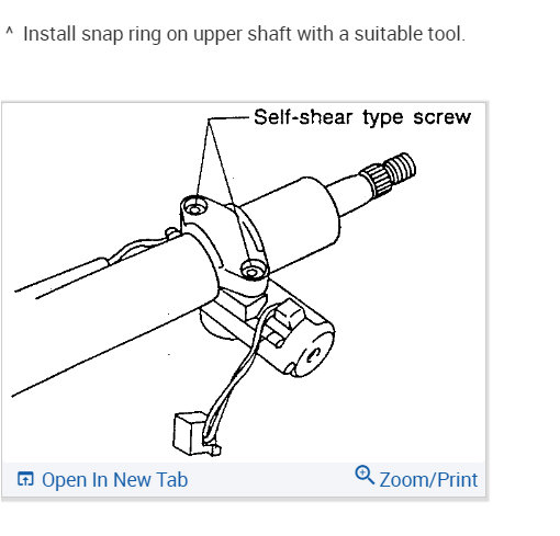

It will start but won't stay running without the starter circuit on. I let go of the key and it shut off immediately.
Sep 6, 2022 at 3:48 AM
  • 55,746 POSTS

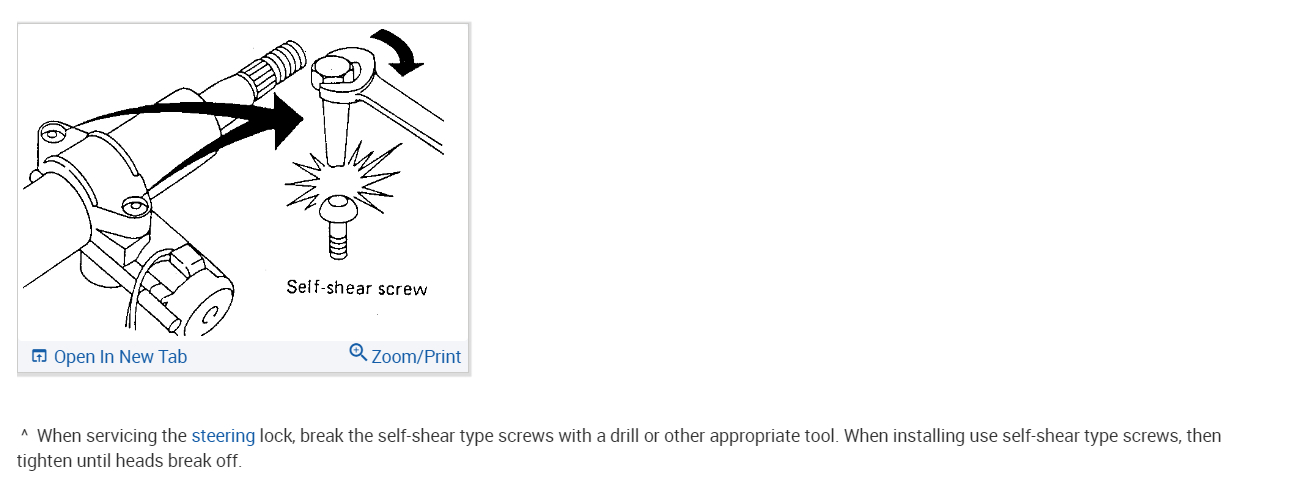

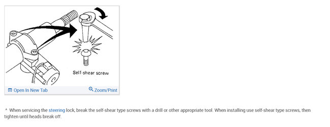

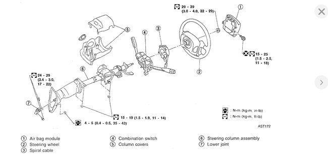

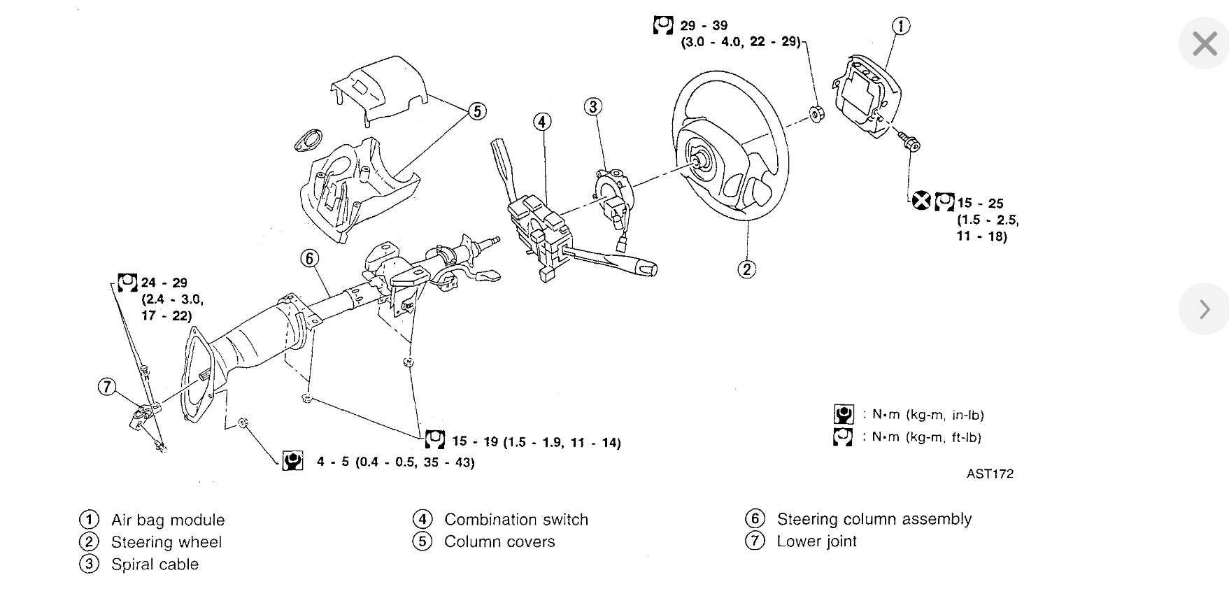

This sounds like an ignition switch has gone bad, here are the instructions to change it out in the images below. Check out the diagrams (below). Let us know what happens and please upload pictures or videos of the problem. If your car has airbags disconnect the battery before you begin.
Sep 7, 2022 at 2:27 AM
AUBURNNUT
Thanks, you were right on!! A new switch fixed it!! Love this site!!
