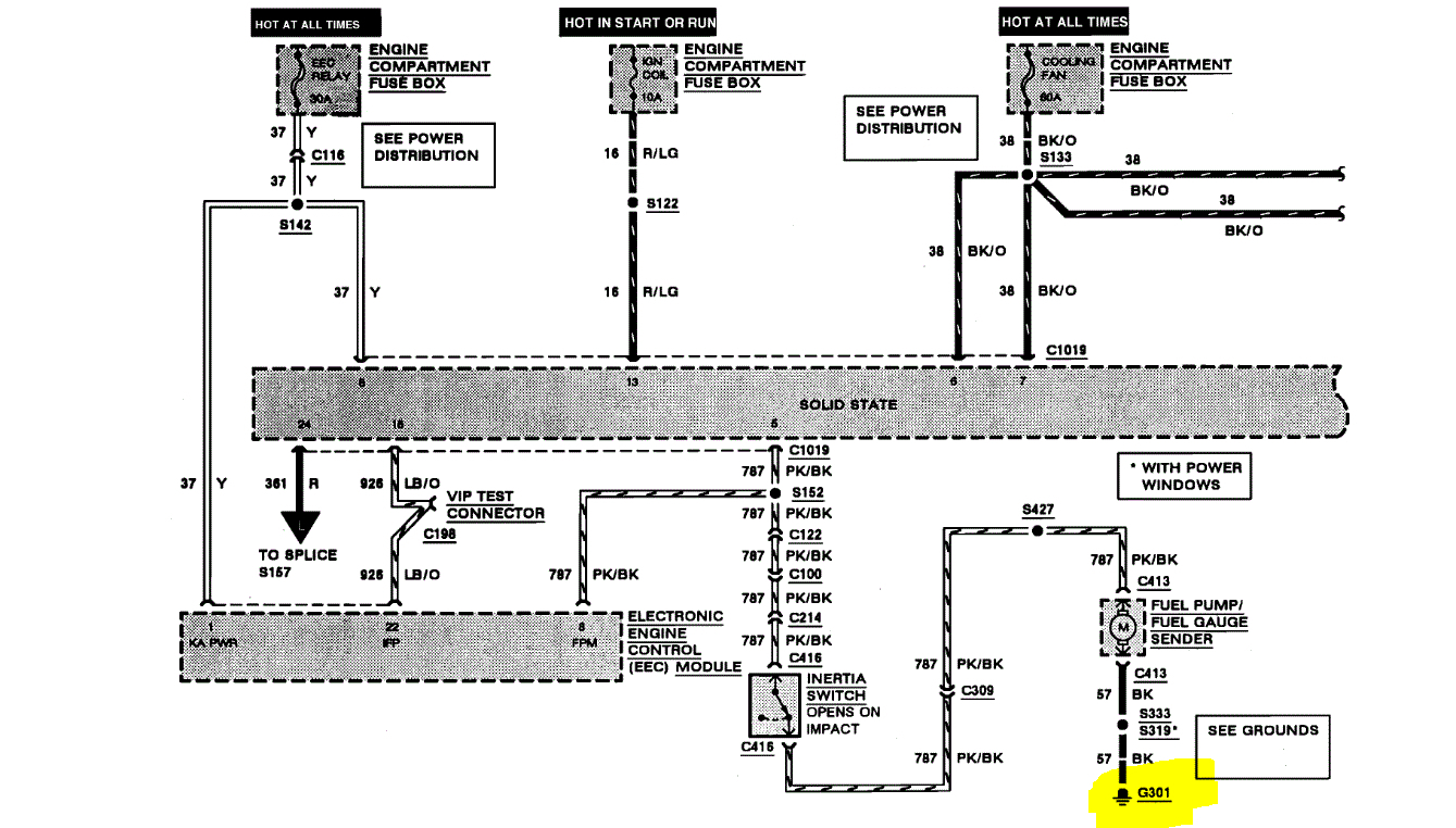

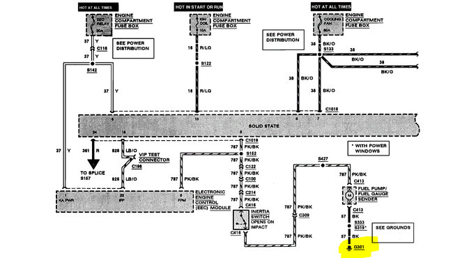

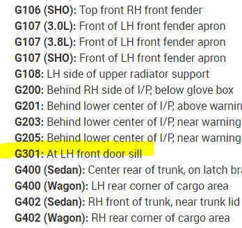

Car will start and runs fine in park. Shift it in to gear and it stalls. I'm thinking it's a fuel pump issue and wanted to check the ground wire for it (like in older models) but wanted to find out the location of it before I go taking things apart and it not being where I thought it should be.... Any ideas?
Sep 13, 2020 at 11:32 AM
  • 110,248 POSTS
If you look at pic 1, it shows the pump ground is G301. If you look at pic 2, it show the location of the ground.
