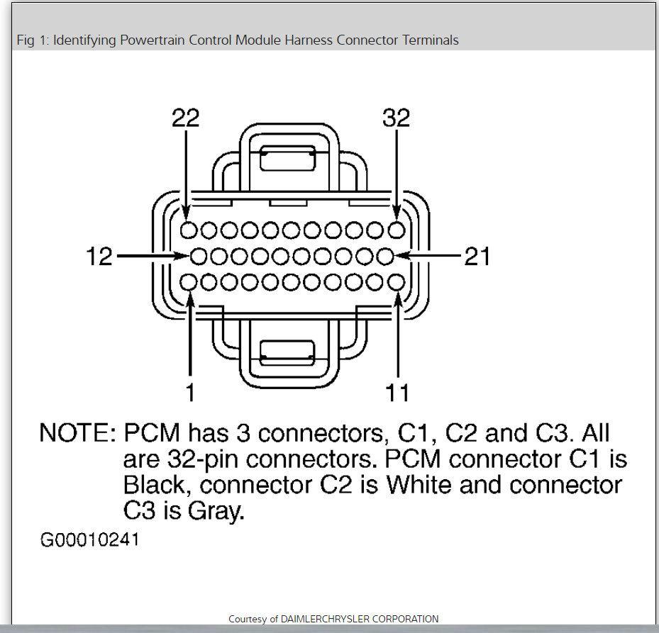

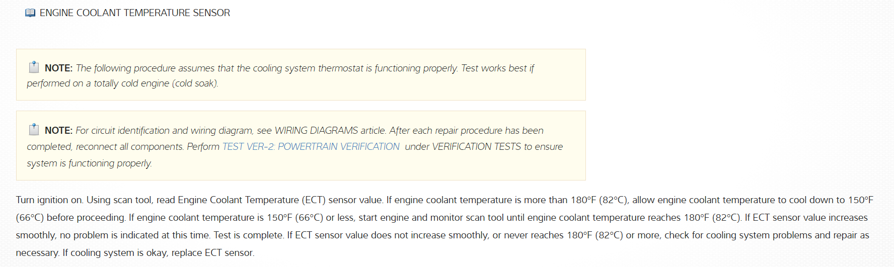

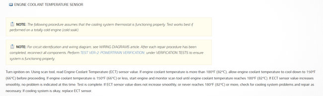

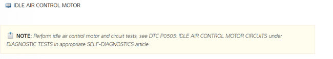

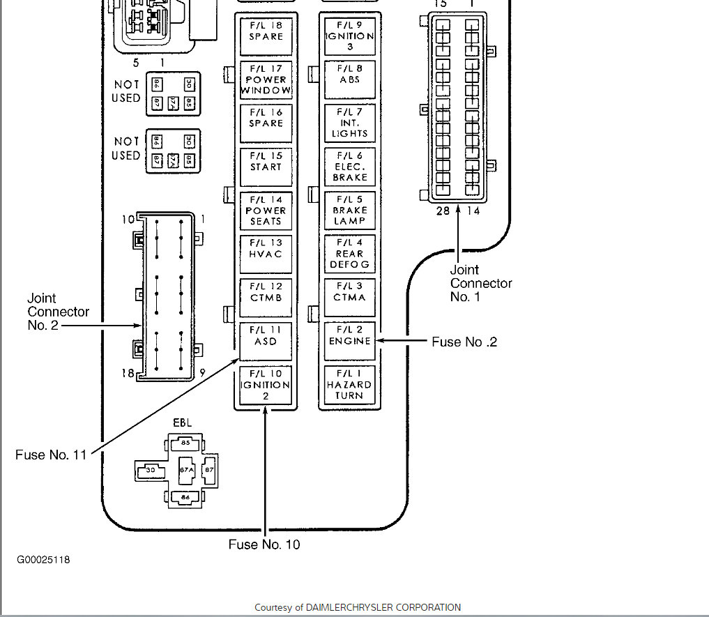

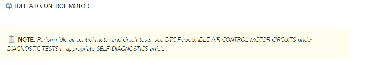

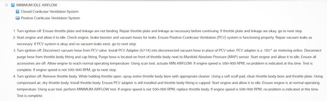

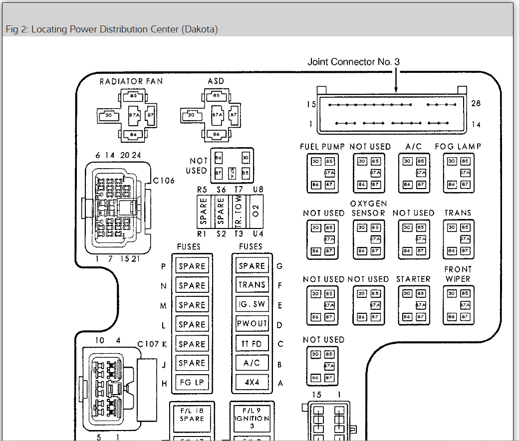

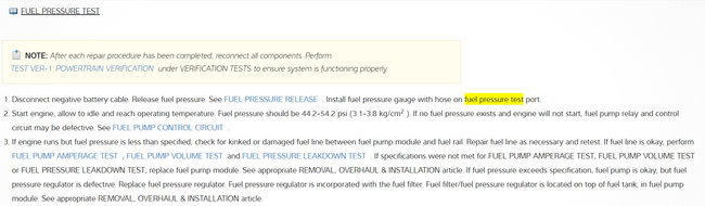

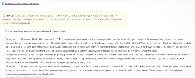

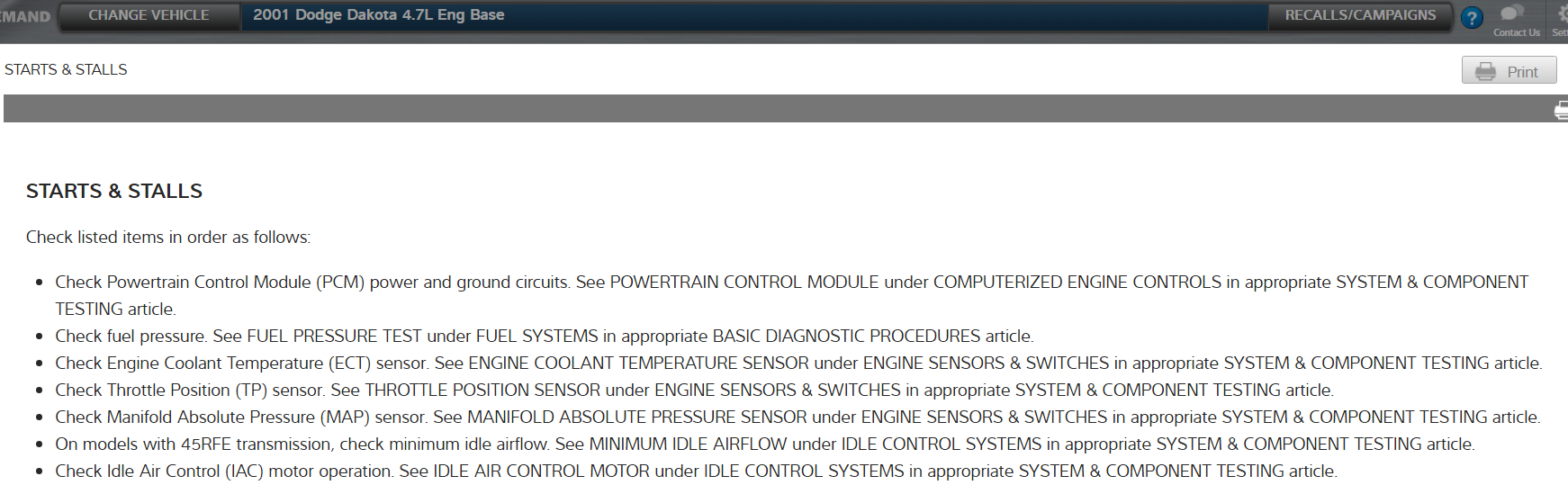

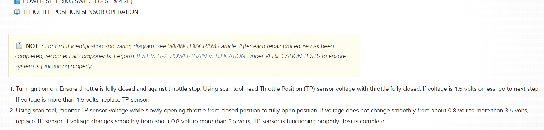

I can start the truck if I give it gas but once I let off the gas it shuts off. I have replaced the throttle position sensor and the idle air control valve and still nothing.
Mar 4, 2019 at 2:23 PM
SCGRANTURISMO
  • 4,897 POSTS

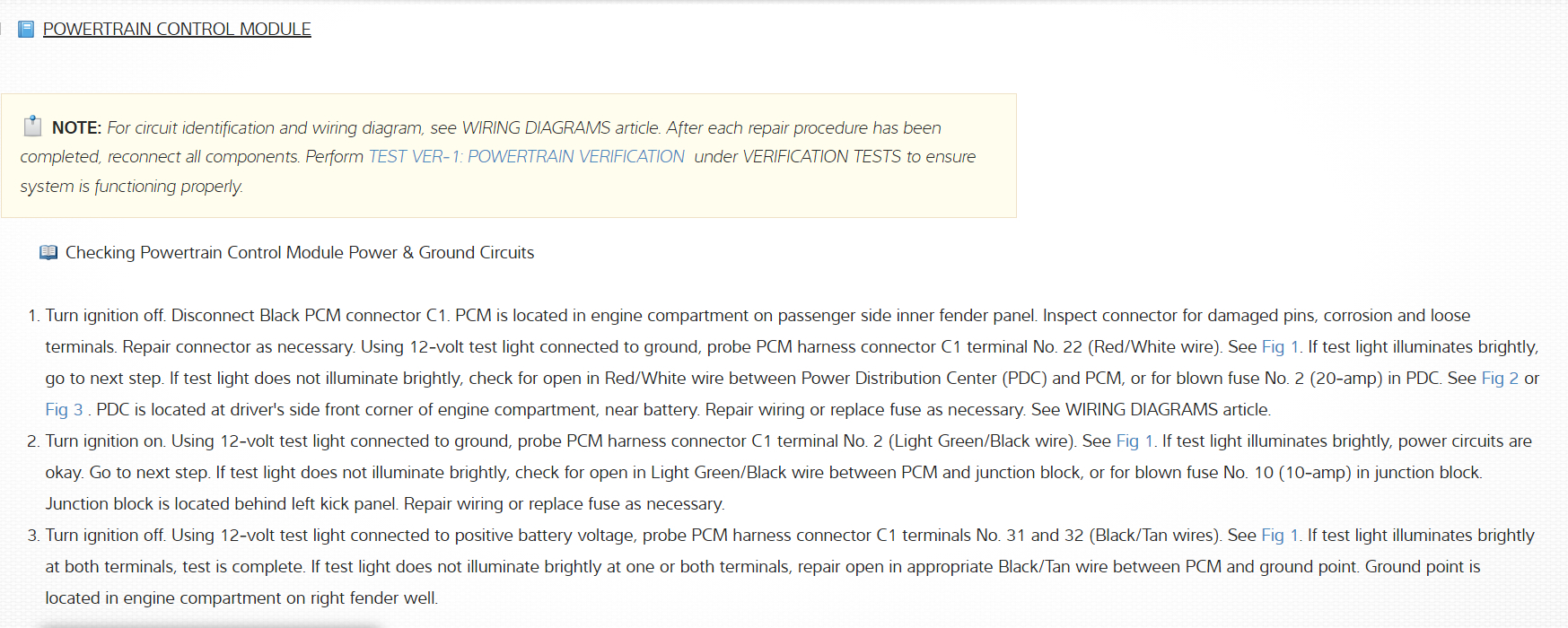

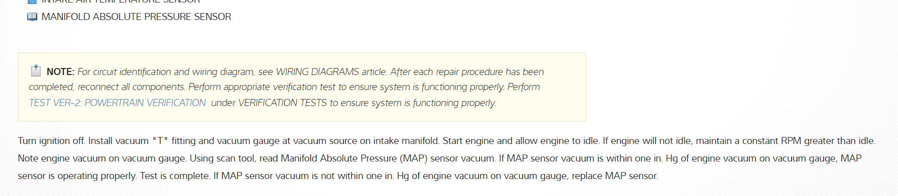

There is a variety of things that might cause this. It could be a problem with your Manifold Absolute Pressure (MAP) sensor. But to make sure I have included a troubleshooting diagnostic chart for you in the diagrams down below. Please go through it and get back to us with what you find out.
Thanks,
Alex
