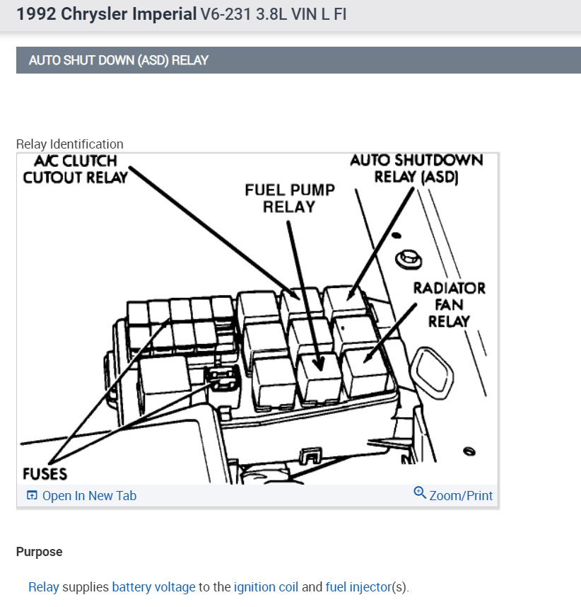

Hello, this sounds like an auto shutdown relay is not working correctly. Here is a guide to help test it with the relay location in the diagrams below:

CLINT NIGG
  • 5 POSTS
We had checked that and even bypassed it. The noid comes on for a second then stops, the car will crank but never fire again unless I turn the key to off then if try to start again car fires once, still has spark and if I squirt fuel in intake it will run, but noids are not lit.

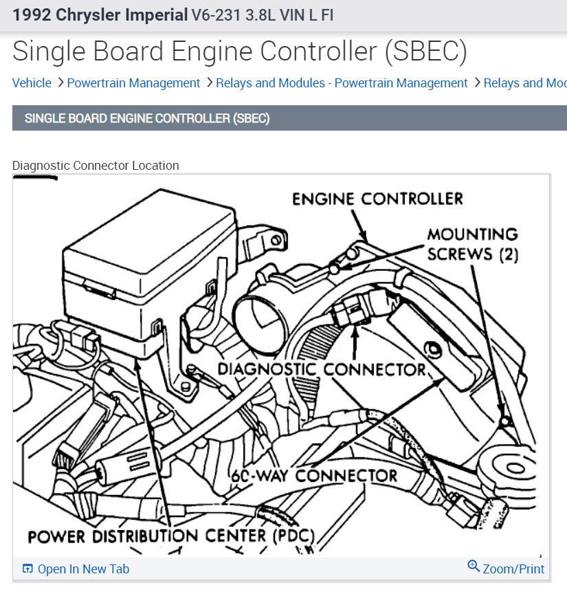

Yep, this sounds like the engine computer is bad which was common, here is how to replace it and the location in the diagrams below.
Removal
1. Remove air cleaner duct from PCM.
2. Remove battery.
3. Remove mounting screws.
4. Remove wiring connector from the PCM.
Installation
1. Connect wiring connector to PCM.
2. Install PCM and tighten mounting screws.
3. Install battery and connect cables.
4. Connect air cleaner duct to PCM.
Check out the diagrams (Below). Please let us know what you find.

CLINT NIGG
  • 5 POSTS
Replace the computer still doing the same thing we're checking the grounds to see if one is corroded.
