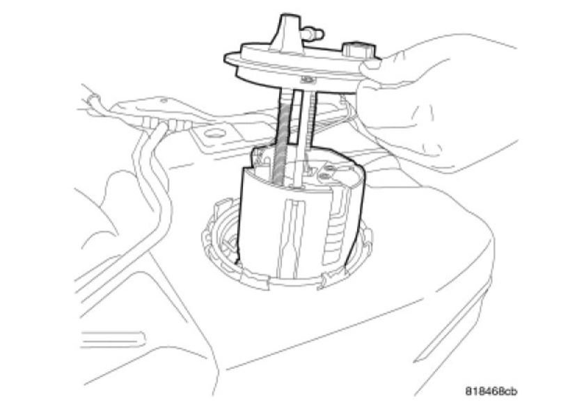

Good morning,
when you run out of fuel, you damage the fuel pump. Fuel keeps the pump cool and acts as a lubricant. When you run out of fuel, it is like running an engine without oil.
You need a new fuel pump.
