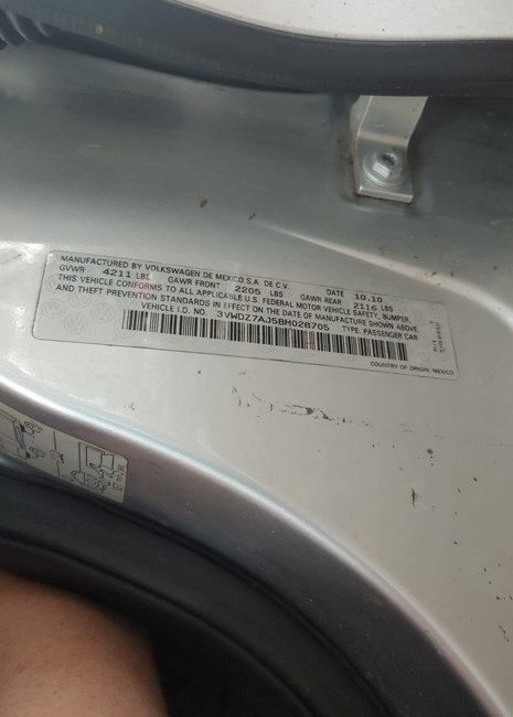

I will need to have the manufacturing date from the vehicle. VW loves to change fuse locations constantly. It should be on a label on the driver's side door frame.

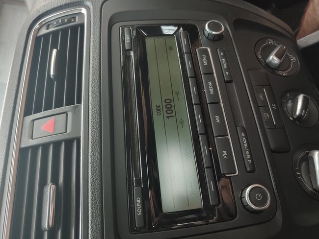

The radio now doesn't work, and i did not purchase this care brand new, and when i got it, there was no owner's manual to find the code.
I believe the manufacturing date is 10/10/2011.
I attached a video of the issue, and a picture of that lable in the door frame, along with a picture of the radio.

That's the date, but it's 10/2010. By 10/2011, the 2012 model year vehicles were being produced.
