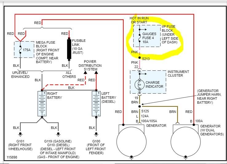

I changed alternator three times, replaced battery, tensioner, and belt. Drive for a little while until battery ran down. Please help!

You need to test the voltage at the battery to see if the alternator is working.
Monday, April 19th, 2021 AT 10:46 AM
ATHOMPSON
  • 6 POSTS
Yes alternator is working.
  • 52,797 POSTS
Okay, what is the voltage at the battery with the engine is running?
ATHOMPSON
  • 6 POSTS
Battery light indicate in middle when it's crank first as you driving battery meter goes down.
  • 52,797 POSTS
Got it.
Again, what is the voltage at the battery with the engine running?
ATHOMPSON
  • 6 POSTS
14 volts.
  • 52,797 POSTS
Okay, that is the correct voltage.
You say that the voltage drops while it is running?
What kind or brand alternators are you using?
ATHOMPSON
  • 6 POSTS
It begins to drop after five to ten minutes while driving, not sure what kind nor brand. However, I can find out.
  • 52,797 POSTS
Please do. It sounds like the alternator.
ATHOMPSON
  • 6 POSTS
Okay, but I have replaced it twice and the alternator I have now was tested at the place of purchase.
  • 52,797 POSTS
Okay, then you need to check the connectors on the alternator to be sure they are clean and tight. There may be corrosion in the connectors.
