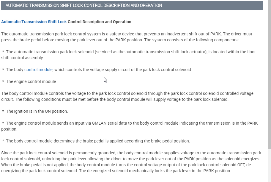

My vehicle listed above will not start and seems to be stuck in park.I managed to get the shifter into N briefly, and it started.Had to put back into park. now it will not budge. Have to force the Park to get key out.
Oct 22, 2019 at 8:05 AM

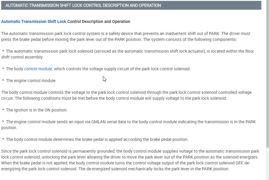

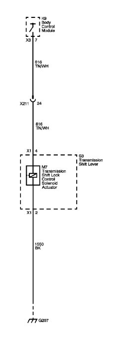

More than likely the shift lock solenoid is failing. I attached the description on this system. When you press the brake pedal the BCM sends a signal to the solenoid to release it.
Unfortunately this is pretty common so there are a lot of videos online of people repairing this.
If you can't repair it then the shifter will need to be replaced.
Let me know if you have questions. Thanks
