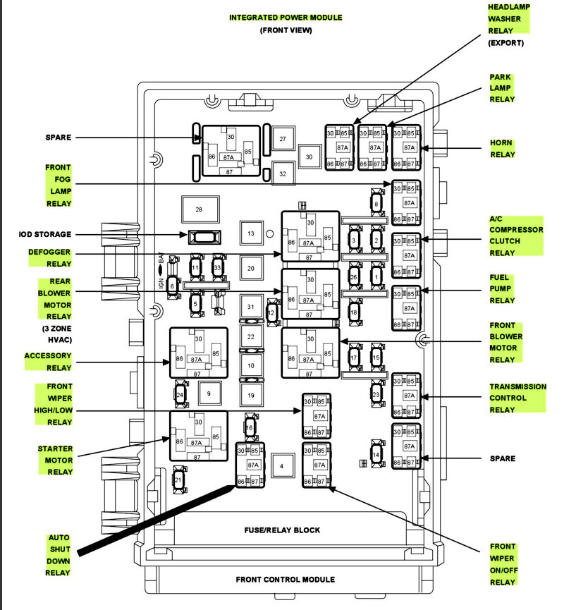

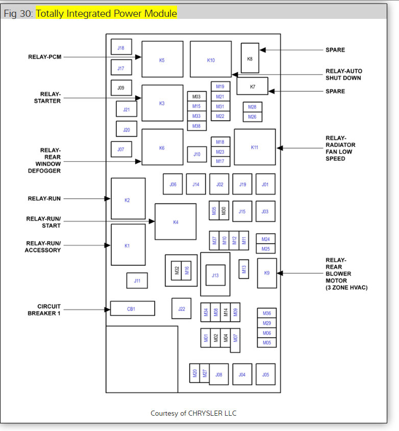

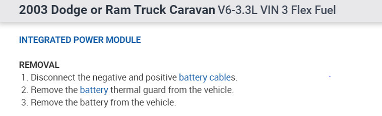

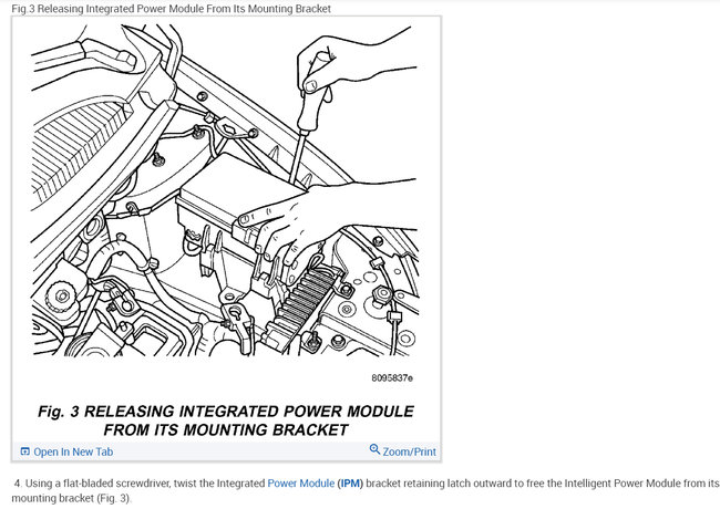

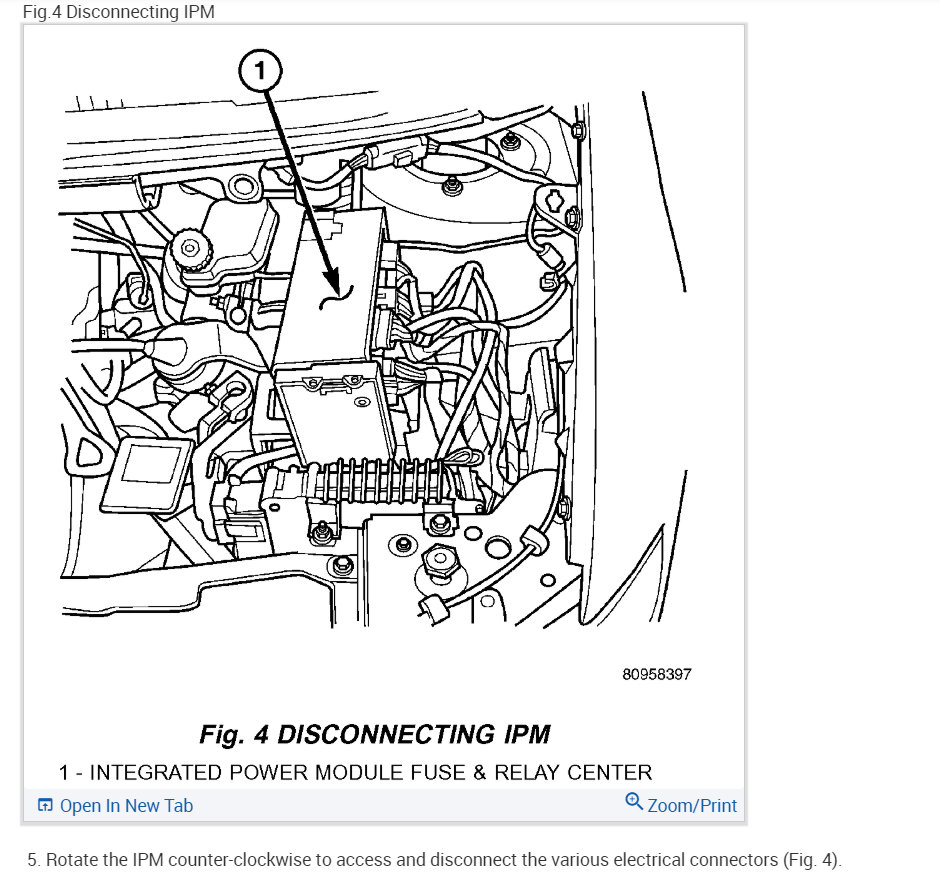

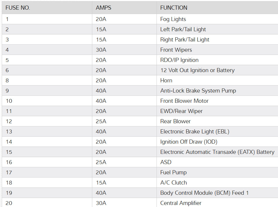

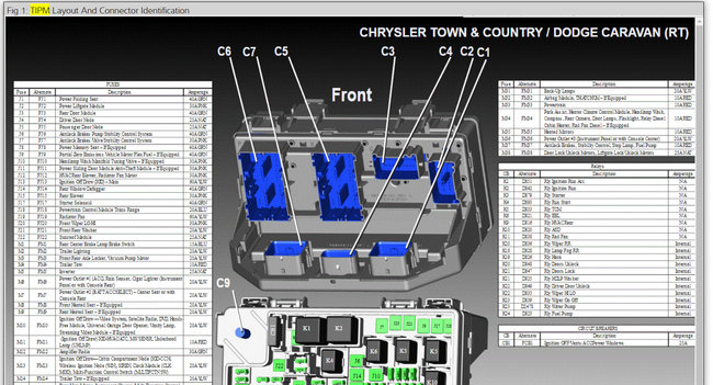

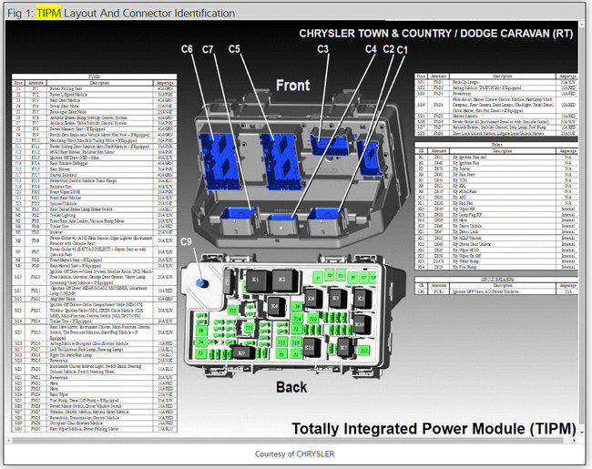

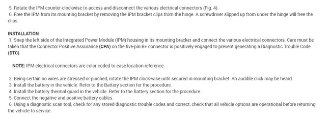

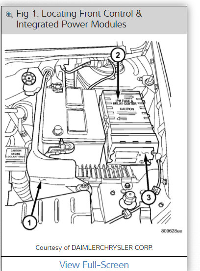

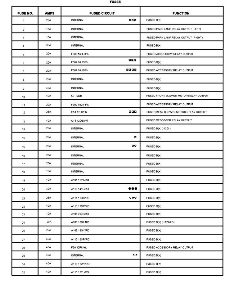

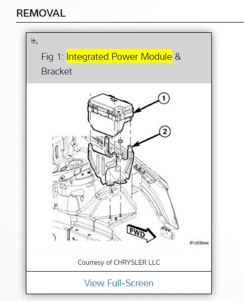

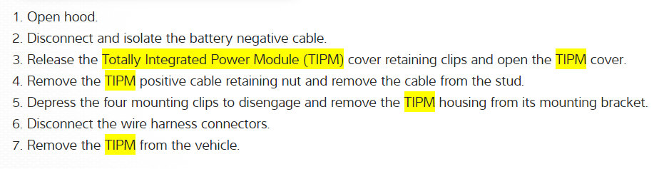

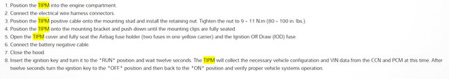

Can you try the scanner on another car to confirm it is working please? Also is the security light flashing? To me it sounds like the TIPM is out but to be sure lets check the fuses here is a guide and the fuse locations so you can get started.
I have included the TIPM replacement instructions as well just in case. It is easy to replace because it self initializes. Check out the diagrams (Below). Please let us know what you find. We are interested to see what it is.
Jul 22, 2019 at 7:59 AM
FUNMONEYPIT
  • 14 POSTS

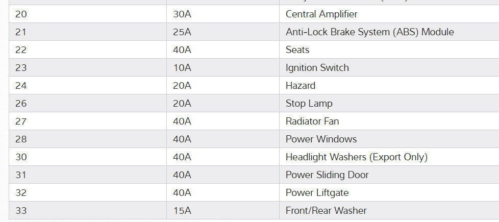

Per my original post, I did try the scanner on another car and it worked fine (second to last sentence). All fuses are also good. I will review the procedure. Thanks

  • 55,381 POSTS
Yep, the TIPM causes all kinds of weird issues. Let me know if you replace it.

Can I use any TIPM from a 2008 T&C or do I have to match the numbers?
Jul 24, 2019 at 9:33 PM
  • 55,381 POSTS
You need to match the numbers because there are production changes which will effect the operation.
Jul 26, 2019 at 2:48 AM
FUNMONEYPIT
  • 14 POSTS

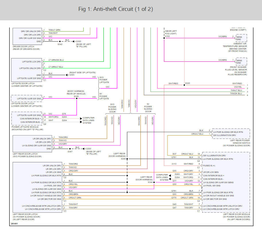

Thanks again for all your help. I did try a known working TIPM that matched mine (same year with the correct number from a friends running van). It still does the same thing. Security light flashes and it won't start. I did talk to my mechanic and he said I have to get the security light reset at the dealer. I just can't believe there isn't a way to do it on my own. I have tried all the ways on the guide you provided.
Any other ideas?

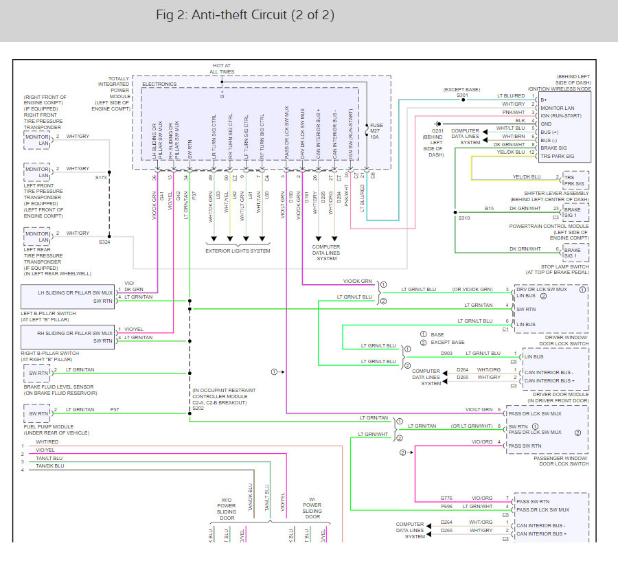

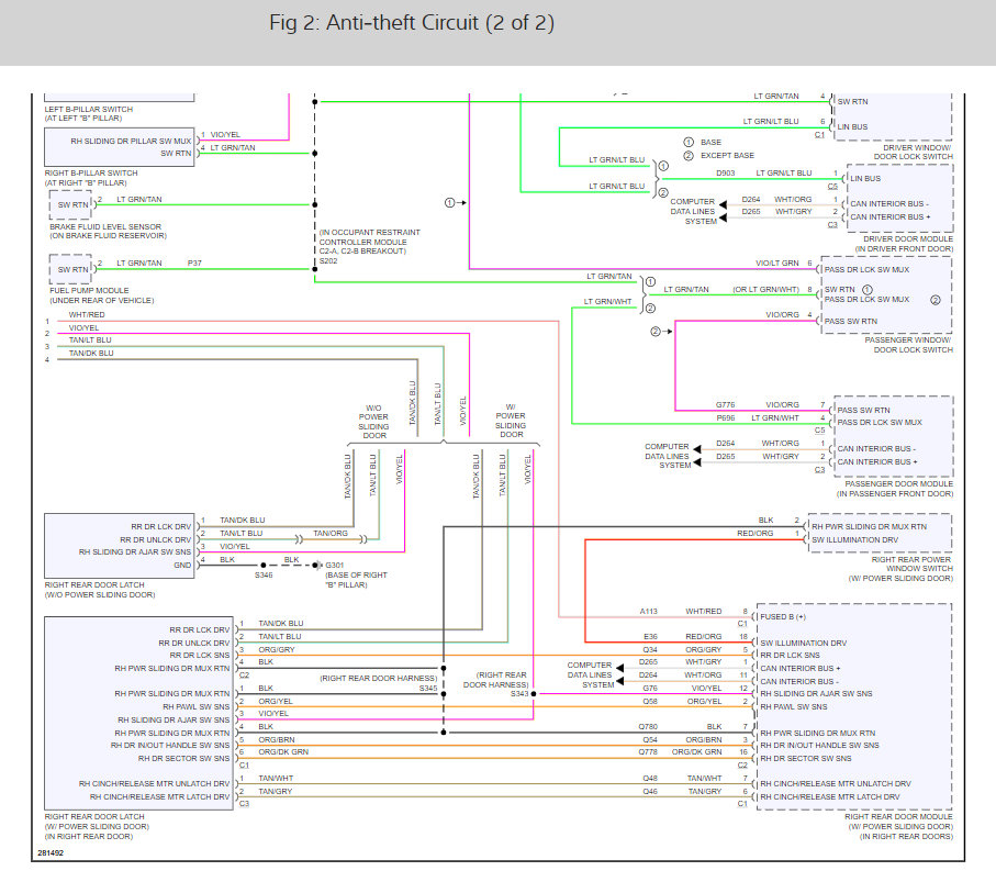

  • 55,381 POSTS

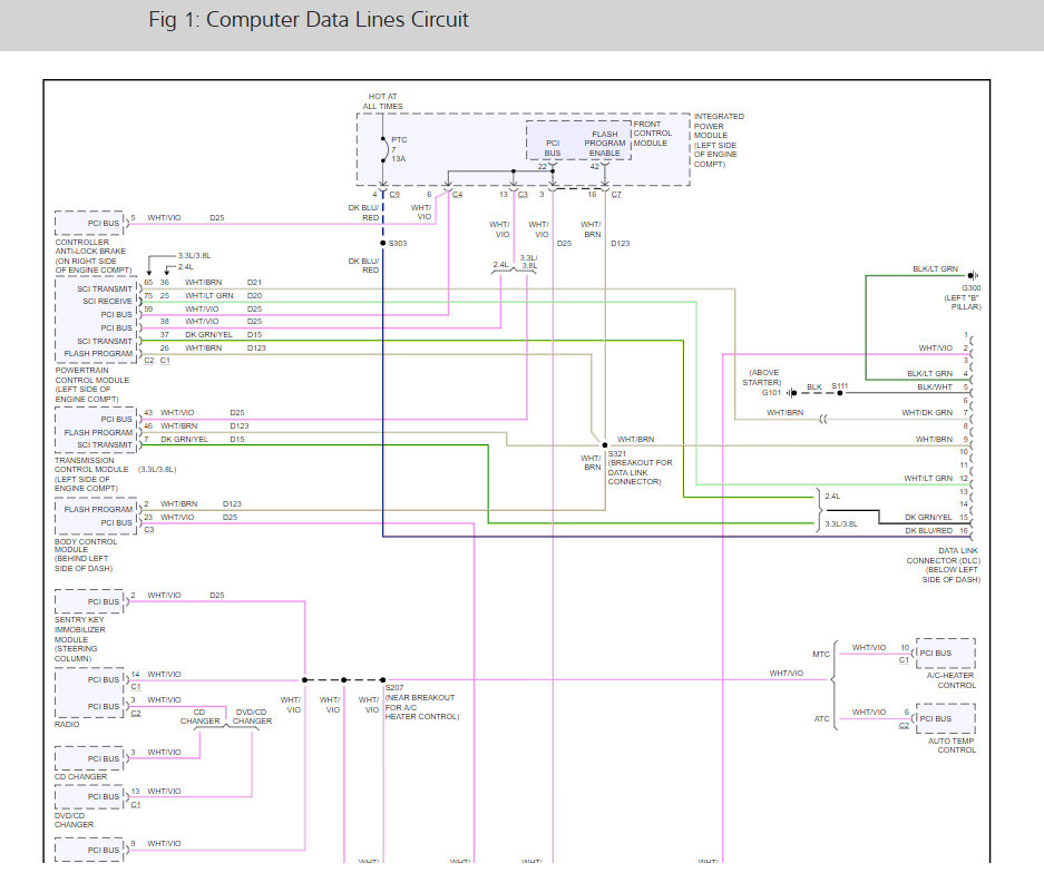

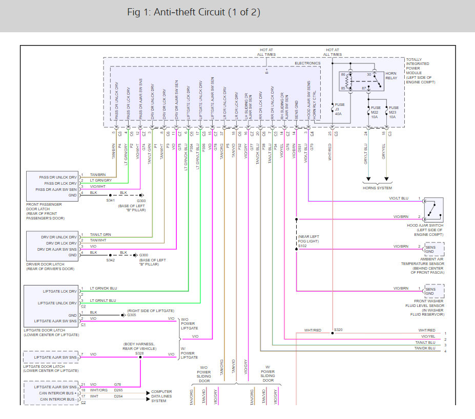

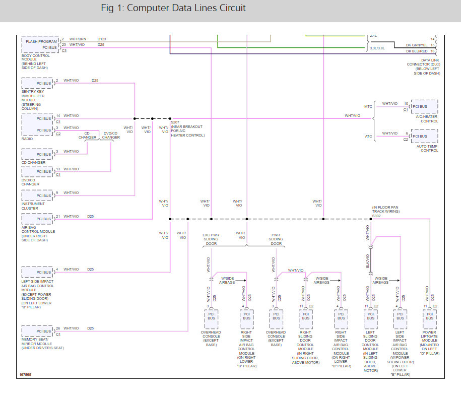

Here are alarm wiring diagrams to show you how the system works, we need to check for power at fuse j3, you your test light to see if there is power.
Jul 27, 2019 at 3:38 AM
FUNMONEYPIT
  • 14 POSTS
Are we sure the schematic is correct for a 2008 Town & Country? The box cover and manual says J3 is for the right rear door module. Also mine is a 30a and the diagram says it's a 40a. It does have power.
Jul 27, 2019 at 7:05 AM
FUNMONEYPIT
  • 14 POSTS
Okay, looking further, J3 is for both rear doors. The manual actually states 40a but the TIPM cover states 30a. There is a 30a 8n the box. Following the wire diagram supplied, J3 goes to both rear doors so thinking this is not the alarm circuit.
Jul 27, 2019 at 8:26 AM
  • 55,381 POSTS
Hmm, I think we should do a CAN scan to see what it brings up, here is a video that will show you how. They have CAN scanners on Amazon FYI.
https://youtu.be/InIlnsjOVFA
Those right the correct wiring diagrams as well. Let me know

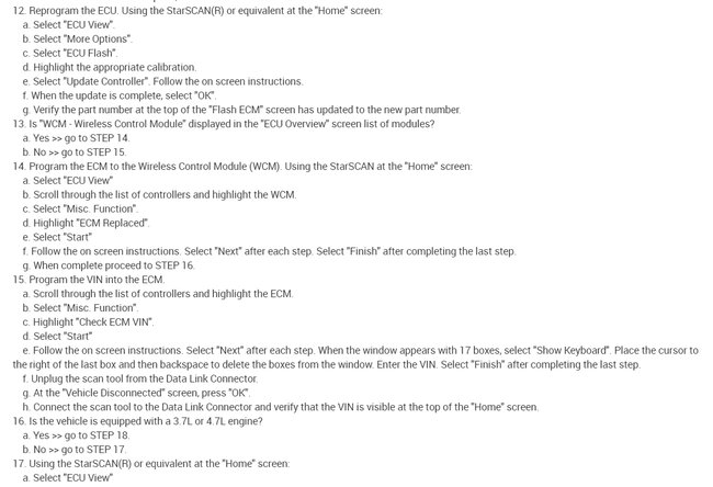

  • 14 POSTS

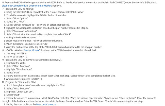

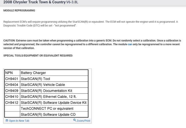

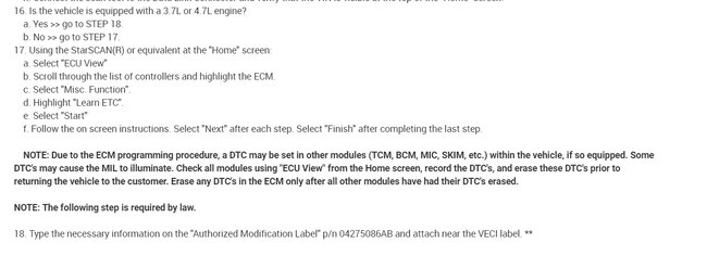

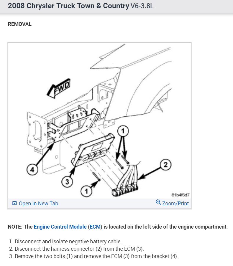

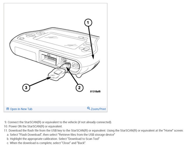

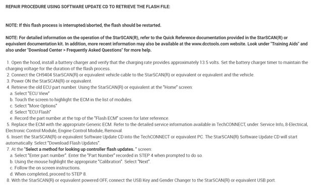

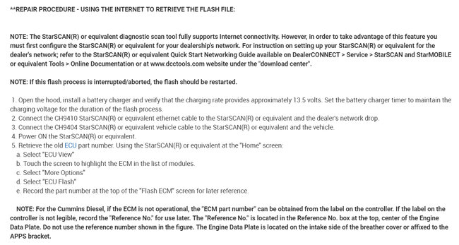

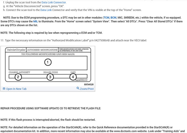

Well I gave up and took it to the dealer. They are saying the ECM is bad. Can you tell me where the ECM is located? They are saying they have to remove the bumper.
Jul 30, 2019 at 11:00 AM
FUNMONEYPIT
  • 14 POSTS
My research shows the ECM (or PCM) is located under the splash guard by the left front tire. Is this correct? Certainly wouldn't have to take off the bumper for that.
Jul 30, 2019 at 11:36 AM
  • 55,381 POSTS
I kind of had a feeling the PCM was bad, but I wanted us to go through the testing to be sure. here is the PCM location and the replacement instructions. Check out the diagrams (below). Please let us know what happens.
Jul 31, 2019 at 4:37 AM

If the fuses are okay here is the wiring diagrams for the ALDL you will see the TIPM runs the system which can be the problem which is common. Here is a guide to help check the connections and the TIPM replacement instruction so you can see how to replace it below.
Dec 26, 2020 at 3:04 AM (Merged)

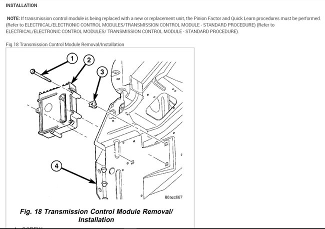

AMERICAN CITIZEN

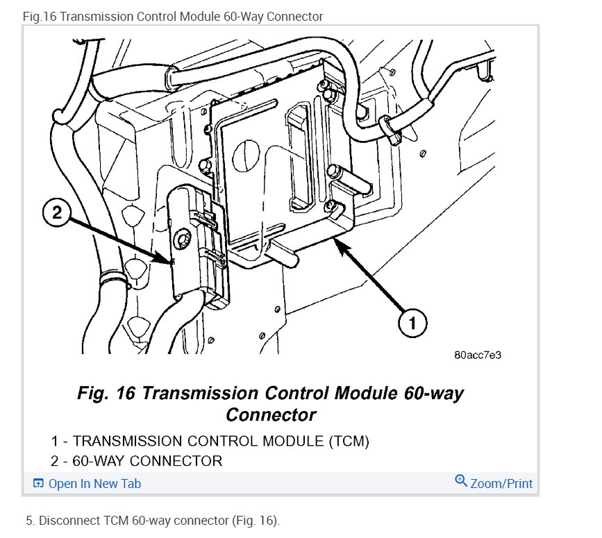

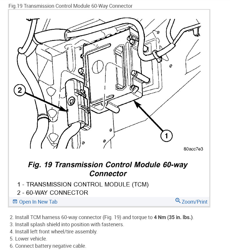

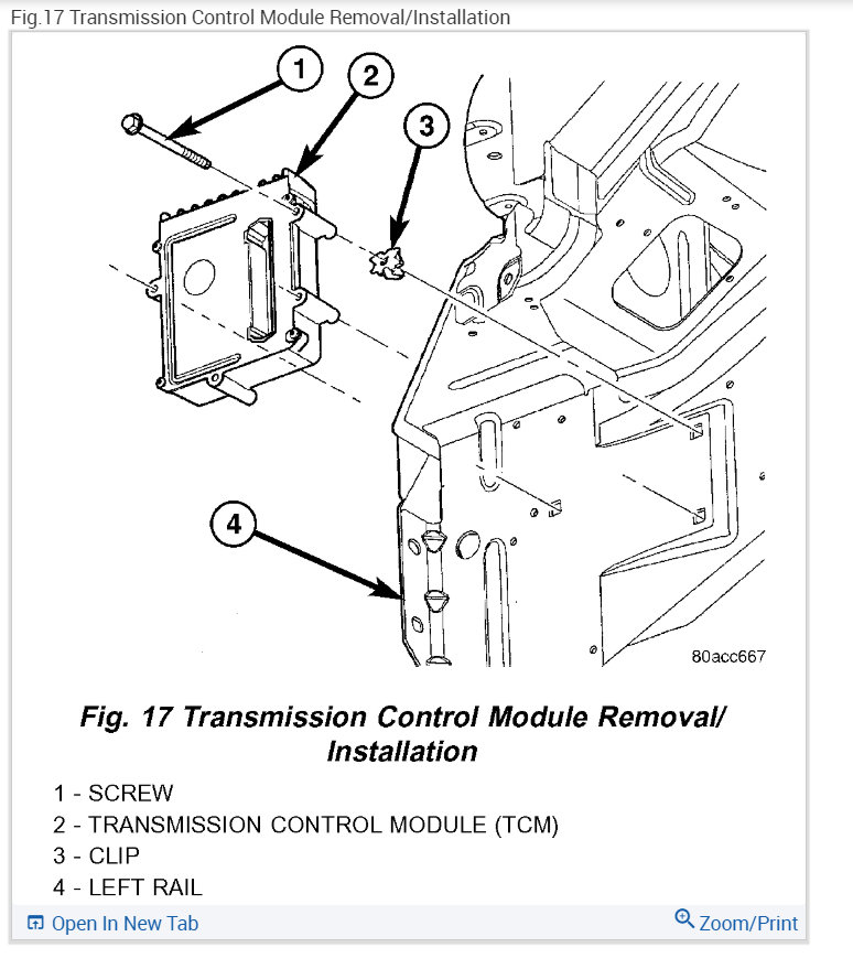

Thank you for your response and all help and information w/diagrams. After i sent you my question i took my van in (limp mode) i guess its called to AutoZone he was able to retrieve codes PO700 and PO605 read only memory failed self test. is my TCM going to need replacement/to be rebuilt? I did a little recon on it 3 places and priced $130.00, $169.00, $199.00, $249.00 plug and play 1 year warranty except 1 14 day return bla bla. Man i am getting all turned around in all this. any suggestion/recommendations?input greatly appreciated and thanks for your time.

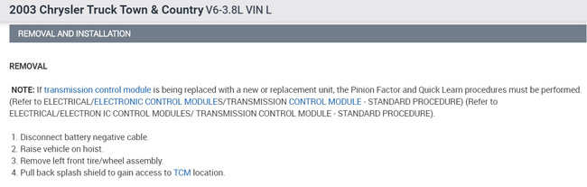

  • 55,381 POSTS
They do have issues with the TCM on these because of the location. Here is how you replace the unit. Check out the diagrams (below). Please let us know what you find.
