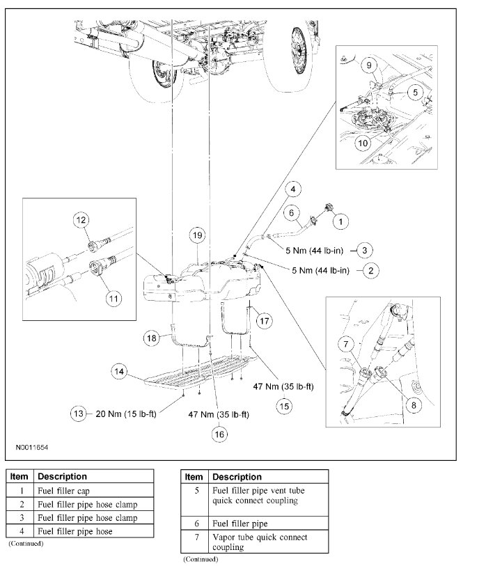

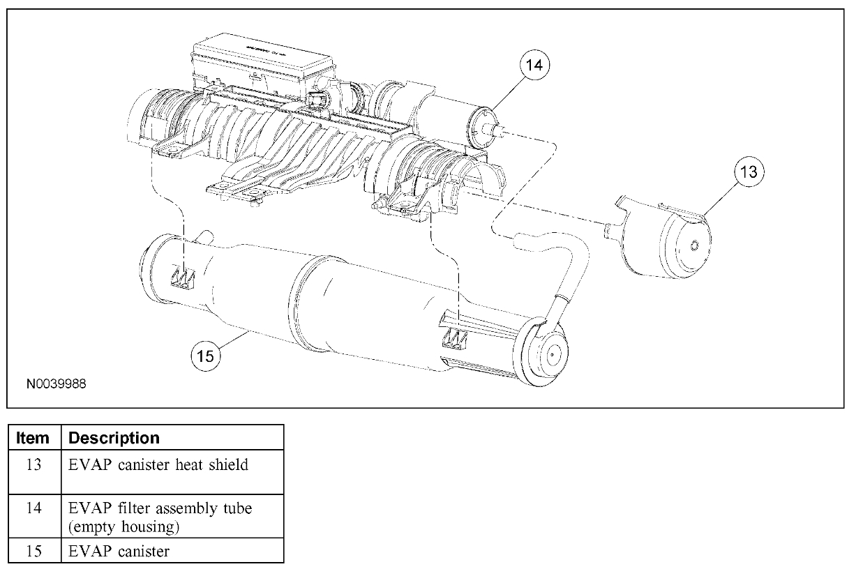

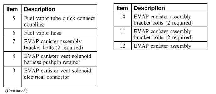

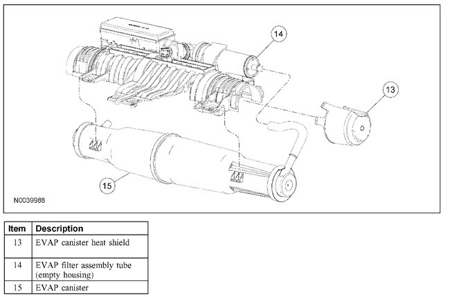

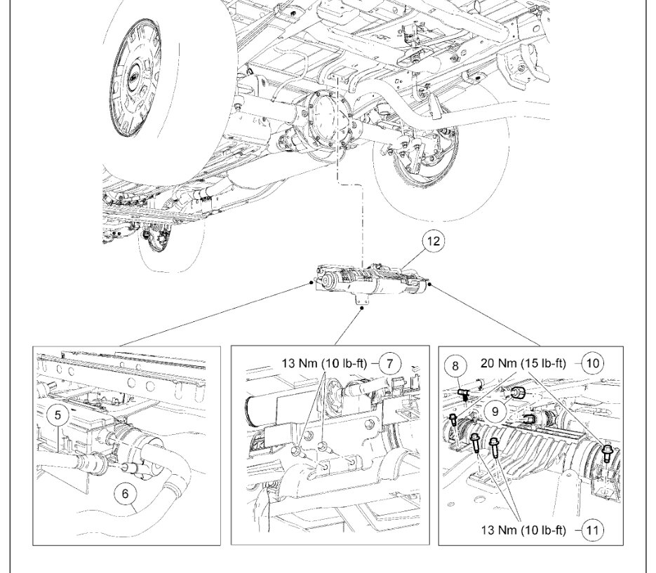

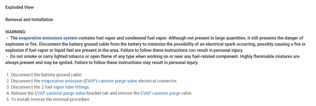

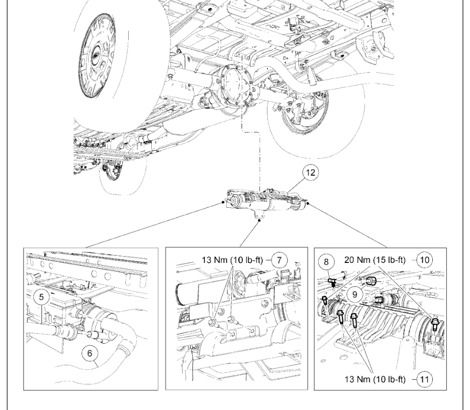

It looks like you have fixed the cranking problem. thanks for the video, it was good. Please check the O ring seal on the gas cap, it must be in good shape. If so, you may have an EVAP vent line that has come off or the hose is no good.
Check Fuel Cap Indicator
Note: The check fuel cap indicator on the Hanger is a dedicated output signal that is controlled by the PCM.
The check fuel cap indicator is a communications network message sent by the PCM. The PCM sends the message to illuminate the lamp when the strategy determines that there is a failure in the vapor management system due to the fuel filler cap not being sealed correctly. This would be detected by the inability to pull vacuum in the fuel tank, after a fueling event.
Check out the images (below). Please let us know how it goes

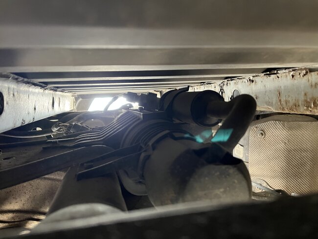

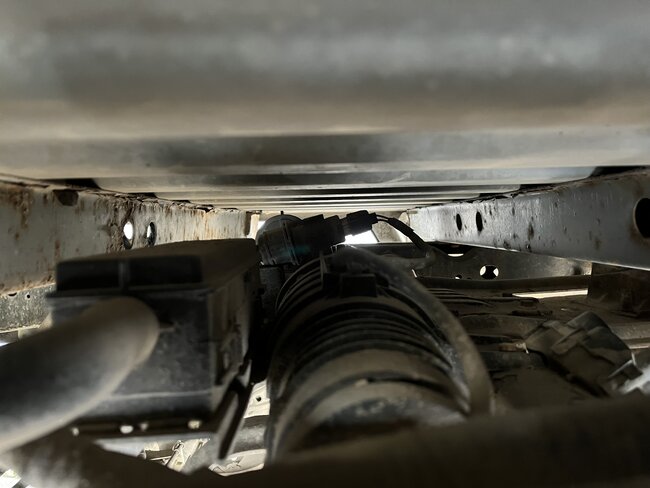

but it turned out that the problem is not in it. After starting the engine, the display continues to say (Check Fuel Cap). I am not clear from here on the father which part to check and replace. You mention a disconnected breather or a bad hose but where to put them I'm looking to check? It made me think that above the spare tire next to the beam, when I squatted down next to the rear tire (regardless of which of the two) and looked ahead, I saw a socket that still seems to me to be not fastened well. And yet I don't know if This is the way it should be.

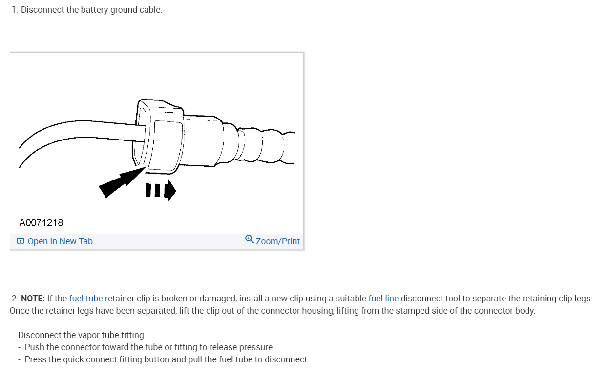

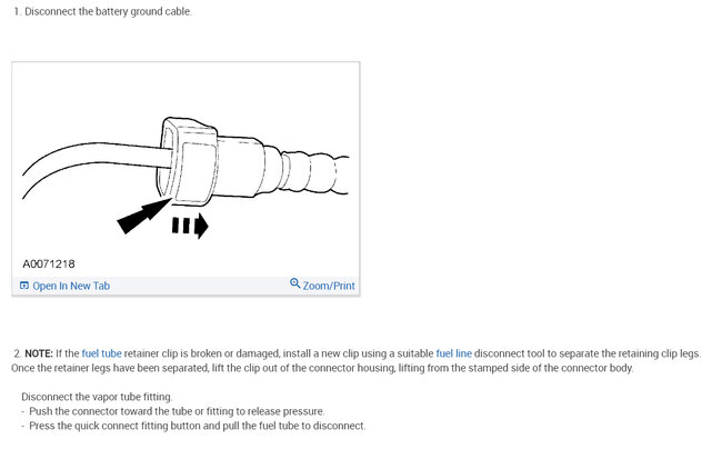

Thanks for the images. it is difficult to tell what you are talking about, but I can tell you the EVAP system can have no leaks. So, if you see a hose not seated, I would reattach it and use the video above to clear the codes.

So, I found the problem, a broken hose for the vapors, I replaced it, but in order to clear this error from the car's computer (Check Fuel Cap), the battery terminals must be disconnected for at least ten minutes.
