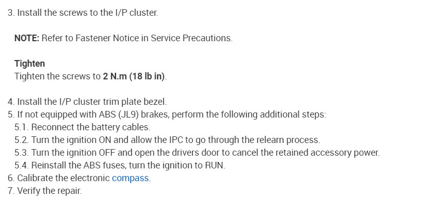

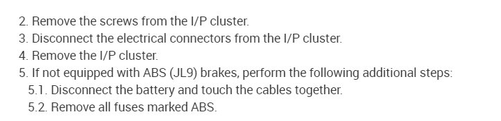

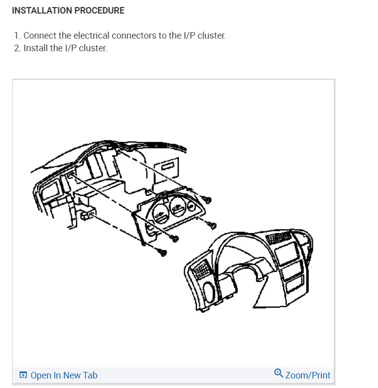

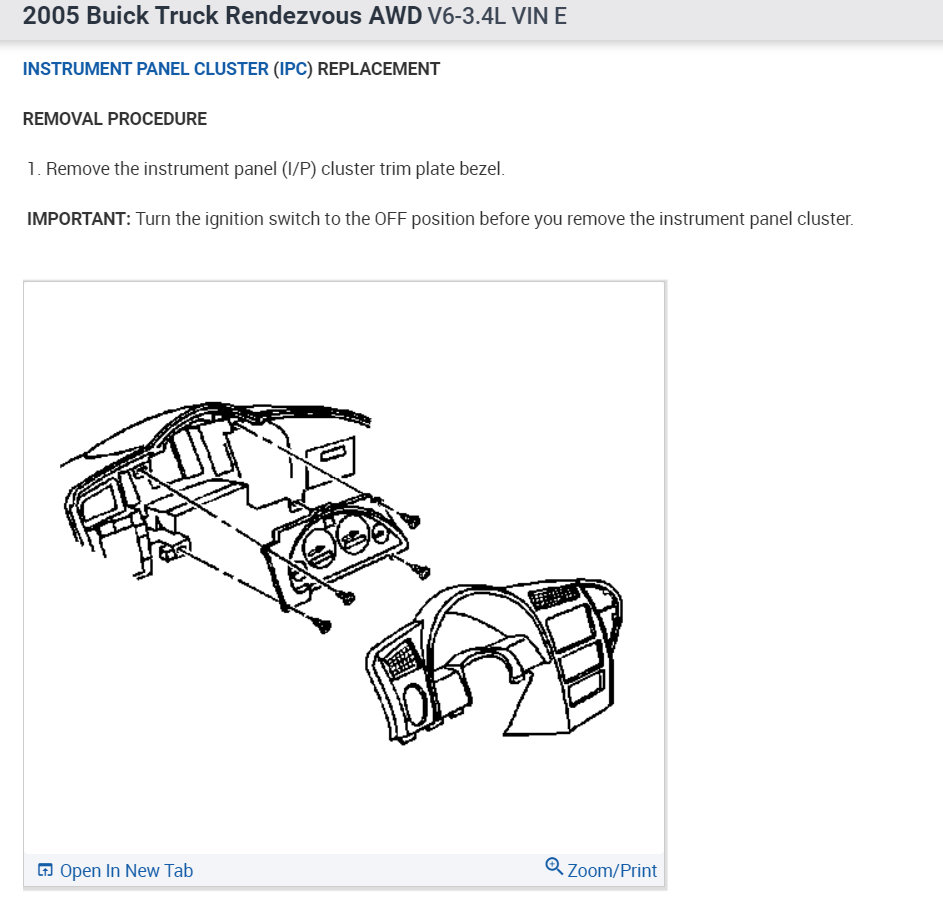

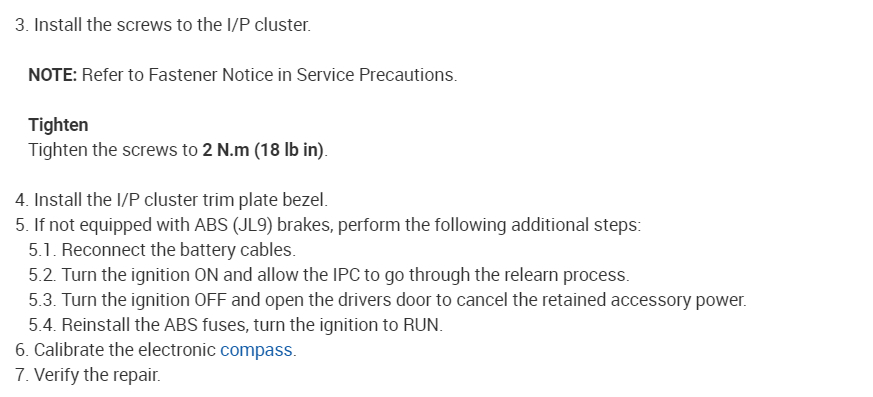

Here is how to change the cluster out in the diagrams below. Check out the diagrams (below). Please let us know what happens.
