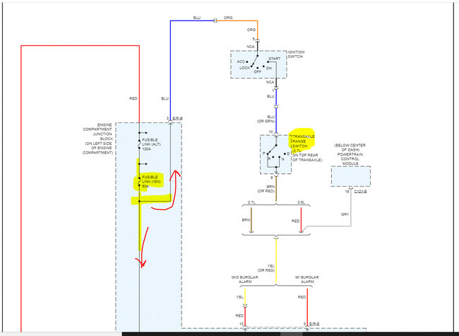

I drove my car to take my mother-in-law home. I got home shut off the car didn't go anywhere for 4 days. went to start my car it started, but when i put my foot on the gas my SUV shut off and it won't start back up. waited 8 days later and it started i took it for a test drive but couldn't go any faster than 40 MPH. turned around, came back home and shut it off, unhooked the battery for 24 hours and then hooked it back up, and no it won't start; it only clicked one time and then nothing. Now put the key in, and it doesn't click or do anything, and the lights go out when the key is turned over but not to start it. Can you please help?

Battery is good alternator is good. what else could it be?

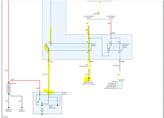

If the battery terminals are tight and clean and the battery is charged, we need to see if the starter is getting power or not. If no power, we have a wiring/power issue, if it is getting power and not working, the starter is likely bad.

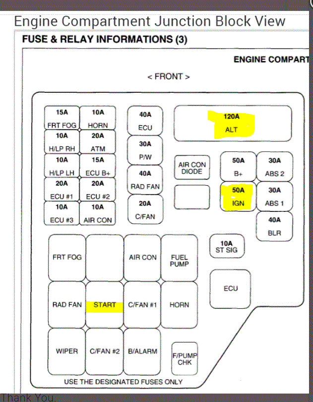

First, I attached the wiring schematic below for the charging system. If you look at pic 1, I highlighted two things. First, the park/neutral switch. As a test, see if the vehicle starts in neutral. If it doesn't, go to the under-hood fuse box. In pic 1, I highlighted the ignition fusible link. Pic 3 shows the location of the link in the fuse box. I need you to check if it's good. In addition, confirm there is power to and from it. Here is a link you may find helpful:
If you have power and it's good, then we need to check the starter relay. I highlighted it in pic 3 also. If there is another relay with the same part number, switch them to see if it makes a difference. If there isn't, here is a link explaining how to test a relay:

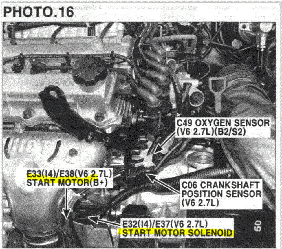

If the relay checks good and all power supplies are good, then locate the starter solenoid. See pic 4. On the starter, there will be a heavy gauge red wire. It is straight from the battery and has 12v at all times. Additionally, there will be a black wire with a yellow tracer which is a smaller wire. That is the trigger wire. It should only have 12v when the key is in the start position. Have a helper turn the key to the start position while you check that wire for power. If there is power, the starter is likely bad.
Let me know what you find or if you have questions.
