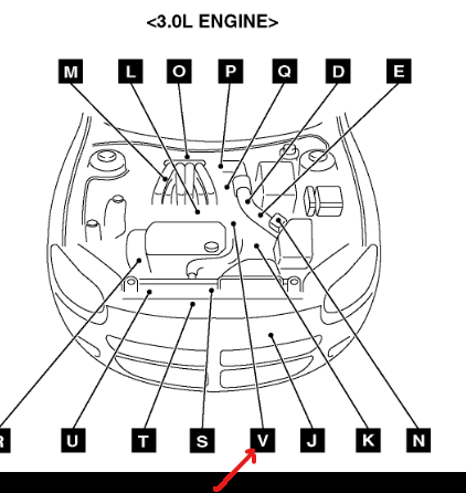

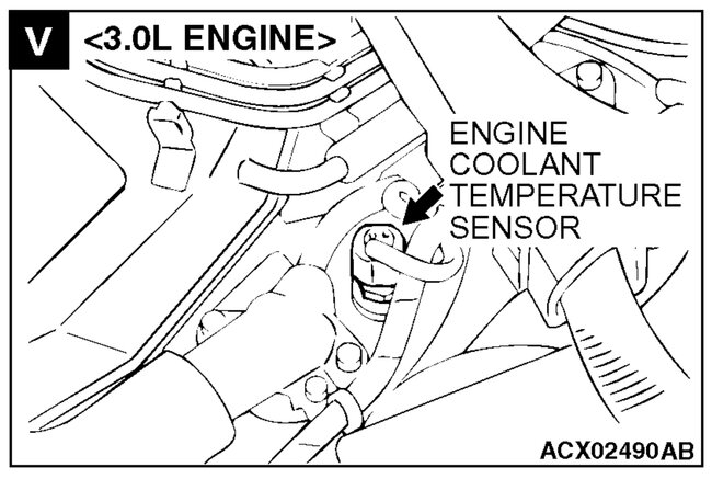

I have seen the engine coolant temperature sensor go out and cause this problem, but we should scan the PCM for codes to see what it says.
This guide can help:
Here is the location of the coolant temperature sensor in case a code comes up for it. Check out the images (below). Please let us know how it goes.
