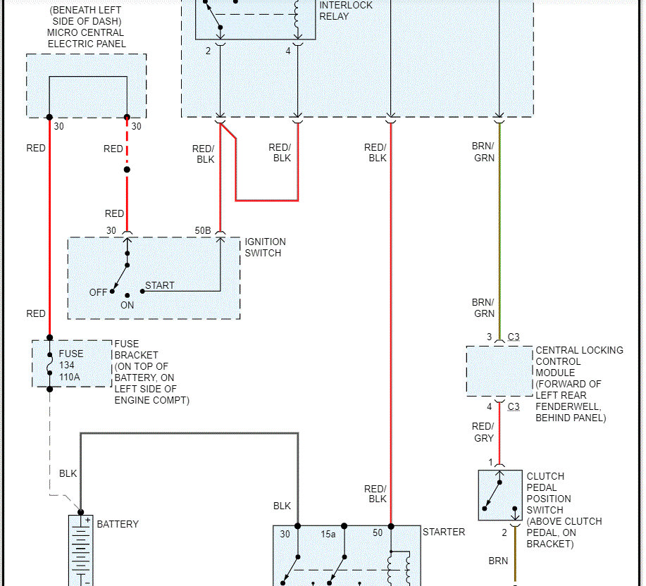

Will not start after a wrench touched the positive and negative terminal on my battery while it was running
2001 AUDI TT
94,000 MILES • 1.8L • 5 CYL • TURBO • 2WD • MANUAL
JAMIE LINN
is there a reset or something or am I bumming?
May 19, 2020 at 1:05 PM
  • 110,244 POSTS
Are other electrical components working? Also, is the starter engaging and turning the engine or has that stopped working?
Do me a favor. There is a fuse near the battery fuse box. I attached a picture below identifying it. Check to make sure it didn't blow.
