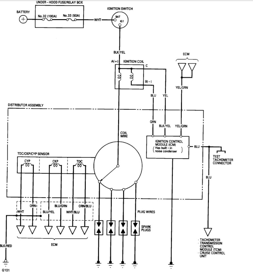

Wont star no spark at the cable wire and no 12v reference on the main yellow an green wire no 12v signal

It sounds like you have short or a blown fuse, here are a couple of guides that can help you find the problem.
and
Here is a wiring diagram so you can see what to test.
Image (Click to enlarge)
