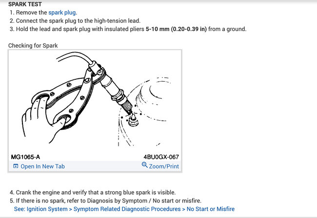

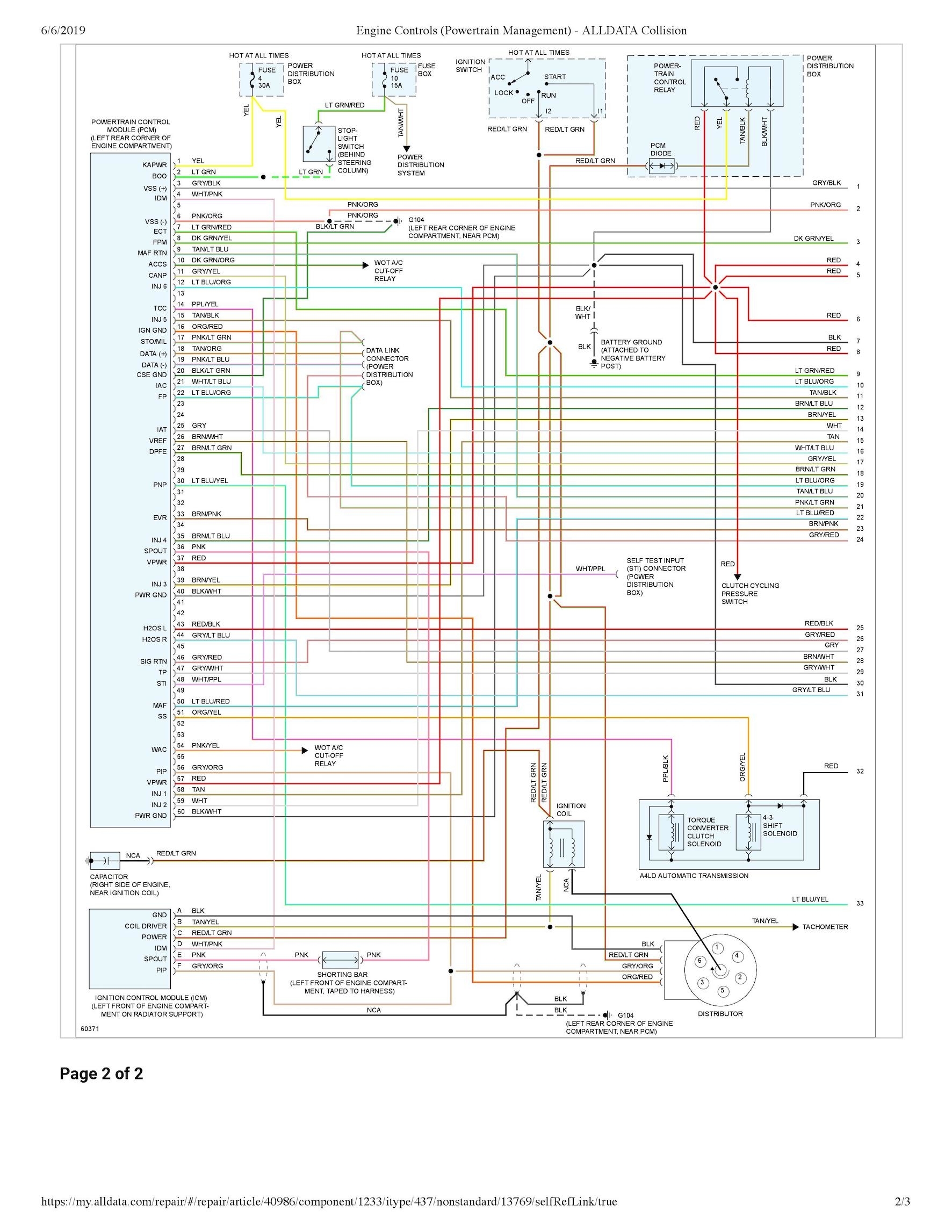

the truck was running fine, until i was driving one day made a turn gave it gas and it just shut off. i replaced the fuel pump and that didn't fix it. then i checked for spark and no spark. replaced coil and it still wont start. What do you think it might be? What should i check now?

Hey ANDREW LLOYD,

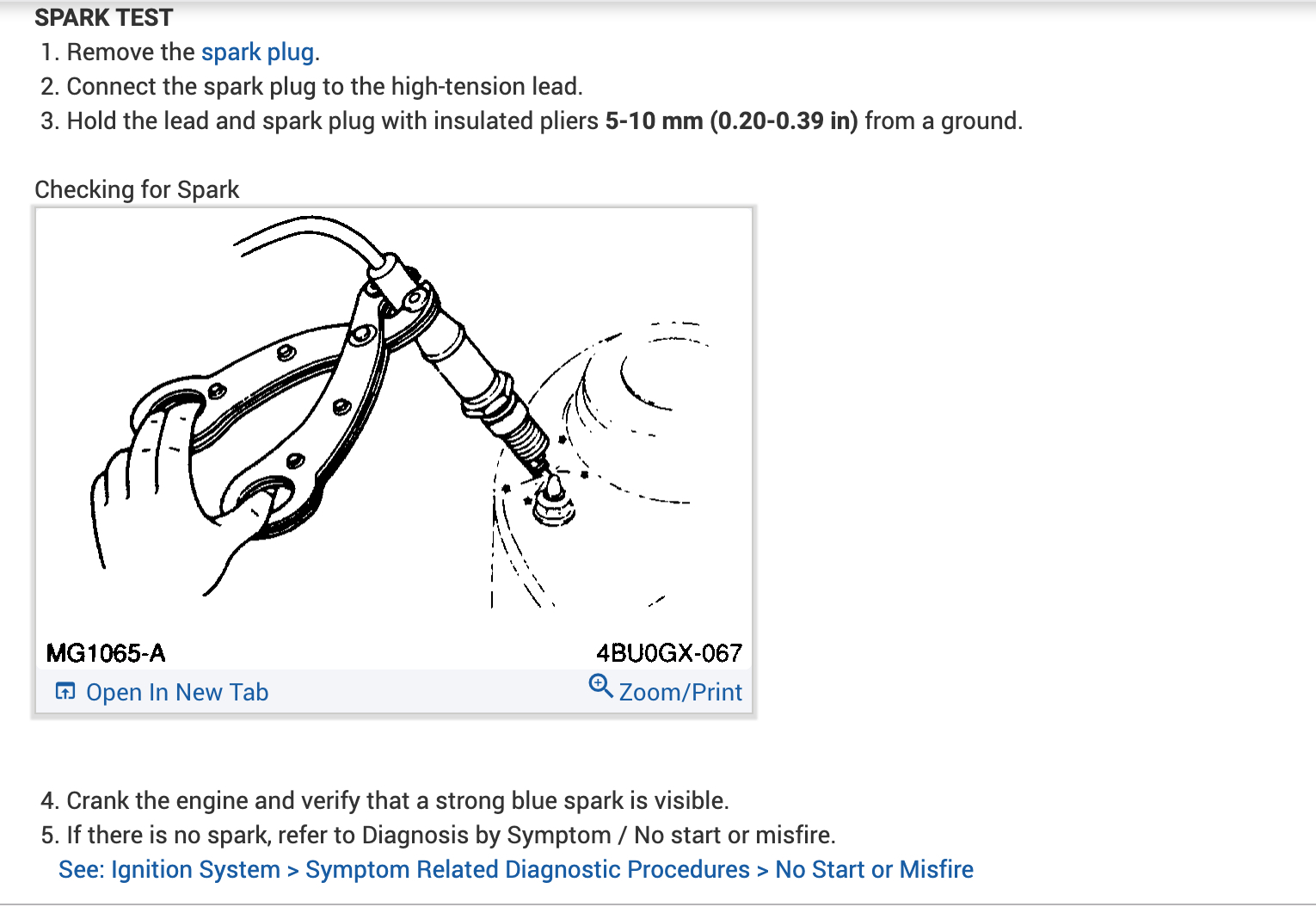

Just to be sure i have attached the process for checking for spark below.
If you have verified that you have no spark there are few things to try, starting with checking fuses.
I will run you through fuses and points to check for battery voltage below.
This system has a separate ignition control module as well as the ignition coil and the PCM.
Regards, Joe

I have already checked for spark.
What do I need to check next?

Hey Andrew Lloyd,

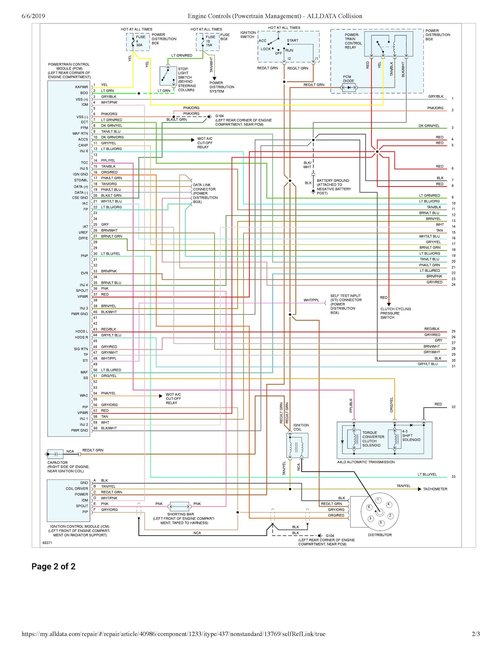

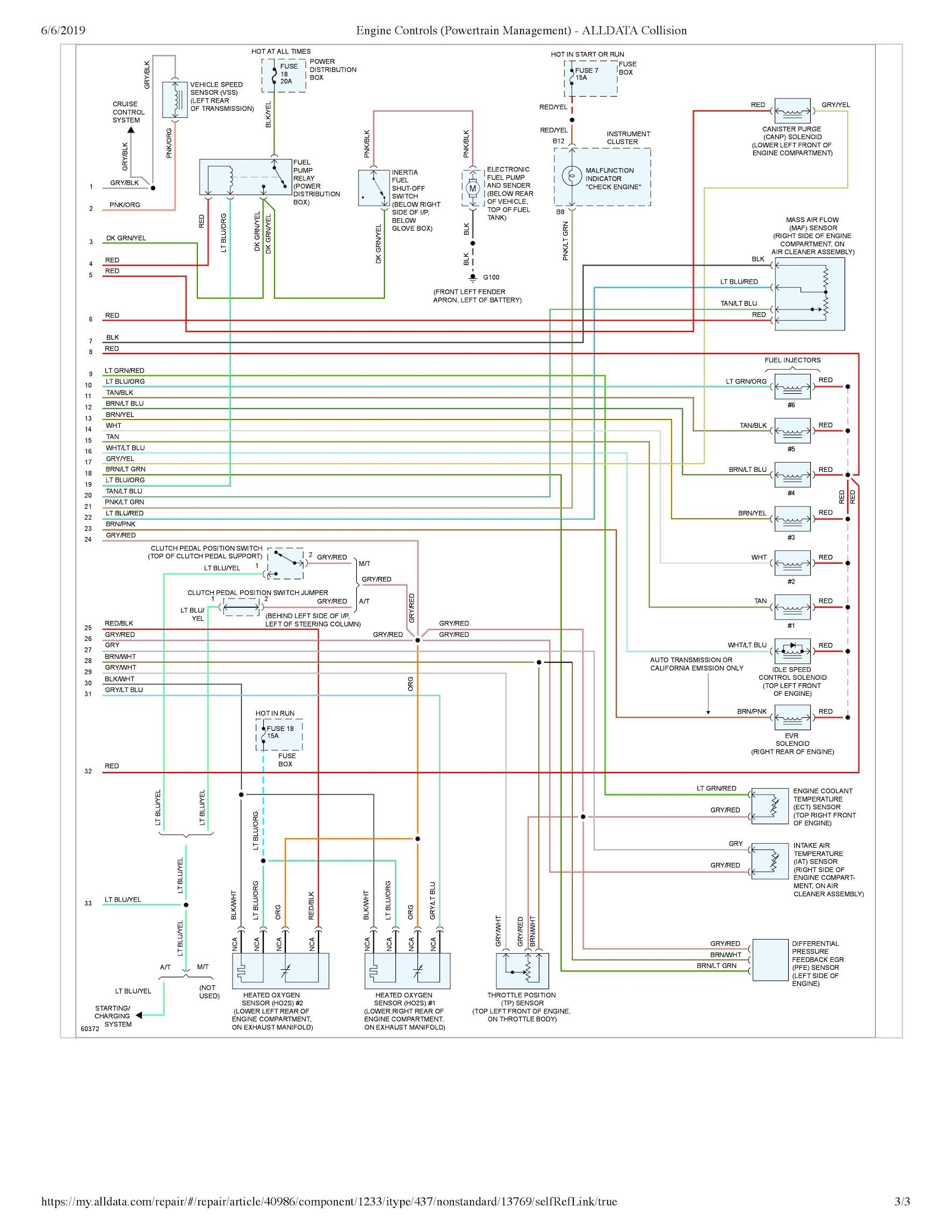

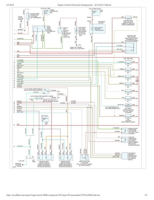

I have attached the engine controls wiring diagram below.
Things to check first would be that fuse 4 (30A) in the under hood fuse box is in tact and has 12V at both sides.
I would also check all other fuses in the under hood fuse board as a precaution while you're there.
Guide to check fuse below:
https://my.alldata.com/repair/#/repair/article/40986/component/323/itype/32/nonstandard//selfRefLink/true
Also check battery connections and engine ground wires to ensure nothing is loose.
If this is okay the next thing i would do is to remove the distributor cap and check the condition of the cap and rotor contacts. Make sure the rotor is seated correctly and the cap is fitted correctly.
Check the connections of all of the plug wires and the lead from the ignition control module to the center of the distributor.
Check connections on the Ignition control module (ICM) and Power train control module (PCM).
The ICM is mounted to the to the radiator support, left front of engine compartment.
PCM left rear corner of engine compartment.
If all connections appear okay and you have power at the fuse you will need to check for voltage at the ignition coil and at the ICM.
Do you have access to a multi-meter or test light?
Regards, Joe

yes i do. could it be the crank position sensor? but i will check these other items first and will let you know.
Jun 6, 2019 at 2:55 AM
ANDREW LLOYD
it was the rotor on the distributor, it came apart. going to change both rotor and cap. thanks for all the help!

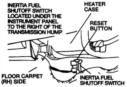

The battery in my truck was dead for a couple of months. It was running fine befor I let the battery die. I just put in a new battery and it won't start. I don't think it is getting any fuel. I've read there is a reset button for the fuel pump. If there is where is it and do you think this is the problem. It turns over fine but dose not start. Thanks Mark...
Jun 8, 2019 at 9:12 AM (Merged)
  • 75,988 POSTS
https://images.2carpros.com/forum/automotive_pictures/12900_ifs_1.jpg
If not-Lets do below for a start to determine if its fuel or spark related issue and get back asap. Get a helper disconnect a sparkplug wire or 2 and ground it to the engine atleast 3/16 away from ground-have helper crank engine over-do you have a snapping blue spark? If so-you have a fuel related problem, check the fuel pressure to rule out the fuel filter/fuel pump/pressure regulator and listen to the injector/s are they pulsing or hook up a noid light. No snapping blue spark continue to troubleshoot the ignition system-power input to the coil/coil packs,coil's resistances,distributor pick-up coil, ignition control module, cam and crank sensors and computer Note: If it doesn't apply disregard it
